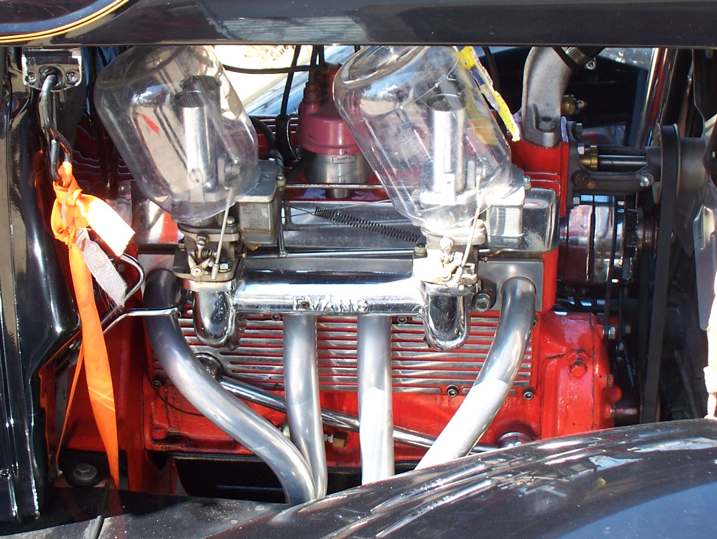

Plastic bottles over the Scott tops to keep dust out until I can find air cleaners to fit Evans manifold. Ceramic coated custom header hooks up to a 3" tube which runs straight to the rear of the car. Pull cable type cutout valve in the end of the tube, with a 1' exhaust pipe to keep it quiet in town. No muffler. Too much back pressure with the cutout closed, so I run it open and just go easy on the throttle in town. So far no noise tickets.
