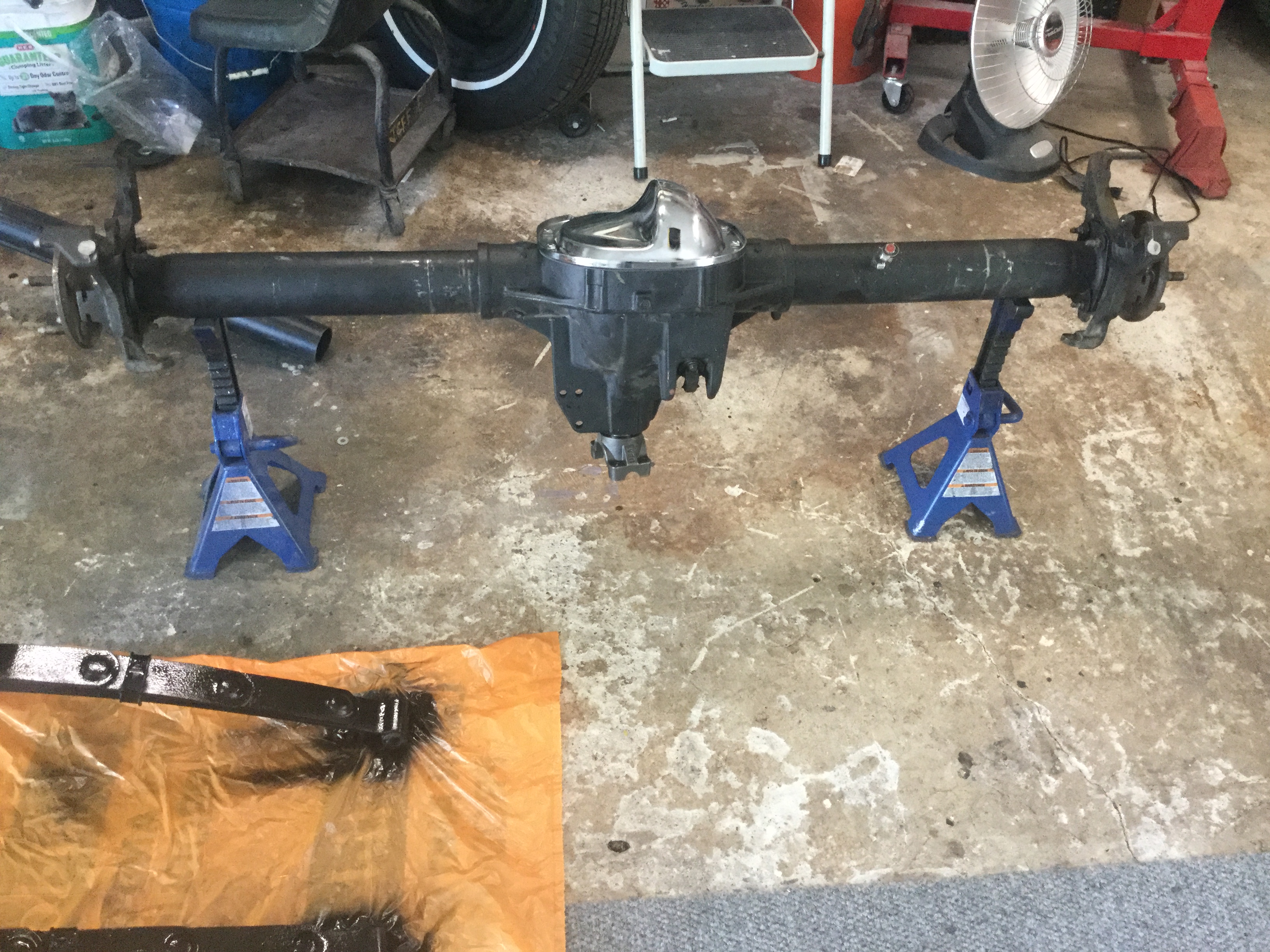

      Narrowed ford 8.8 out of a 99 Explorer. New bearings, ford Motorsport posi unit, new ring and pinion and swapped the yoke flange for a Strange engineering’s pinion yoke. Just have to set up the spring perches and brake lines, install the calipers and put her in.
