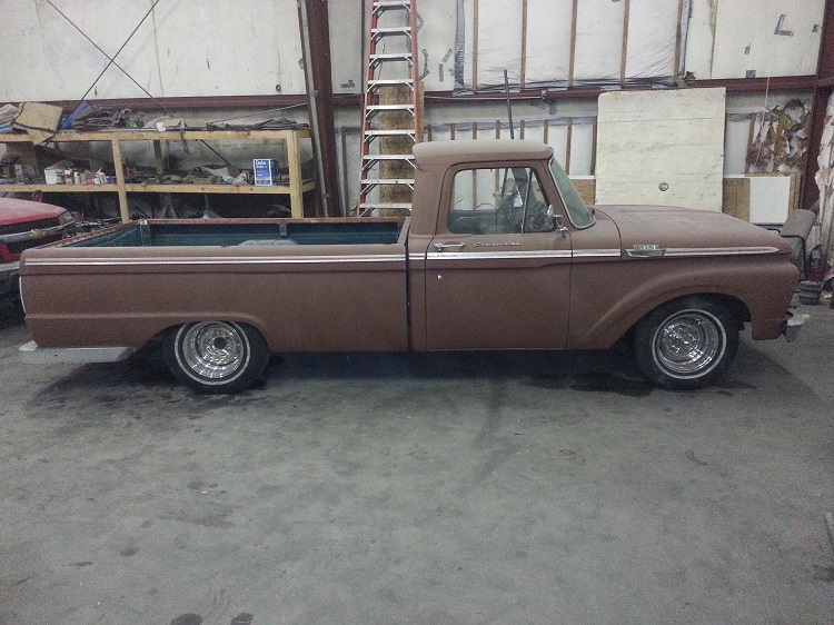

3" axle thanks to Sid. Rear axle flip. 15x8 with 2.75" backspacing in the rear, 15x7 with 2.75" backspacing in the front. 235/75-15 all the way around.
