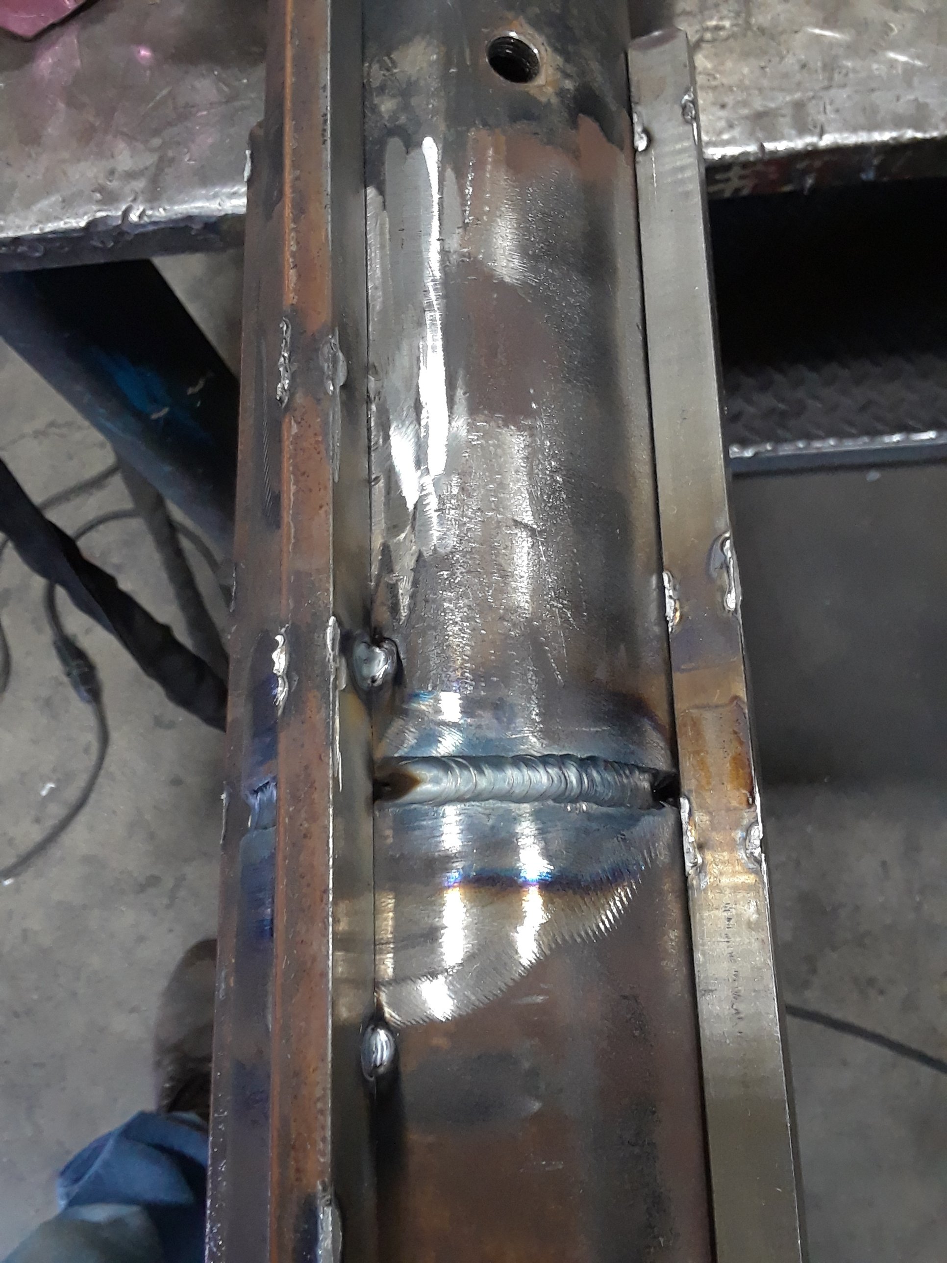

      Root welds in between the braces. Axle tube was sleeved to help with alignment and strength. It also made a great backing for the weld. Left an eighth inch root opening and also beveled the two tubes. When TIG welded back together, I made sure to tie in both walls and the backing sleeve. After welds were rooted between the braces, the welds were cold and then braces removed. Welding continued in the areas under the braces, then the cap weld was done. I checked after grinding and dressing the tube and zero movement of the tube after welding.
