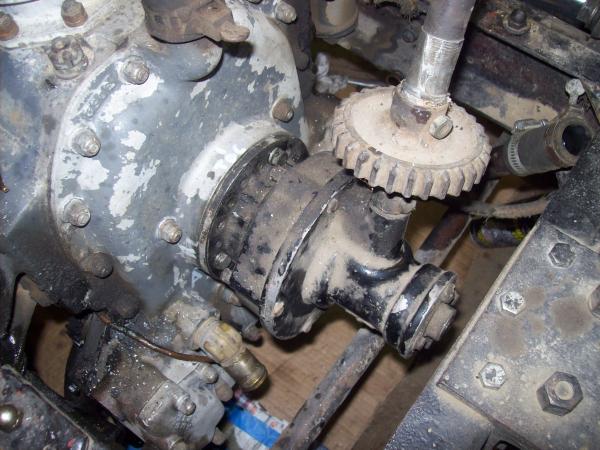

hand crank. This starter is 5:1 ~ five turns of the crank to one turn of the motor so you can really sneak up on stuff.

This is a hand starter. This is an invaluable tool for setting up the engine. For example, adjusting the valves, setting the cam timing and mag timing. I don't know if something like this would be attainable, but it's worth looking for.

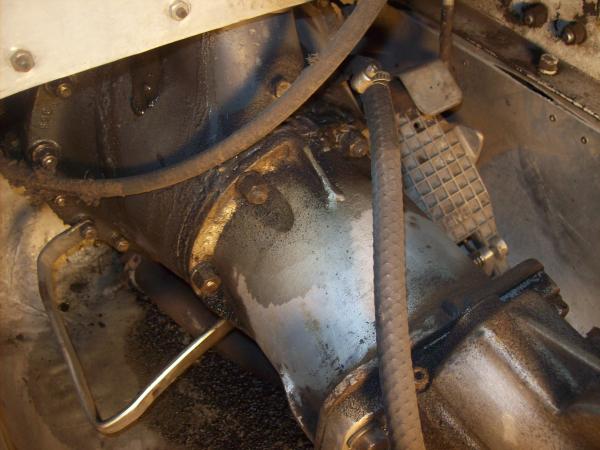

I/O box

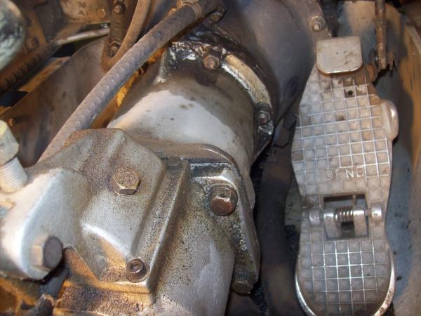

adapter for I/O box made from tubing mounted to front of engine in plane (back of engine in car). Just thought I would show how Gene did I/O box ~ just some ideas.

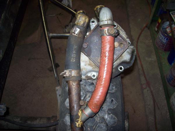

Scavenger pump oil out
