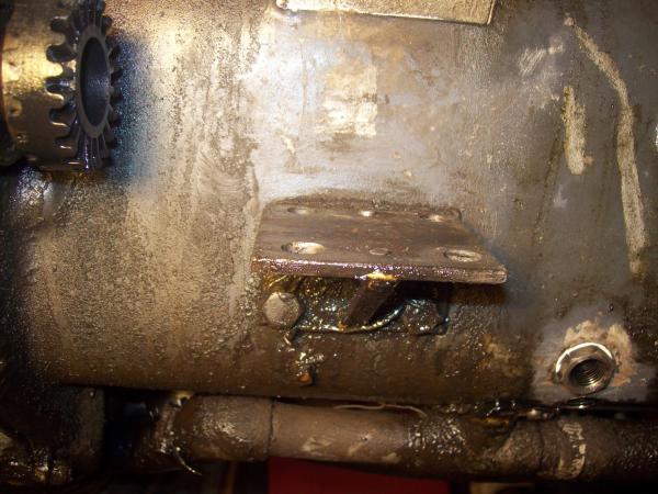

Magneto mount. You can see where the originals were sawed off the crank case.

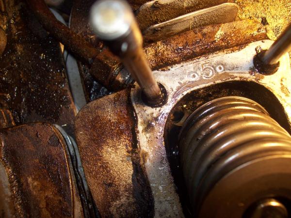

This is hole in pocket under valve spring. See the hole? This is the drain.

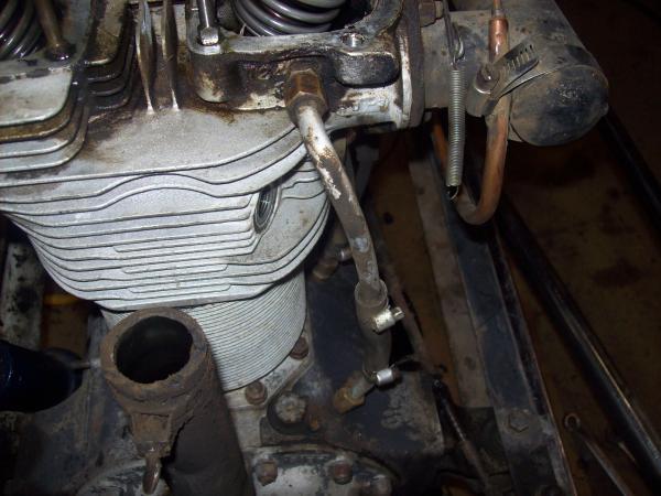

Intake valve drain line

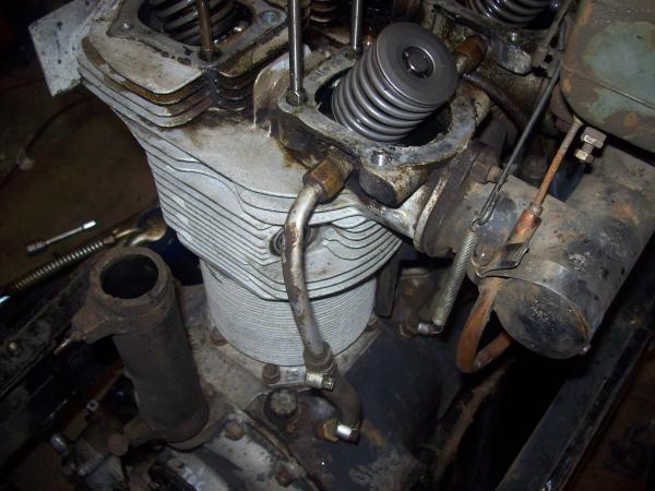

Intake valve drain line (2)

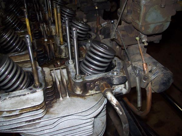

Intake valve drain line (3)
