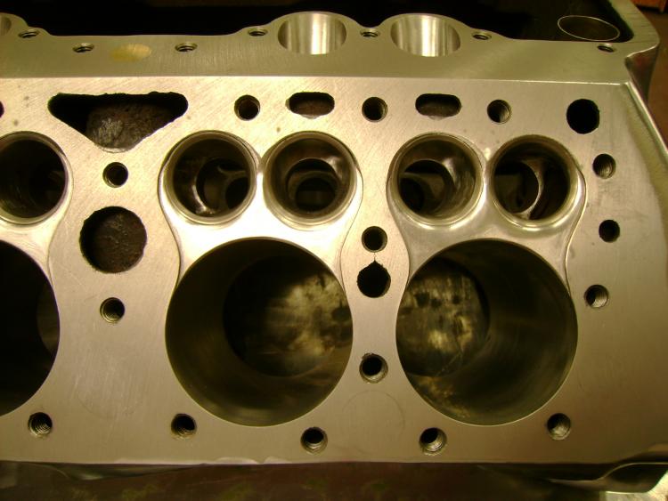

Barely visible are the surface shapes of the deck relief they vary in depth and angle about 2.5-degrees from the intake to the exhaust side. Also visible are the custom coolant passage plugs made by Evans Speed Equipment. Originally they were crude steel plugs but now they add structural integrity to the deck also. The machine work was all handled by Evans and the valve job by Slovers.
