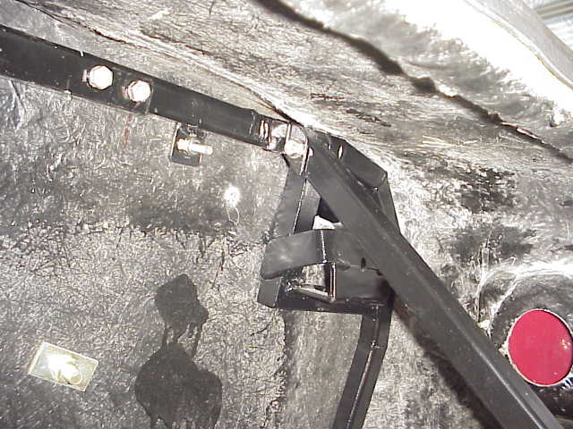

Boot frame complete RH, with finished inertia reel belt cage. NOTE! the plate and threaded fitting in the lower left of this pic is the previous upper seat harness mounting - the harness was just bolted into the thin 'glass rear wall and would have just torn out in an accident.
