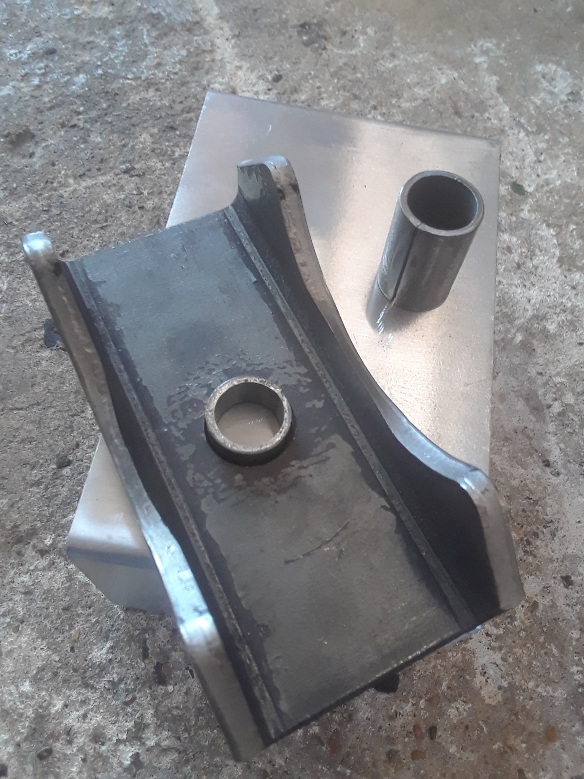

      Spring perch after I made the sleeve. Found a tension pin sleeve at the hardware store. Made the slit in the side larger with a cutoff wheel. Tapped it into the hole in the perch and Bobs your uncle....perfect spacer
