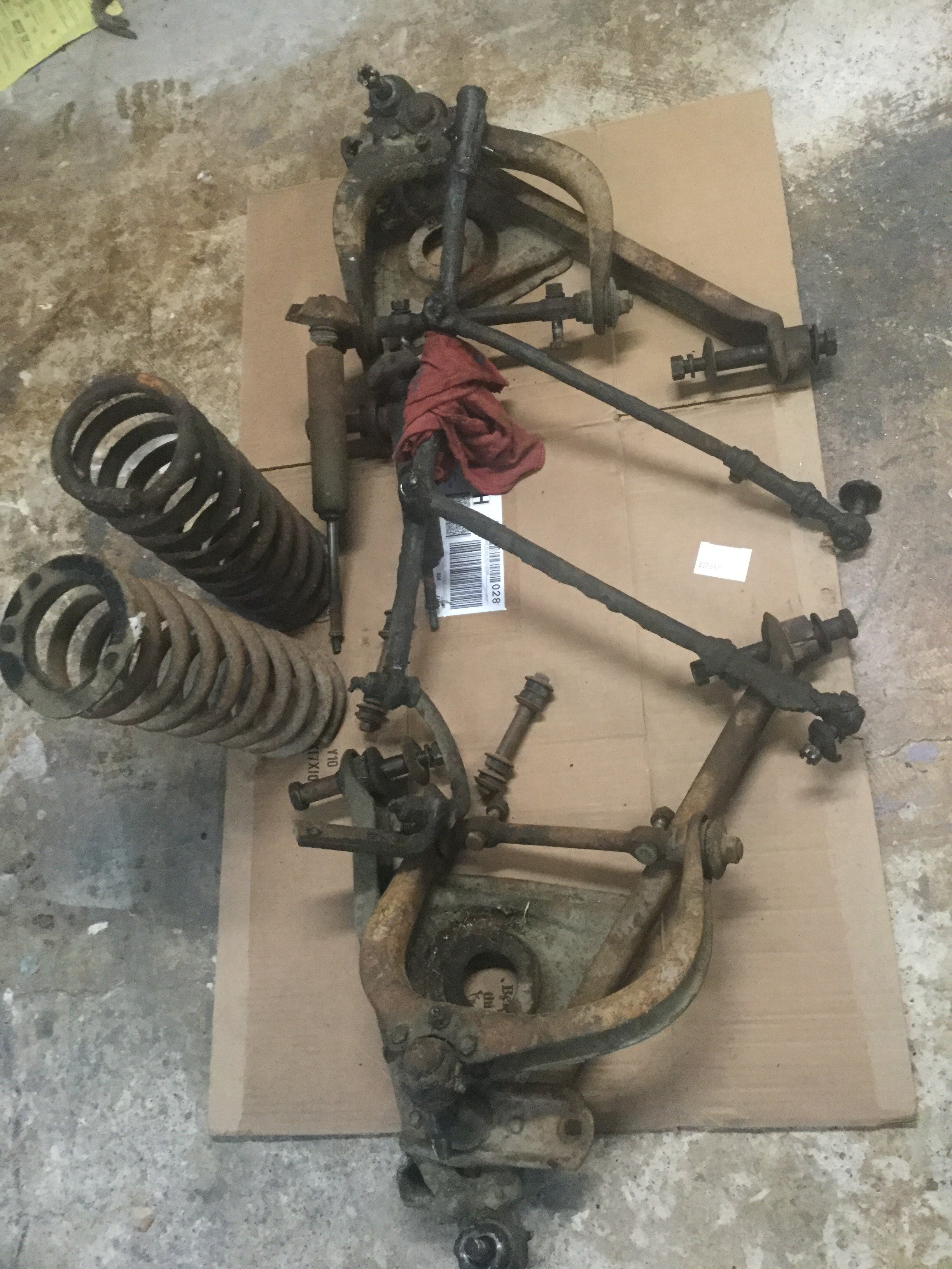

      Ready to take to work and soak in the parts washer, then remove all the bushings, wire wheel all the bolts, chance the threads with a die, repaint, press in the new bushings, and install the new ball joints, etc....then back in the car.
    54 customline
