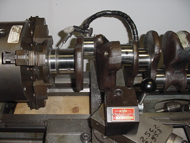

      Here's the crank for my little straight 6 - improper storage (before I got it) left the rear main seal surface pitted with rust. I machined off .009" and will polish off another .001" to pretty it up a little.
