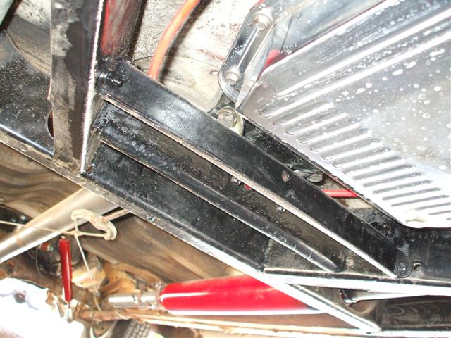

      AOD is sitting on stock '54 crossmember the drive shaft is from a 1986 Crown Victoria with a NEAPCO 2-0291 Conversion rear U-joint bolted to the stock 4:10 ratio '54 rear end. The mount used is the ANCHOR 2253
