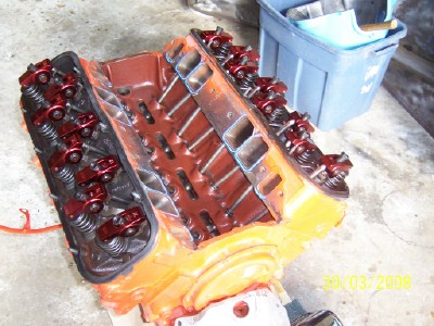

Engine 9 Valve train with roller rockers. The heads are rectangular port Hi-Perf cast iron heads. There has been alot of porting work done on the intake and exhaust sides. The intake is an Edelbrock Victor Jr that has also been ported to match the heads.
Engine 9
