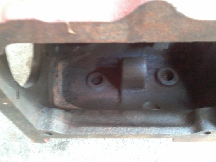

Inside the modified side shift case. Freeze plugs inserted to close off the shifter rod bores. Seems to work just fine, two of the three transmission cases that I bought in this top shift lot were modified in this way.
