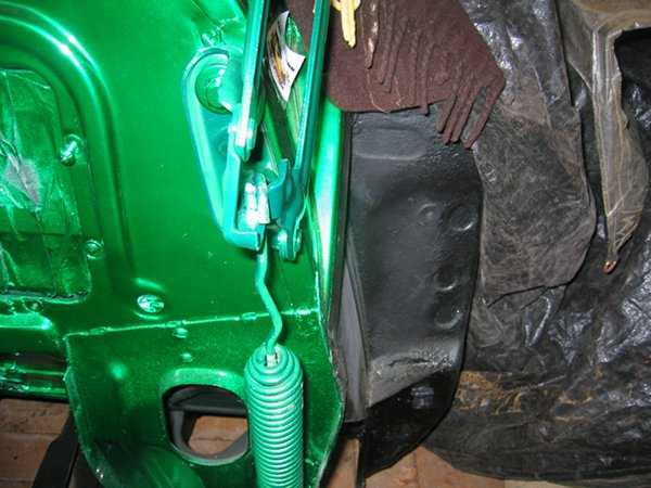

Tension spring on hood hinge
Make sure its on the correct side ...the wire is bent to clear the hinge
