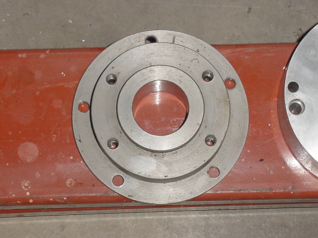

Multi use alignment hub. Outter flange is piloted on the 9" axle housing. Inner hub and pattern allows same fixture to be used to weld on axle flanges for narrowing a rear end.
