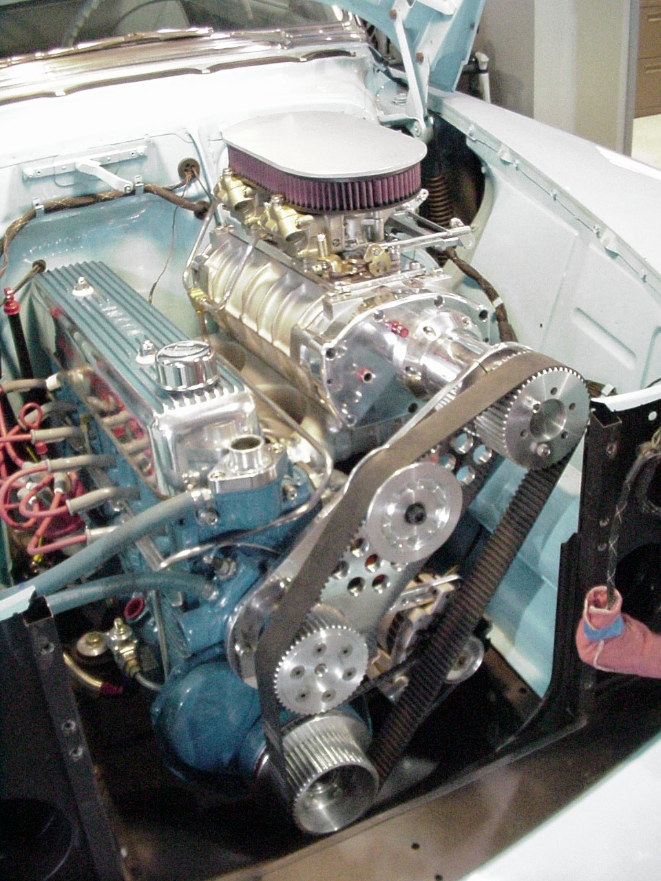

      Very nicely done...haven't see anyone do a blower set-up like this on a straight 6...Highest Marks Sir!
      I love to see something that isn't "Cookie Cutter" Hot Rod.
      nice FAB work on brackets

      Thanks for the kind words. It was a lot of fun to build and even funner to drive. Tons of torque!

      Who made the Blower Manifold for that?

      I fabricated it using an old Larrowe 2 piece blower intake that was originally intended for a mini blower. I welded it together to eliminate the bolt together deal, then cut the top off and welded on a larger mount plate, which I machined to match the 8V53 blower.

      Well the end result was well worth all of your time and effort!
      The fact that it looked like a "cast" manifold is only more credit to your FAB skills.
      Again, what a nice truck it turned out to be...a real "Camera Magnet" I'm sure.
