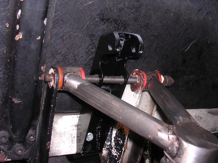

New bracket for the coilover top mount. The threaded rod is one of the two top pivots I found on the car and both were slightly bent. It was only in here while I was checking out the trajectory of the suspension and they were replaced with high tensile bolts on final assembly.
