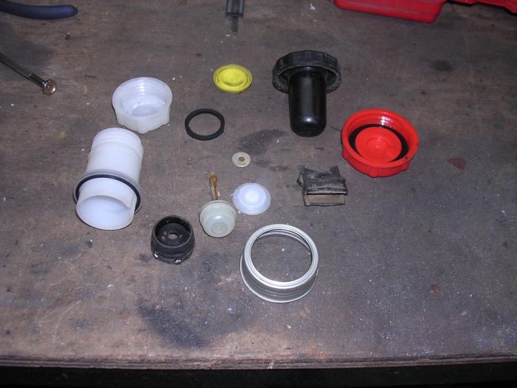

Now for the new brake master cylinder. I wanted a fluid level switch but could not obtain one for the new unit so decided to make one and used a Merlin Girling extension together with a Ford Sierra float. As the Merlin ring would not fit, I used a spare Girling cap. From the pile of bits seen here emerged a nice level switch.
