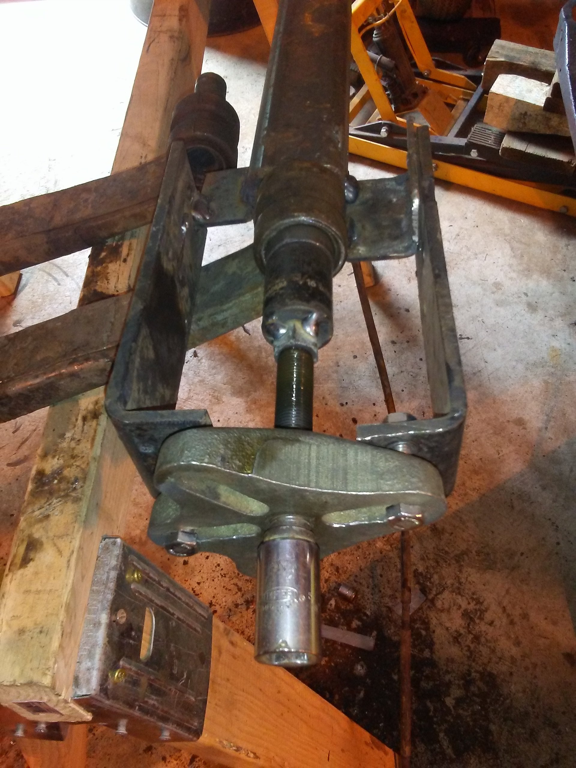

Front of the rear springs bushings are pressed in... I didn't have a press so I scrounged up an old puller and some scrap metal to make a press. Tacked an impact socket that was just slightly smaller than the bushing to the floating nut on the end of the screw and then a 2 X 2 piece of tubing to the ends of the side straps... hit it with the air wrench and it did the job. Needed three hands to hold it all in place until the new bushing started.
