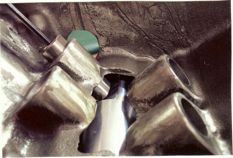

roller lifter setup cam blank I machined to simulate the base circle and the max lift, prior to having a cam ground to my specs
