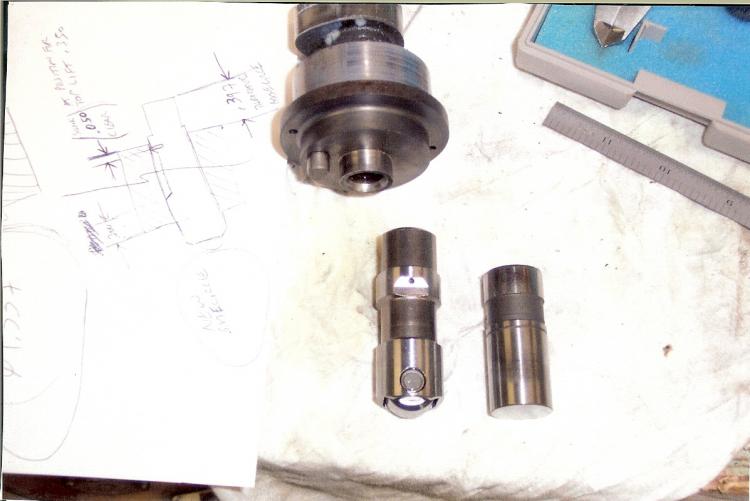

roller lifter setup to calculate what size bushings to install in the block, that will prevent oil hole from being exposed to the lifter valley
