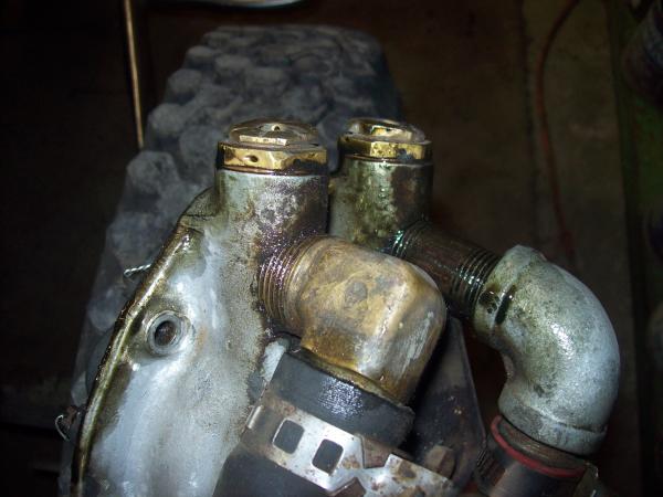

Scavenger pump ~ I know some guys used a different pump for the scavenging but if the aircraft pump is in good shape it seems to work just fine. The pump is a 3 gear arrangement having two suction sides. Gene tapped into the pump from the outside with these 2 fittings to utilize both sides. Kinda hard to see but when you get your pump in hand you will see what I mean.
