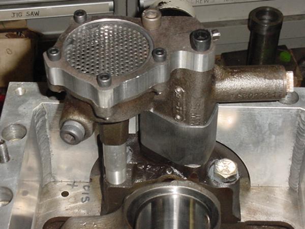

Screw heads insure minimum clearance to bottom of pan.
HemiRambler, Jan 23, 2009
    • HemiRambler
      I purposefully did NOT counterbore the screws - by leaving them "proud" they ensure proper clearance for the pickup to the bottom of the oil pan. The other idea here - is no chance for the pickup to come off - not shown yet but all the screws were safety wired
    Reworking a stock oil Pump for the digger
