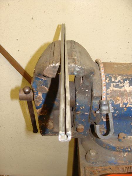

Spacer to fill gap from middle hinge up on the a-post. When the doors are flush fit, this gap widens. This spacer was made from 1/2 x 1/2 square tubing and split it with a 4" cut-off wheel.
