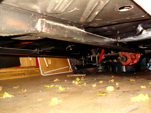

Sub-frame connectors tie the front & rear sub-frame rails together, this reduces flexing of the unit-body chassis during acceleration and braking. These connectors are made by Crites Restoration Parts and had to be welded in. http://critesperformanceparts.com/
