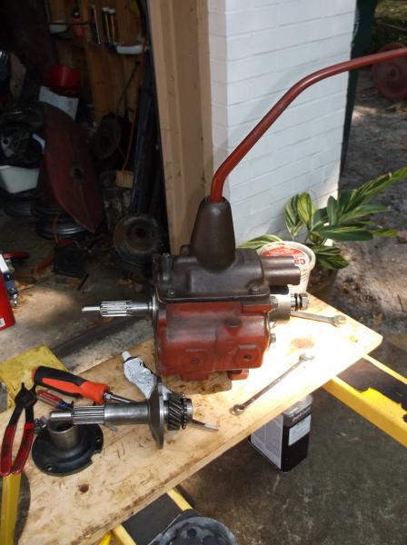

The rebuilt transmission internals installed in the modified case with a T-84 input shaft (note that it is shorter) to replace the stock Studebaker input shaft. Same case (less the side shift housings) as a T-84, same dimensions.
