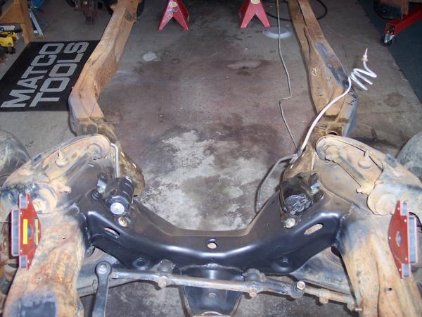

This frame is just under 3 inches too wide!

      We cut our frame at those cutouts, layed the body right on the frame,, then extended the frame 7 inches since all we had was a shortbed reg cab s10 chassis,, checkout the pics in the 41-46 chevy truck thread, I posted how we cut and lengthened it,, early 80's Dodge truck frame pieces are exactly the size you need to extend it should it come to that.
    • Haywood
      Thanks for the info! You're right we will need to add a little length to the chassis.
