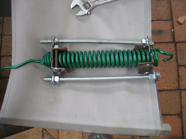

This is the spring spreader I made out of angle iron..and 5/8" all thread to stretch the spring out so it can be fitted on the spring points
