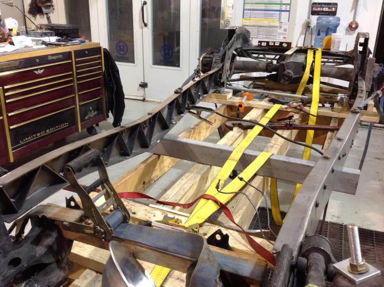

      With most of the components mocked in close, I started to stiffen the frame members and prepare to make final adjustments for wheel base, ride height, and suspension location and mounting points.
    • Shake n Bake
      Plan on going without finders and running boards to start with. As you can see, all the weld nuts are in, so I can add them later if I want a change.
      Right now I just want to get it rocking and rolling.
      My 385 series motor has been patiently waiting at the machine shop for at least 6 weeks now.
    • KEVIN NICHOLS
      Nice job stiffing the frame, i haven't seen it done that way before...(usualy just boxing in)
