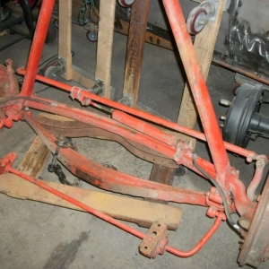

100 2551 Forty ford front axle mocked up under the buick roadster.

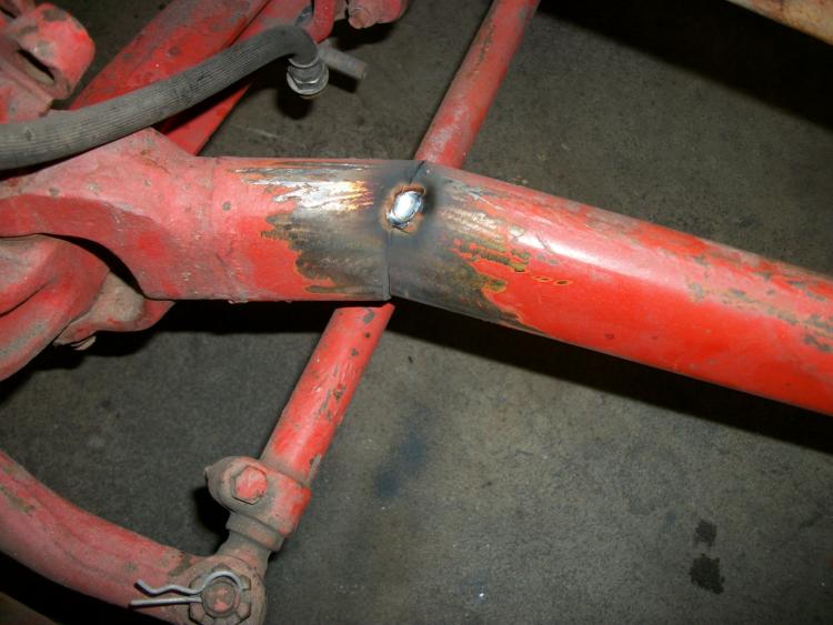

100 2552 Rather unconventional way of splitting the bones, but it works for me. They will be welded up solid. I took 3/16th of an inch in a wedge and bent them out to under the frame.

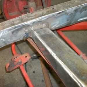

100 2527 Installed boxing plates.

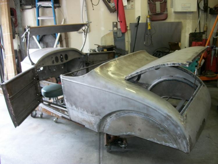

100 2264 I got the doors and trunk hinged finally.
