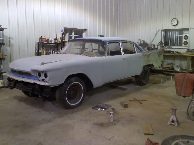

'59 Firedome
009comp

'59 Firedome
Working from front to back...

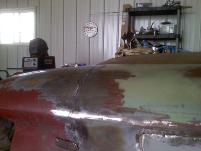

'59 Firedome
New "eyebrow" grafted on.

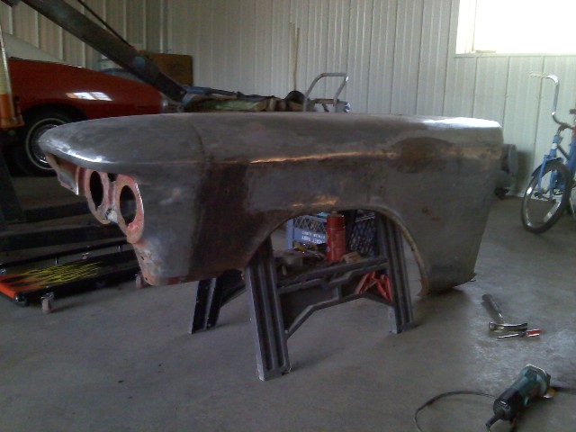

'59 Firedome
Donor frame being prepped for swap.

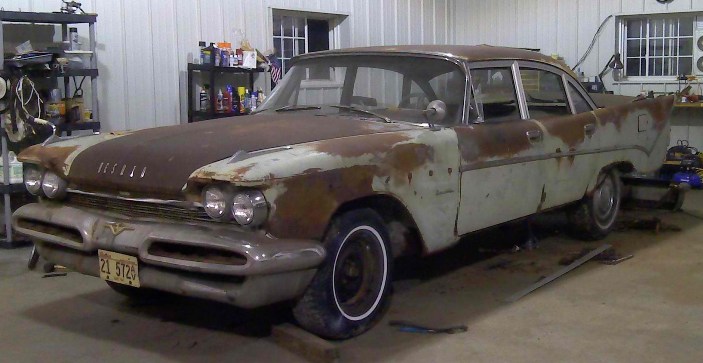

'59 Firedome
Before any sheet metal was fixed.

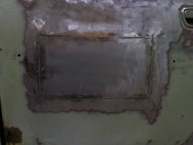

'59 Firedome
Welded in some new 18 ga. metal. Only problem is that the corners were pulled in on the original metal during welding. I skipped around and waited until I could put my hand on it to weld in the same area. Oh well, do and learn!
