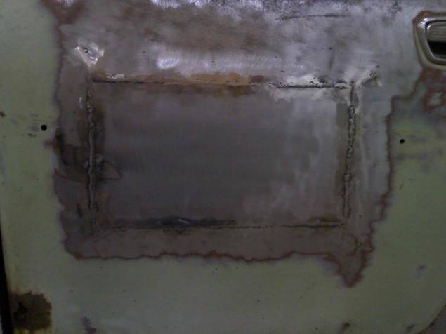

Welded in some new 18 ga. metal. Only problem is that the corners were pulled in on the original metal during welding. I skipped around and waited until I could put my hand on it to weld in the same area. Oh well, do and learn!
