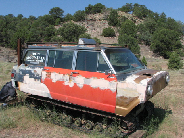

    It wouldn't take much encouragement from you readers for me to post more photos of the other junk we saw on our adventure. Here is the last roadside treasure that I must post. This Weasel-mounted Wagoneer was for sale outside of Salida, CO complete with its original Studebaker flathead.

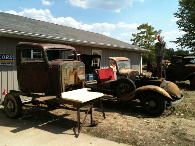

    Here are a few more treasures spotted on our road trip. I'll post these and then get back to the build. Maybe I'll post more roadtrip pictures if the build stalls out.

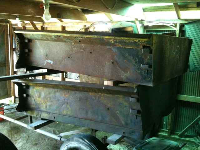

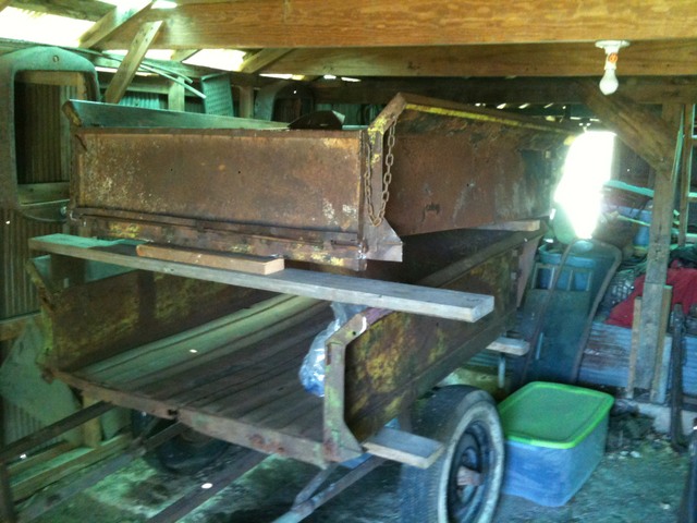

    Once we had a cab (or even just the back panel of a cab), we knew we could pull off the rest of this project in one fashion or another. I had developed a theory that REO used the same pickup bed as some other manufacturers. It made sense to me that REO would not tool up to build beds for these low-production pickups. Comparing pictures convinced me that the beds were the same as those used by off-breads like International, Stewart, Willys and others. Distinguishing features were small straps forming an exposed stake pocket and an angular top rail (no rolled tube). We picked up a bed fitting this description at the Lawrence, KS swap meet. Dad paid almost as much for that bed as we paid for the Shaniko REO, but we were pleased to get it. Then, I found another bed just like it alongside the road at a place you might politely describe as a Perpetual Rummage Sale and Yard Ornament Emporium. (We have a lot of those in the Ozarks.) Having the two beds side by side was nice to help identify the proper shape and location of pieces that were missing from each. We felt like Dr. Watson and Sherlock Holmes trying to figure out the correct number and location of tailgate hinges and segregating original welds from farmer repairs and home-made ****.
    <O:p[​IMG]</O:p>
    <O:p</O:p
    We knew from the start that our found beds were 6 inches shorter than the REO pickup beds. We thought this would be fine. The Speed Wagons had kind of a long overhang in the back anyway. This would be sportier and still hang over to about the same location as the rear sedan bumper. Dad and I had a lot of fun engineering where this bed would sit. How high? How far behind the cab? How would we construct the skirts below the bed, how the gas filler would exit, etc. It would have worked. We could have used one of these beds and no one would ever had known that my theory was completely wrong. <O:p</O:p</O:p

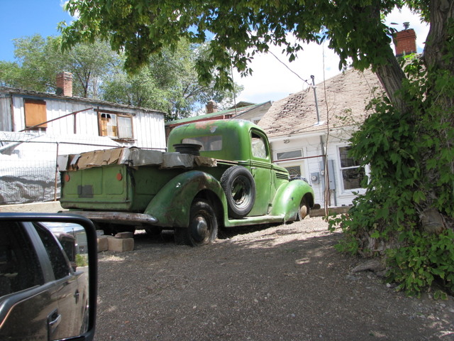

    Here are some more roadside treasures from the trip west.

    To recap from where I left off on the build, we questioned the width of our found pickup beds. They were a pretty standard width, but it occurred to us that the width of the pickup bed would be crucial to fabricating the rear pickup fenders. Dad would have to modify his sedan fenders for this purpose. The REO pickups have a pretty uniquely shaped fender. The rear fenders have a full crown that slopes back into the side of the bed symmetrical to the outside curve of the fender. They aren’t flat on the top like a Model A truck/coupe fender. The outside edge of the fenders is a fixed dimension, but we were working in open space trying to guess where the fenders and bed were supposed to meet.
    Dad made some calls to the guys at Full Circle Restorations who have restored two Speedwagons and confirmed that our beds were too narrow. (We now think they may be Dodge pickup beds-still discounting the yard sale guy’s opinion that one came off a ’26 Studebaker. If they are Dodge, that might be fortuitous, because I might throw one on my WC59.)
    <O:p</O:p
    <O:pWe could widen one of these beds. But there may be another option? </O:p
