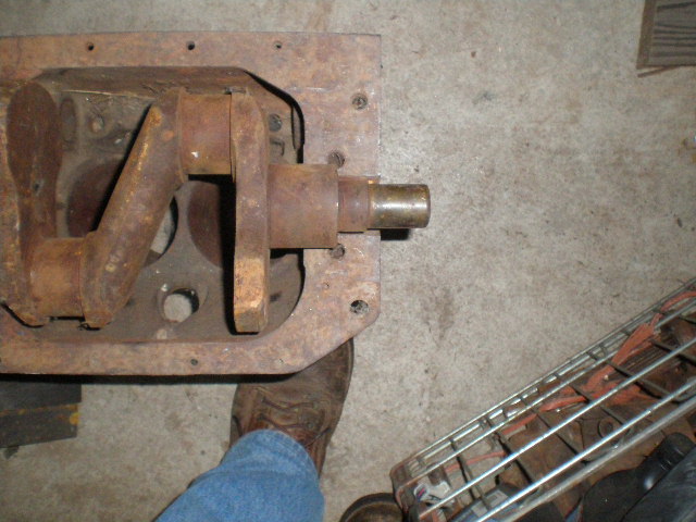

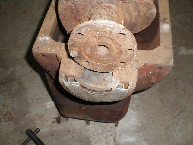

    Found a crank at my favorite scrap yard. Knew it was old so I dragged it home. Checked the mains (2.222) and rods (2.000) with a caliper. Took these pictures with it sitting in a ford block. Anyone have any idea what it is? Oh, its cross drilled. Norm

    The Fedral Mogul bearing book suggest a 120" 4cyl. rod 2.093 x main 2.248, no other comes close. years are 1946-1953. So could be a tractor crank like an 8N. Pat

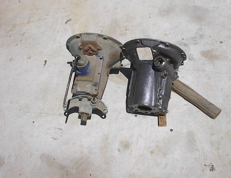

  24. Here is a transmission photograph for for those that wonder just what a Lincoln side shift transmission looks like. These transmissions were used in the 38 39 Lincoln Zyphers, not sure about 37's The gear shift comes out close to maybe 15 degrees off plumb and they used a shift lever with several bends in it so it could come out of a sorta console under the dash. If you look at it you can get an idea of how much more room there is for your throttle/brake foot. Especially true in a 29. They came with the same gear sets and bearings as the Ford units. The "long Lincoln's" didn't come into use until 40 and was a column shift. The column shift is now referred to as a side shift as it operates levers on the side of the case. On the Lincoln side shift that I'm currently running I bent the shifter lever that operates the forks to the right so that the gear shift looks normal, closer to plumb. Well, it looks normal to me! It has a rectangular end 2.5' or 3" Long. and I had a cuttoff "socket" from a stock shifter that had a short straight shifter on it
    The photo is deceptive but both transmission are the same length
    The 37-39? box has a Ford pickup open drive line conversion.
    Take a look!

    Just for giggles, can you lay that crank in a Chevy block?

    Your wish is my command. Doesn't work much better in the Chev. I think the guess of a tractor crank is correct. there was no block there, but there was a cast oil pan of some sort. looks like I'm out $20. Norm
