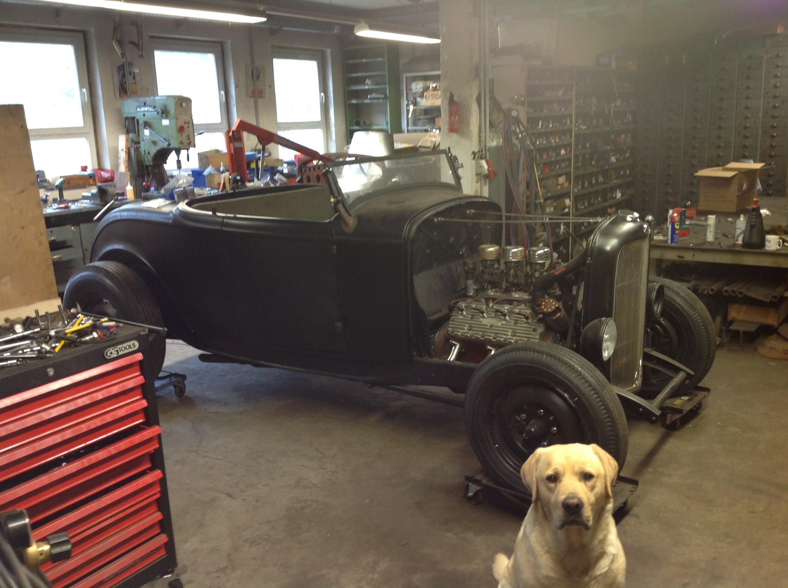

  29. HotRodMicky
    Joined: Oct 14, 2001
    Posts: 1,793
    HotRodMicky
    Pic of setup
  30. HotRodMicky
    Posts: 1,793
    HotRodMicky
    Show off
