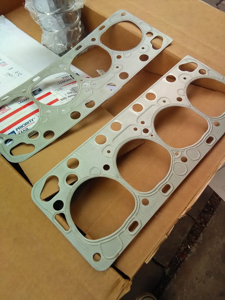

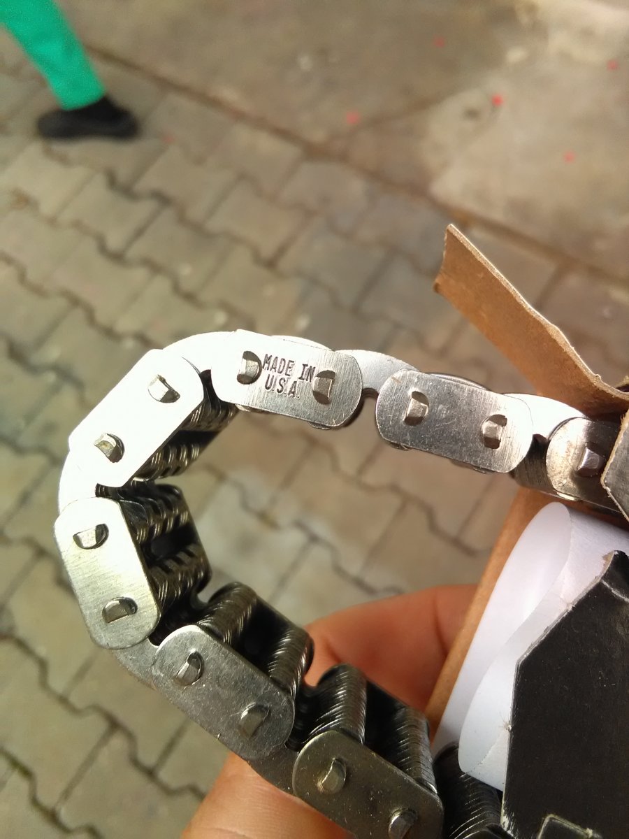

    ´nother little update: Got the transmission buttoned up a few weeks ago and so it was time to tear into the engine.
    All clearences were in spec ( crank was already .010 under) but some of the bearings had some copper shining through, so it was a good time to replace all of them.
    The bores were in spec ( .030 over) and ridgeless, I just broke the glance with a slight hone and replaced the rings. I was doubting the quality of the now availible replacement bearings which are probably made in China or so--- so I found a set of NORS TRW main and rod bearings on ebay here in Europe for 50 bucks! What a steal and the bearings were perfect!
    I was glad to see "made in USA" on the new sealed power timing chain and piston rings! The NOS steel shim head gaskets came from Wisconsin I think. I was glad I found them, I don´really want to loose any compression to the thick multi layer head gaskets.
    There was a lot of gunk in the water jackets, after all I´m glad I pulled the trigger and opened the engine although it ran like a champ. But it´s always easier to see what´s going on while it is already out of the car instead of overheating and loosing oil pressure on the first hot day next year... I think all the parts to rebuild the engine and trans were less than 500 Euros including shipping , so that is cheap insurance.
