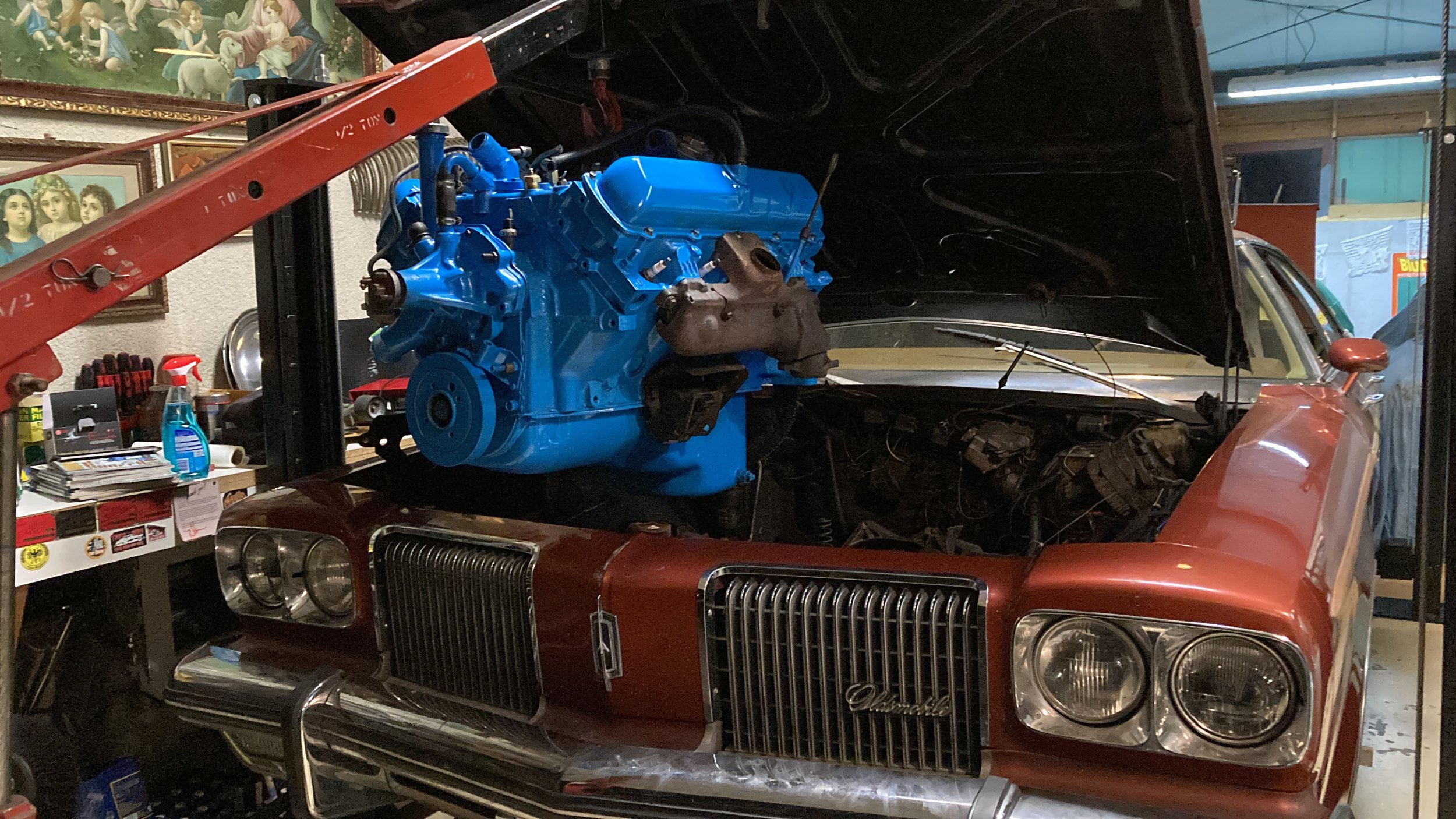

  13. Baumi
    Joined: Jan 28, 2003
    Posts: 3,271
    Baumi
    52643834-7AD4-4E68-A6DD-CDEEB68247A0.jpeg 81077AF2-D17F-4E22-B0BD-1DA9D219D285.jpeg 9AE71255-8638-43FD-B58C-035D2473EC12.jpeg 39C56823-95F4-4885-91BF-DCFE425ADA81.jpeg 890B1C06-CC5F-4751-AD72-51515D74E508.jpeg 0C9FB47B-EE96-4CCB-98C2-3E0A8D6A83AD.jpeg I got the crankshaft back from the machine shop with the rear main seal surface turned down .007“ and now the crank spins freely. The 460 Ford seal also seats perfectly. I got the engine buttoned up over the weekend and hope to get it into the car before the stand gives up…
  14. Onemansjunk
    Joined: Nov 30, 2008
    Posts: 497
    Onemansjunk
    from Modesto,CA
    G M, overshot their wad, thinking a filter sock, in the gas tank would be a good idea. Yes you can blow air back to the tank and the filter sock expands, the car runs fine. BUT the suction from the fuel pump collapses the filter sock, restricting fuel to the carb. If the Olds has never had it’s gas tank removed and that filter sock is still on the end of the fuel inlet tube. It’s like SCHRODINGER’S CAT. You don’t know until you open it up. Could be why the Olds is being a dog.
  15. Baumi
    Posts: 3,271
    Baumi
    1D1CD938-CAD8-4382-9D85-20DEB4E20BE3.jpeg 64ECDC37-30AE-4E1A-A9A4-42DB14C7F33C.jpeg Thanks for bringing this up! That‘s very valuable information for me… who would have thought?
    In the meantime I put the engine back in the car and the first test drive went flawlessly.

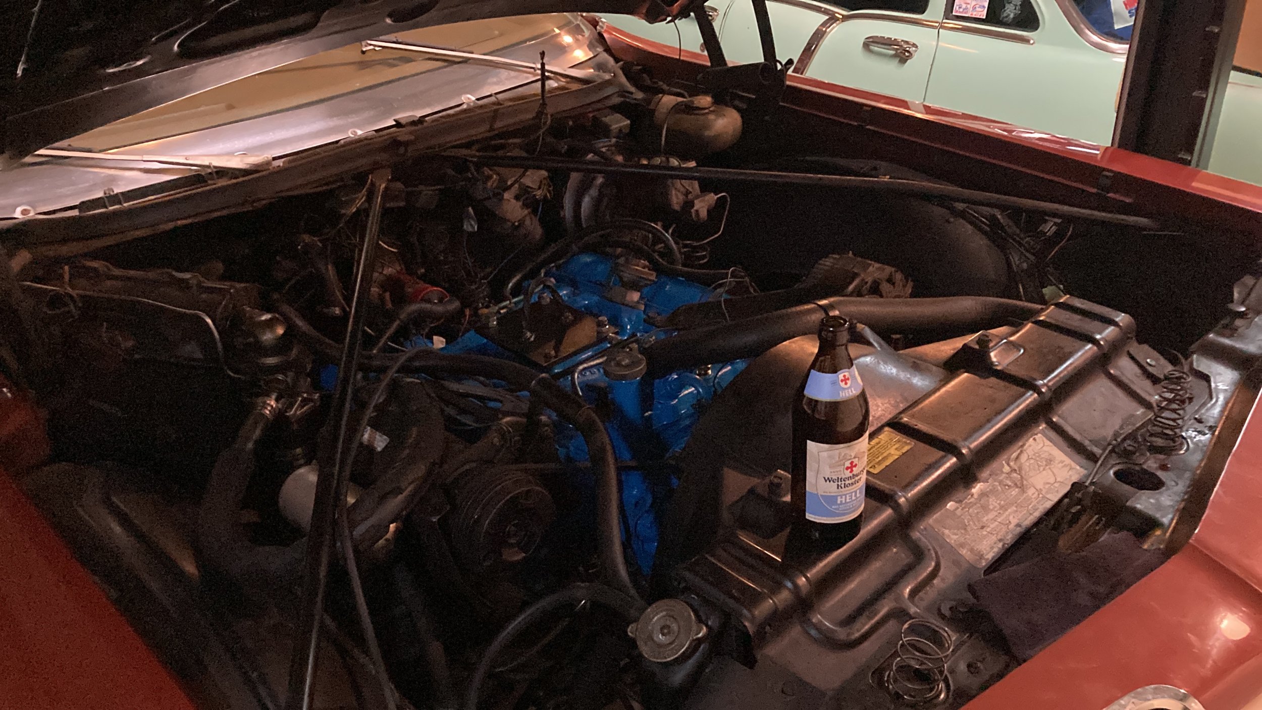

  18. Baumi
    Posts: 3,271
    Baumi
    Right now I´m trying to put some miles on the new engine. I played with the vacuum lines and I switched from ported to manifold vacuum, the engine seems to like that. It´s pretty cold here now, but sunny and dry, so perfect break in weather.
    BF55FDAB-72CC-45D6-9094-07C89C112B8A.jpeg 51E1826E-C5D6-4B0C-83DF-8F9405297E00.jpeg 98A88A3A-9E11-4584-881F-B650414F41DE.jpeg

  23. Baumi
    Posts: 3,271
    Baumi
    I notice you caught the beverage I snuck into one or two photos....
    porkshop, SS327 and RodStRace like this.
