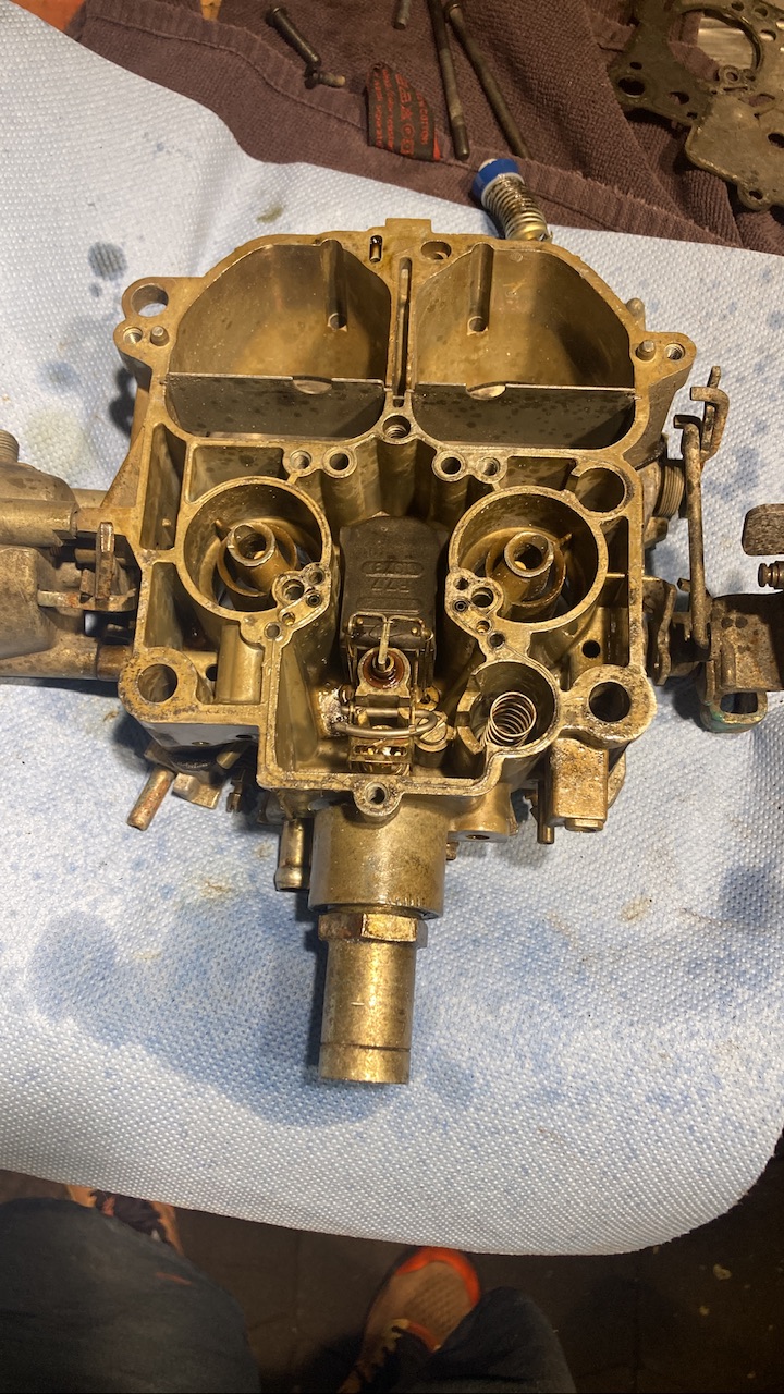

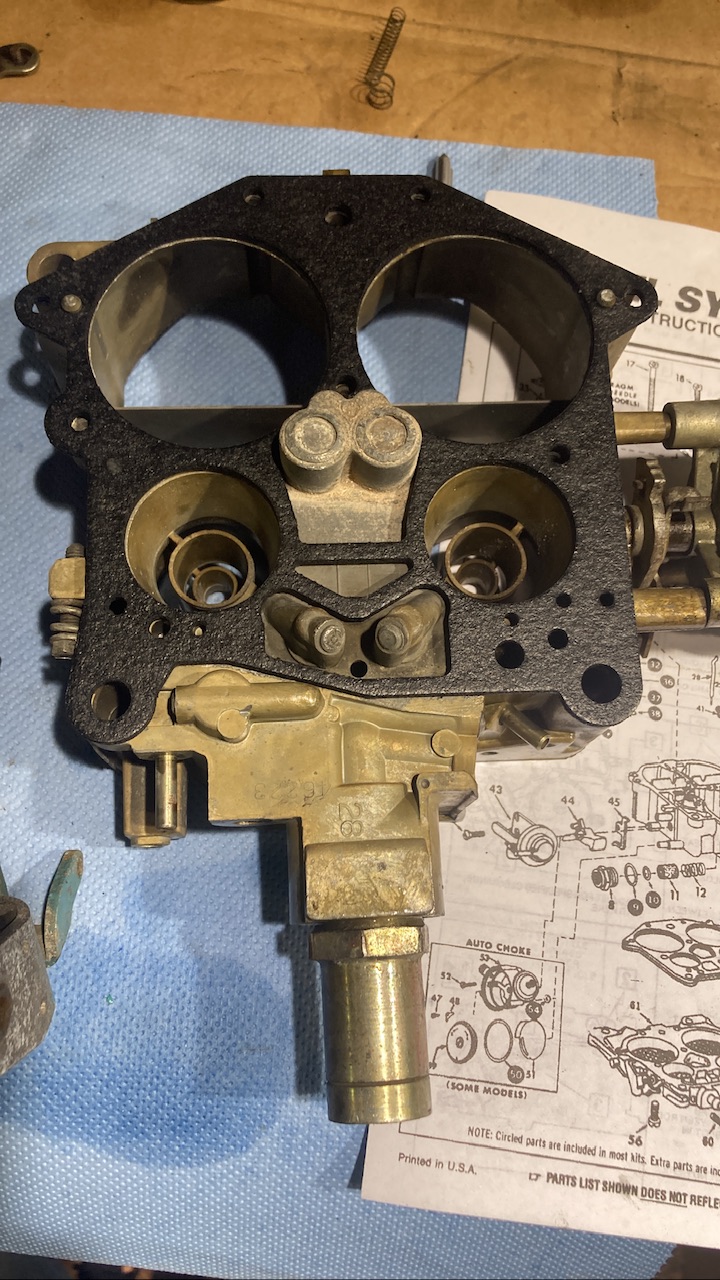

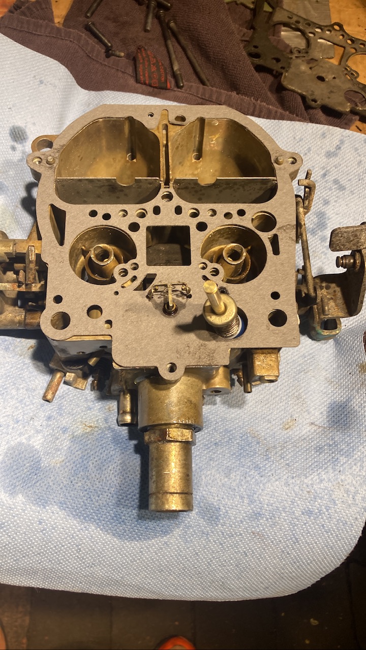

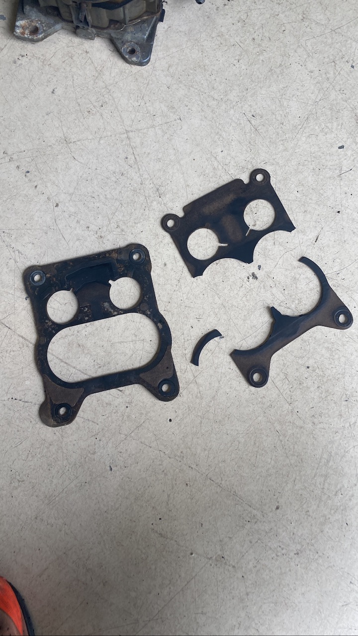

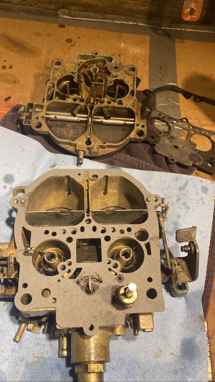

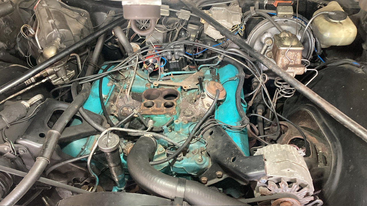

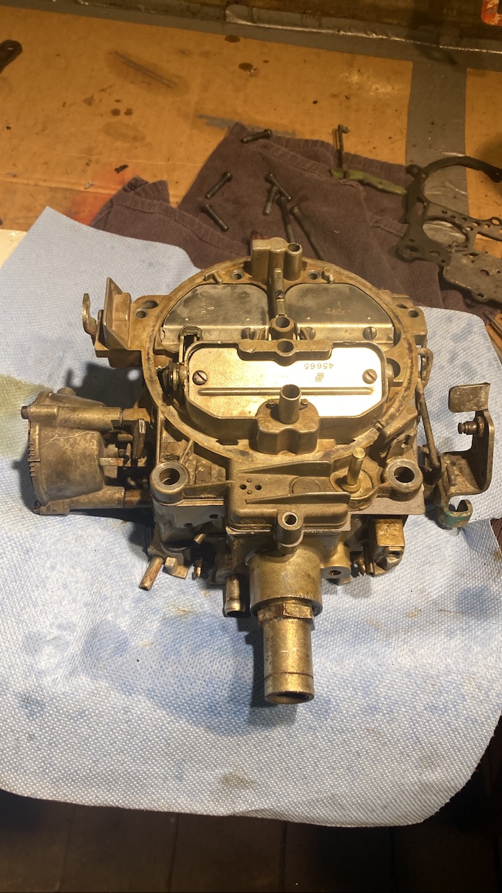

    Here´s what I´m working with
    The carb had serveral servere vacuum leaks. Now it really runs well, but just won´t restart once it´s hot.

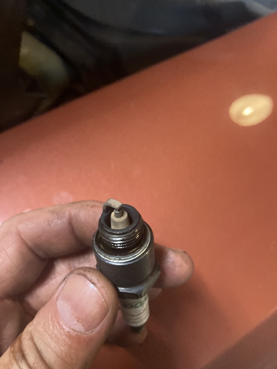

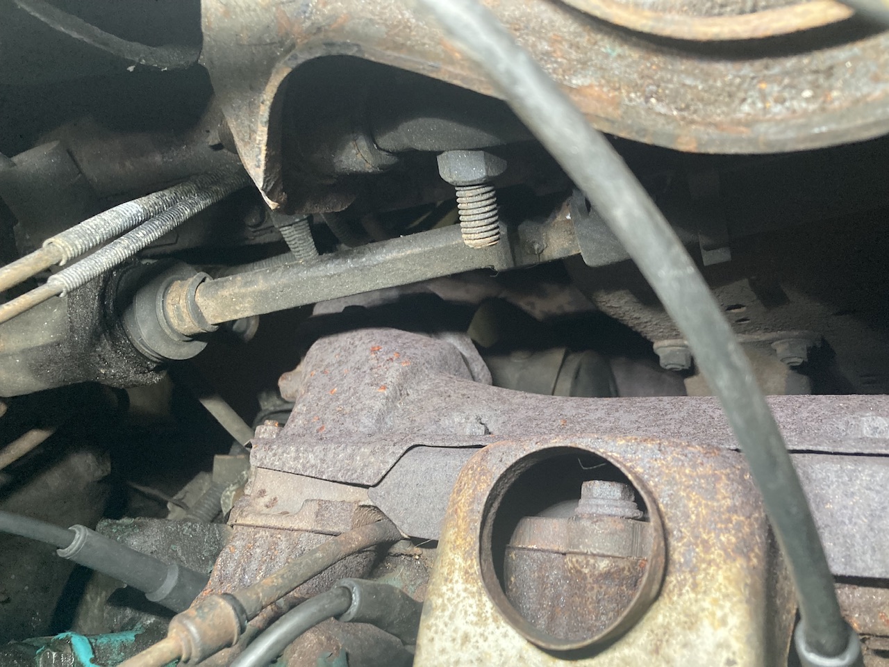

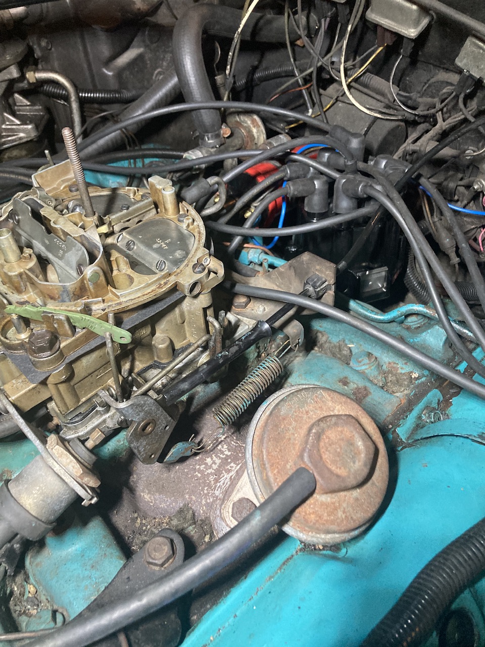

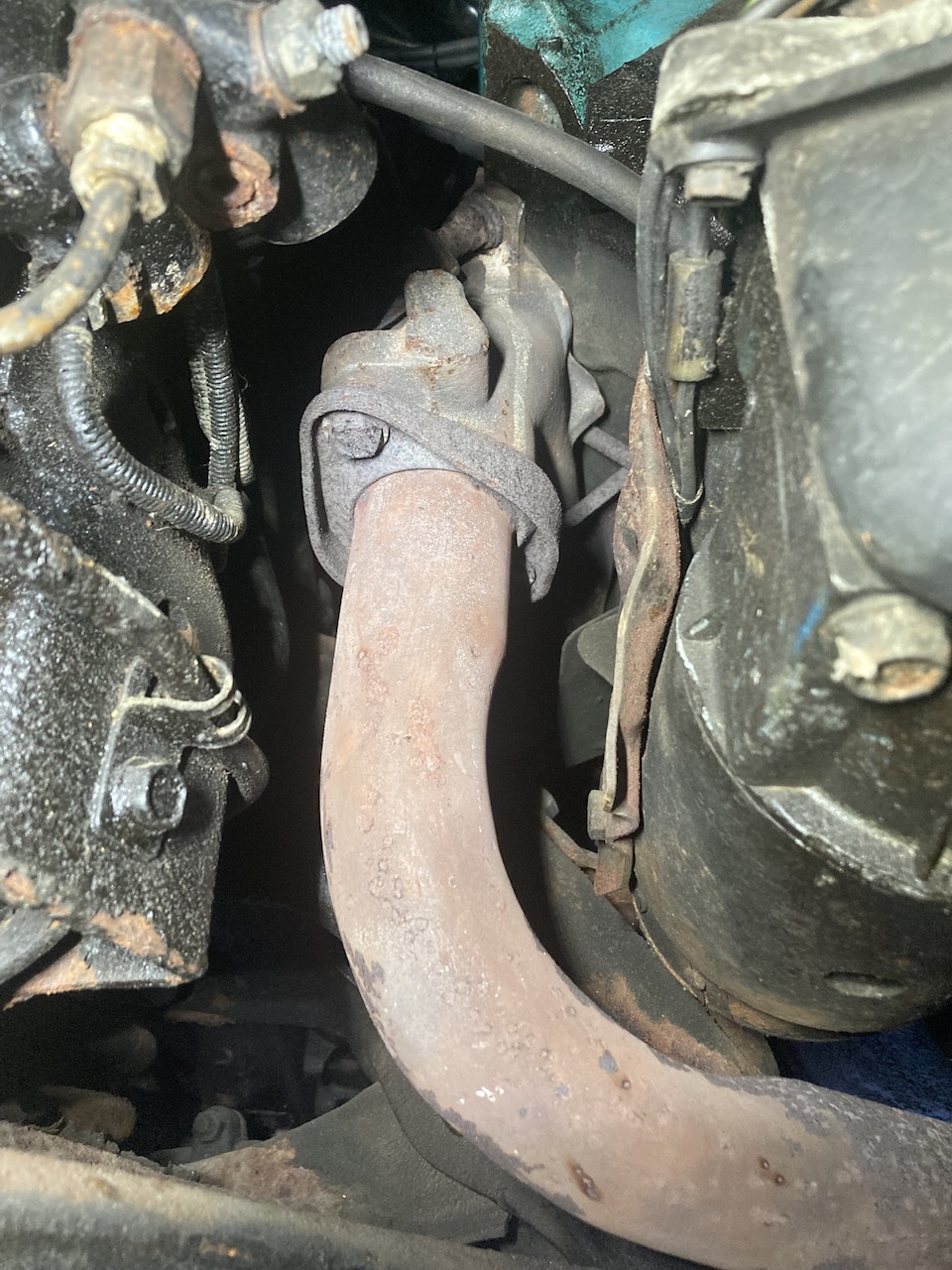

    here‘s a short update cause I **** at typing on the phone . Plugs are looking great, spark is good, muffler is not plugged, but I could not find a heat riser valve either. There seems to be a boss where the exhaust manifold could have been drilled for one, but it‘s not , and no rod or nor spring are sticking out, so I´d say, it does nor have a heat riser valve.

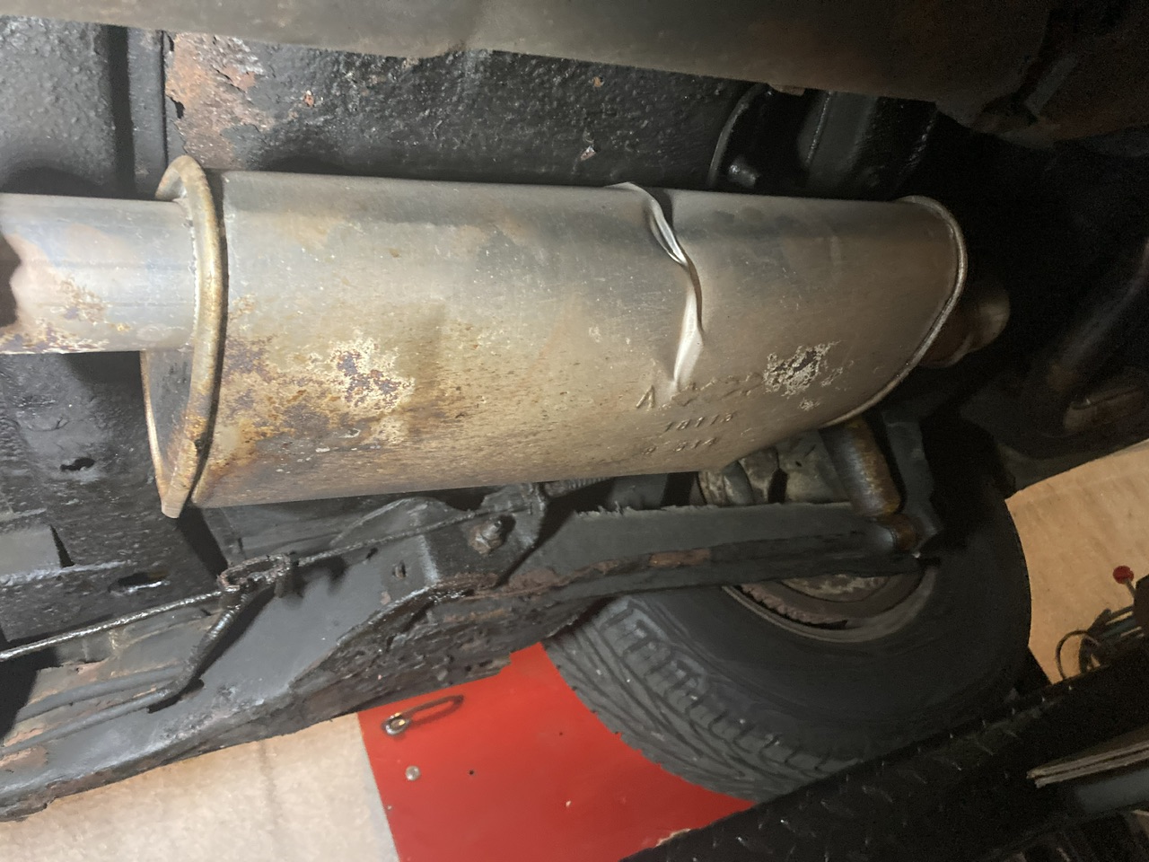

    You can actually tell where exactly the manifold is getting really hot, as the paint is pretty much burnt up . This is the driver´s side manifold that has the heat riser boss cast to it, but I can´t find where the rod and spring would be.

  19. squirrel
    Joined: Sep 23, 2004
    Posts: 60,039
    squirrel
    the muffler looks su****ious, eh?
    I agree it looks like no heat riser valve.

    Jim, yes it does. I removed it and poked a piece of hose through it, and there´s no "pluggation" going on as far as I can tell. It may even be pretty new. Rudi told me I wasn´t the first guy trying to get it running right, maybe someone before me flooded the engine and exhaust system and once the enginge hit , the muffler went BOOOOOM. It´s a pretty solid piece, not like today´s chinese made tin foil mufflers. There were a lot of Mockey Mouse fixes to get the car running, as carb base smeared down with bathroom silicone in an attempt to fix vacuum leaks and many more.

    I'm highly su****ious of a plugged muffler. It looks-and acts...well, like it sure could be. And a '74 Olds with points is normal. Have a helper stand behind the car while you floor the throttle. It should blast his hand HARD. If not, it's restricted.

    Try pulling vacuum hose to EGR and plugging it.
    Might rule that out anyway.
    I had a similar problem with my later model 350Olds. They use a stamped metal intake manifold.
    After sitting for years it somehow lost its seal and would leak when hot.
    When you get it warmed up good and still running take a small spray bottle or squirt bottle of water and wet down the intake to head area. Listen and watch.
    Mine ran a bit better and also was able to see the water being ****ed in.
