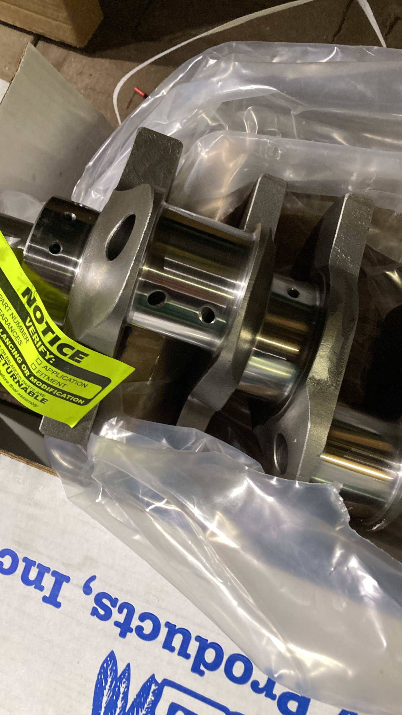

    My parts finally arrived! A friend was kind enough to put my parts in the car he had shipped over here, this saved a ton . I´ve got a new eagle crank from summit, new sealed power pistons for a 71 Olds 442 with less dish to bring up the compression to around 9.75:1, a new oilpump, bearings, etc. I put in the new cam bearings last night and plastigaged the main bearing clearances. Now everything is coming back apart for final cleaning. The machine shop called, they fixed my #1 rod which had been bruised by the worn and spun rod bearing. Now the fun part begins... edit: Fixed some fat finger mishaps
    4E55A135-6624-4188-AFE4-D1A3B22C8F6C.jpeg C83C122E-DEC6-4DA7-9AB9-143CDC5EE912.jpeg BAC30D84-FA1C-4AA7-89B6-C195D2EAF21E.jpeg D80C0AA8-3A8C-4A89-9C09-53DC57DD8F6F.jpeg E1ED42A3-4E37-4178-A643-E5CD811C0C2B.jpeg IMG_5766.jpeg
