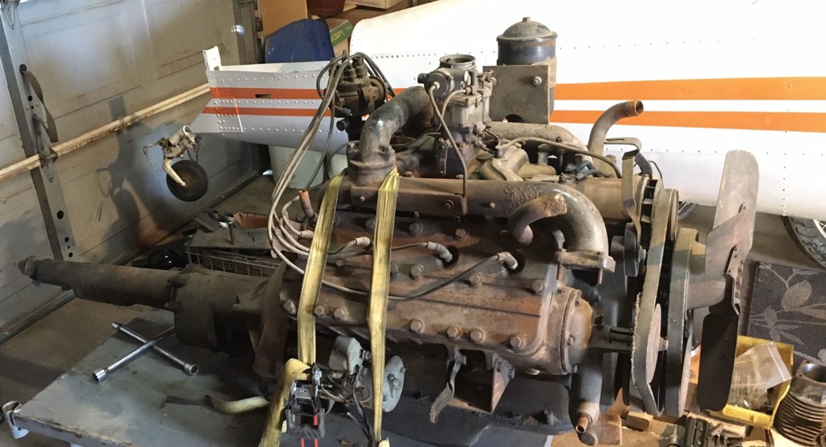

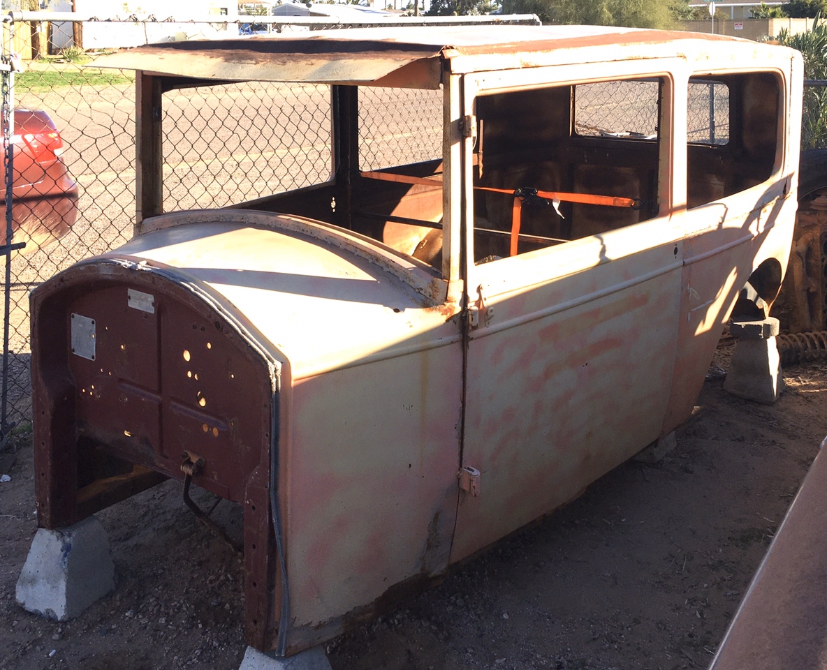

    I traded for a pretty complete ‘28 Buick body, frame, frontend last week. The next day I lucked onto a very complete 1940 Cadillac 346 sidevalve and transmission. I’m hoping to use as much of it all as possible. Adjustments.JPG Adjustments.JPG Adjustments.JPG

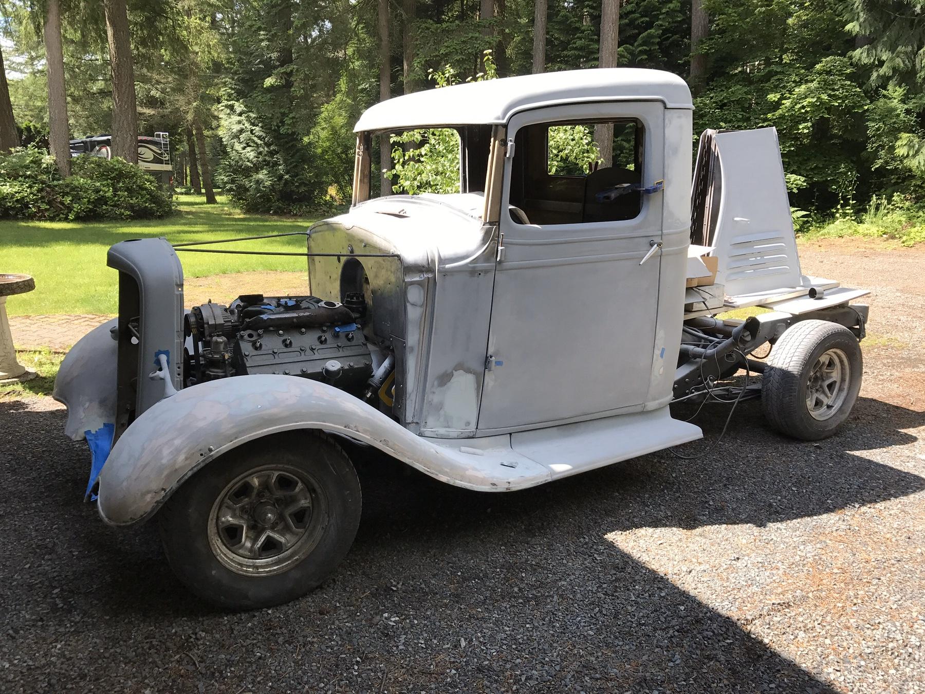

    Here’s mine...[​IMG]
    Rusty, Greasy, Noisy

    This body has had all the wood replaced with tubing. The welding is terrible but the fitting is pretty impressive. They used the top out of maybe a 1970s station wagon, left all the inner bracing in when they grafted it in. I’ll have to redo some things but mostly just pick up where they left off.
    It IS a big car for the era, it may make axles and such easier, especially since I want to stick to pre-1950 GM parts as much as possible. Drum brakes, manual steering, etc. I had an A coupe, chopped 5 1/2”, just TOO small for me/the wife.

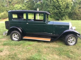

    Good luck with the Buick. Here is my 27 - very similar 064118AA-1B29-4A1B-9CC7-34505CA1BEFB.jpeg

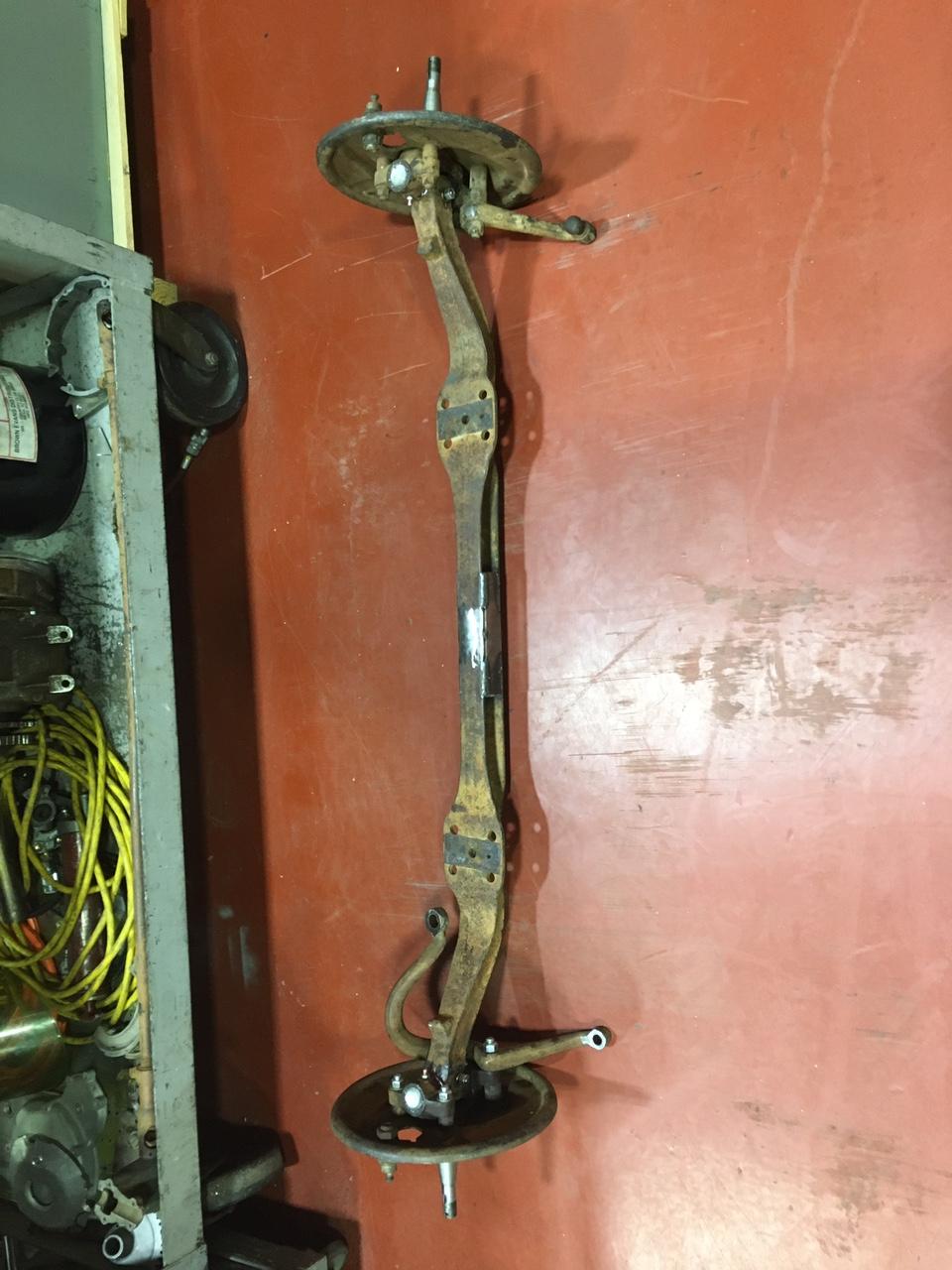

    Trying to stay GM [​IMG] IMG_0289.JPG where possible, I found a complete 1950somethin’ Chevy truck front axle. I’m going to go low$$-lowtech with the whole project, reuse and repurpose anything I have or can find easy/cheap. The Buick front tread is 56 1/2” and this axle is 58 3/4”. I’ll cut 2” out of the middle and make a pair of 1/2” thick sandwich plates to drill/bolt the axle back together. Not sure on the steering box yet.....

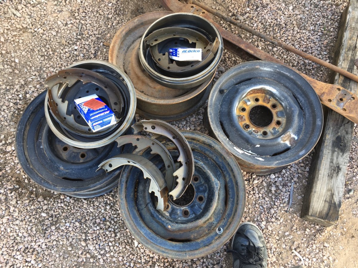

    Today’s score, drums, shoes, spring kits for the front axle. $60- parts were ran 200 miles from new. 4 steel wheels $60:) Adjustments.JPG

    This Chevy front axle tread is 59” and the Buick’s would have been 56”. I didn’t want to narrow the Chevy a full 3” because the spring perched would end up too close together so I settled for 57” (2”cut out) As promised mods are LOW TECH. What would I have done in 1955?

    I cut a 2” piece out and **** welded the axle together. (I sighted down it for straightness) Then flush ground the top and bottom. I cut a pair of 3/8” thick plates and welded them to the sides. I’ve found that if you keep welds lengthwise rather than crosswise there is virtually no stress raiser. Forged mild steel patched with mild steel plate makes for a very strong repair. In 1955 I would have either brazed it or stick welded it. (I did cheat out of laziness and MIG welded it)
