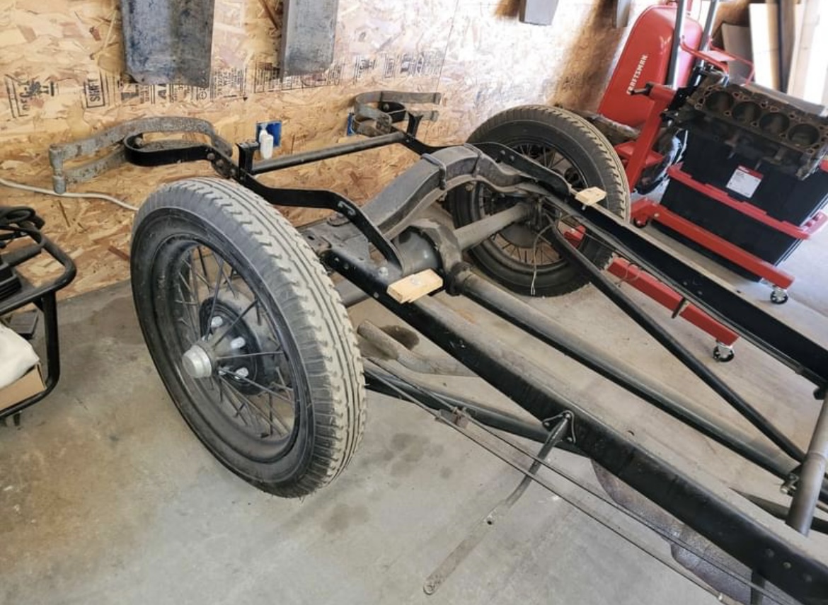

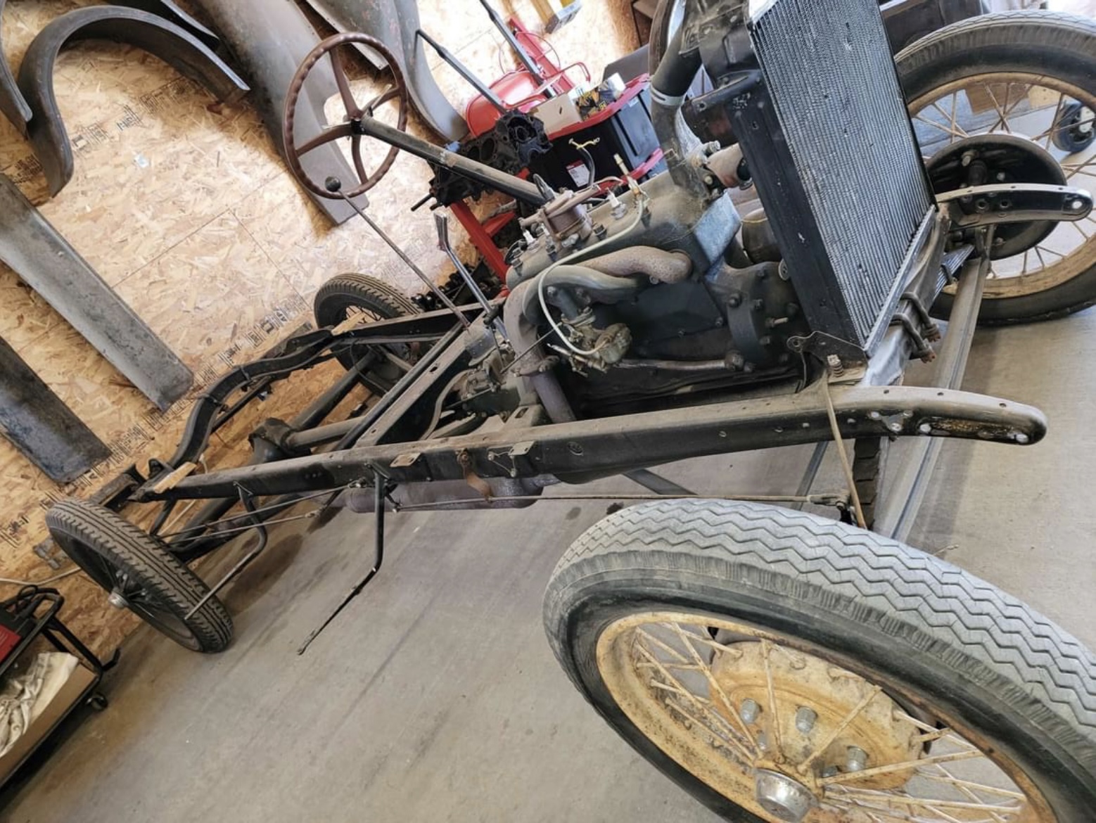

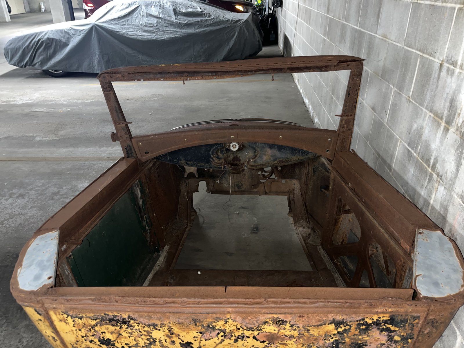

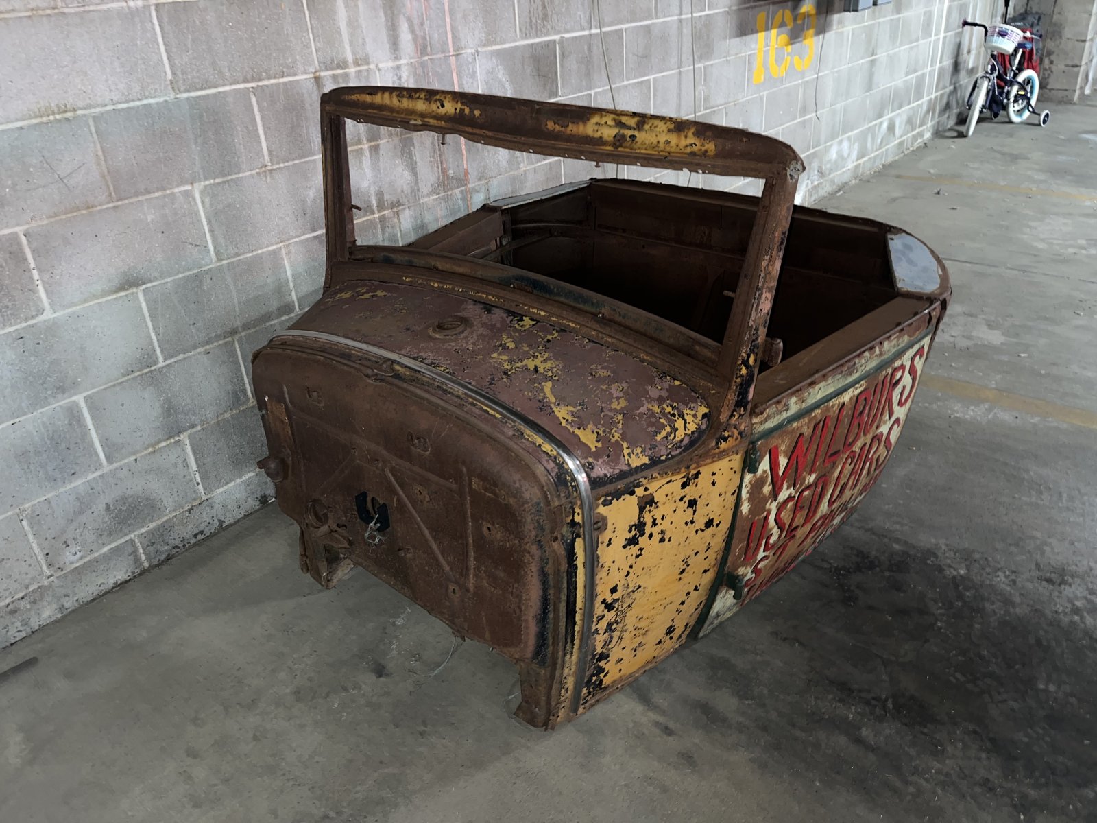

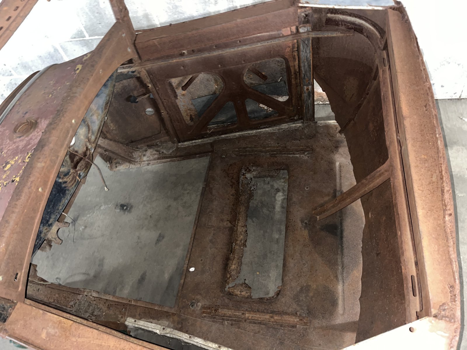

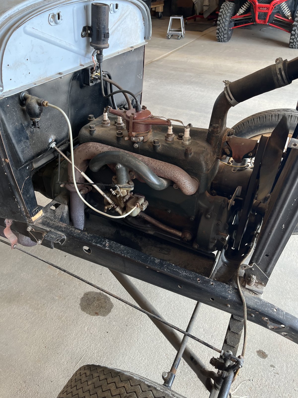

    Here is the start of my first foray into Model A’s: A banger-powered hot rod jalopy build, using a 1930 slant window cut-down sedan body and pickup bed on a nearly-perfect 1928 chassis. The body is quite unique, as you can see by the hand painted door, custom cut back panel, and of course the welded doors. I’m from Minnesota, and got the body off a guy from Wisconsin, who told me he bought it from a guy who pulled it from a junkyard in Minnesota, so I’m glad it made its way back. The chassis is numbers-matching with the motor, has virtually no rust, runs, drives, shifts and stops great, and has almost all it’s original parts, with some new parts (the rear wheels and tires are nearly brand new).
    My plans are to build this into a fairly period-correct hot rod/jalopy, with a high compression head, a big single or dual carb and intake setup, better ignition/distributor, better brakes, and a straight-pipe exhaust. In the future I’m considering a bigger or reground cam, a full pressure oil system, and perhaps a T5 or ‘39 transmission swap, or something similar.
    Being new to Model A’s and the banger power plant, what can you all recommend for hop up parts on a budget? I’m building this in an apartment garage with limited space and tools, and I only have $2500 into the build so far with the body and chassis combined. I’ll post more pictures when I get the body mocked up on the chassis.

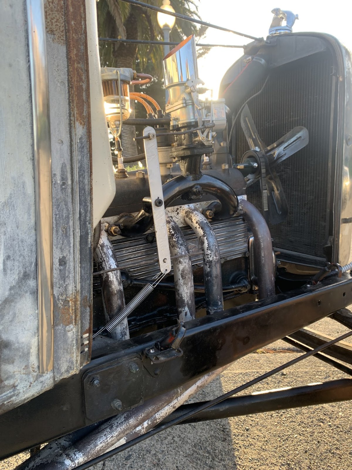

    I am running one of the new Stromberg 81s (it looks like a 97 from the outside). The intake is an old, homemade one from back in the day. It was made from a stock intake with the updraft cut off, hole plugged with a flathead valve, and a three-bolt flange intake brazed to the top. The head is stock and the cam is unknown.
    Other highlights include a custom linkage with Secrets of Speed connectors, an old 4-into-2 header, a FSI ignition, and a Model A PowerGen. I converted it to 12V (but kept the 6V starter). It's a ton of fun to drive.

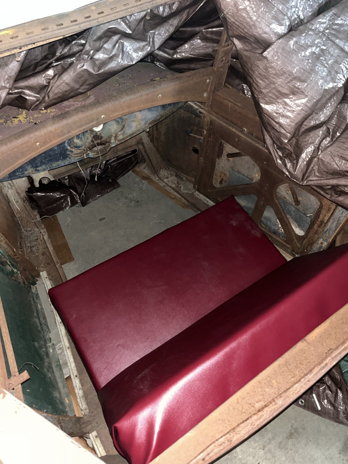

    Well I just finished up a homemade seat for the RPU build. I cut up some seat foam I got a crafts store and also cut sections of a used memory foam mattress topper, and placed them on some 3’ x 18” plywood. I chose a nice dark red colored marine-grade vinyl, wrapped it around the foam and plywood, and used heavy duty staples to hold it all together. Turned out pretty good! It’s comfy and adjustable. I’ll probably have to raise the bottom portion up with brackets or something, and attach the seat back somehow to the bottom, or to the back panel, but for now, this will work great when I mount the body on the chassis. IMG_8358.jpg

    If you are going with the FSI, upgrade to 12V. I am running the 12V FSI, that is where most of the upgrade expense is. It's a move you will never regret. Brighter lights, better starting. I am running pretty well the same setup as Joey. Downdraft 97, Red's headers, 6.1 head and FSI distributor.
    Gonna be a nice project, like your seat.
