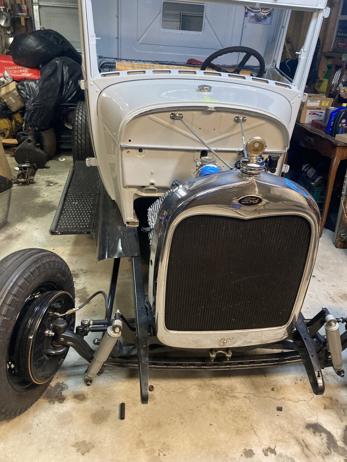

    Well, it’s high time that this gentleman gets to drive his beloved ‘29 Pickup. He’s had a few people waste his time and not get around to it, making excuses etc. It was even shipped to California for 5 years where it languished in a corner. I met Bill a while ago at a cruise; I was there with my ‘30 Tudor “Elizabeth” where we struck up a conversation and he told me about his pickup sitting out in California. We would chat once in a while via email and see each other at a cruise night here or there. I hadn’t heard from him for a while, maybe like 3 years and I reached out to him and asked how his truck was coming along. Well, it was finally shipped back from California, sadly, with not much progress. Now, Bill is in his 70’s and has had this truck since high school! I want nothing more than to see him driving this thing down the road with that **** eatin’ grin we get with a hopped up flatty blasting through town. So, I’ve dedicated myself to making his dream come true, with no ******** stories like “yeah, I’m waiting on blah blah part” knowing damn well there were no positive intentions. I’ve got the steering set up to accommodate the full fenders he wants, I’ve already designed and fabricated the the clutch linkage and brackets for the hydraulics, I’ve started on plumbing the brakes etc. I’ve converted to open drive with LaSalle trans. I thought you guys might enjoy the story and progress on this special project.

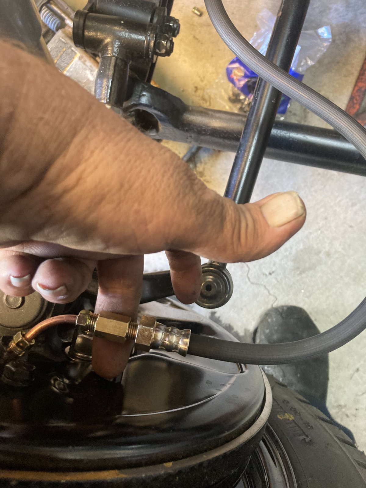

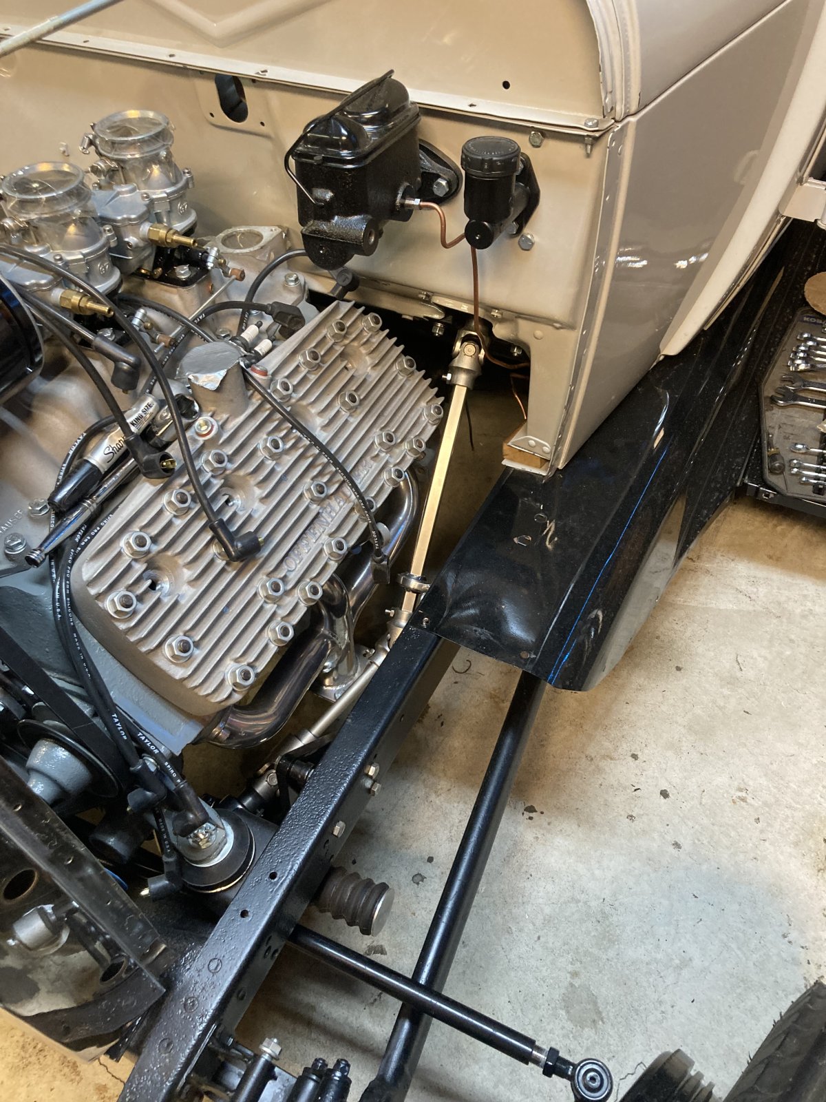

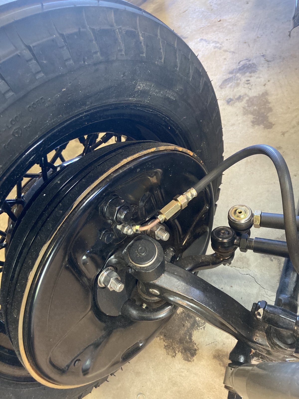

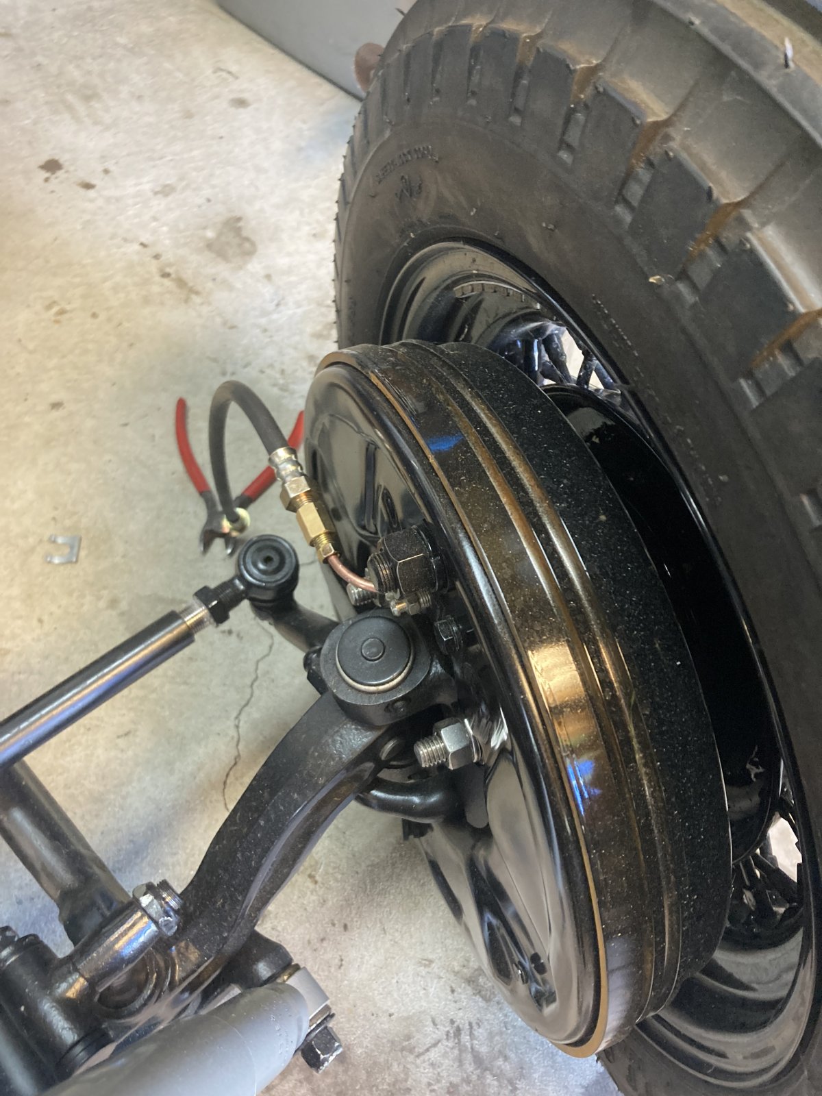

    IMG_5198.jpeg IMG_5197.jpeg IMG_5193.jpeg Just some brake plumbing. I wanted to make wheel cylinder replacement as easy as possible. At the same time making sure there is adjustable clearance if needed. Firewall bracket for hydraulic lines, so no need to drill firewall and I’ll figure out some bracketry to support lines coming off backing plates. We’ve all sat there and spun the wheel cylinders around to unscrew lines…this will eliminate that and keep it easy for clips on frame brackets. Everything is subject to change of course, depending on how the dominos fall, but I’m sure this will work. Thanks for checkin’ in fellas and hang out for more! IMG_5192.jpeg IMG_5193.jpeg IMG_5197.jpeg IMG_5198.jpeg

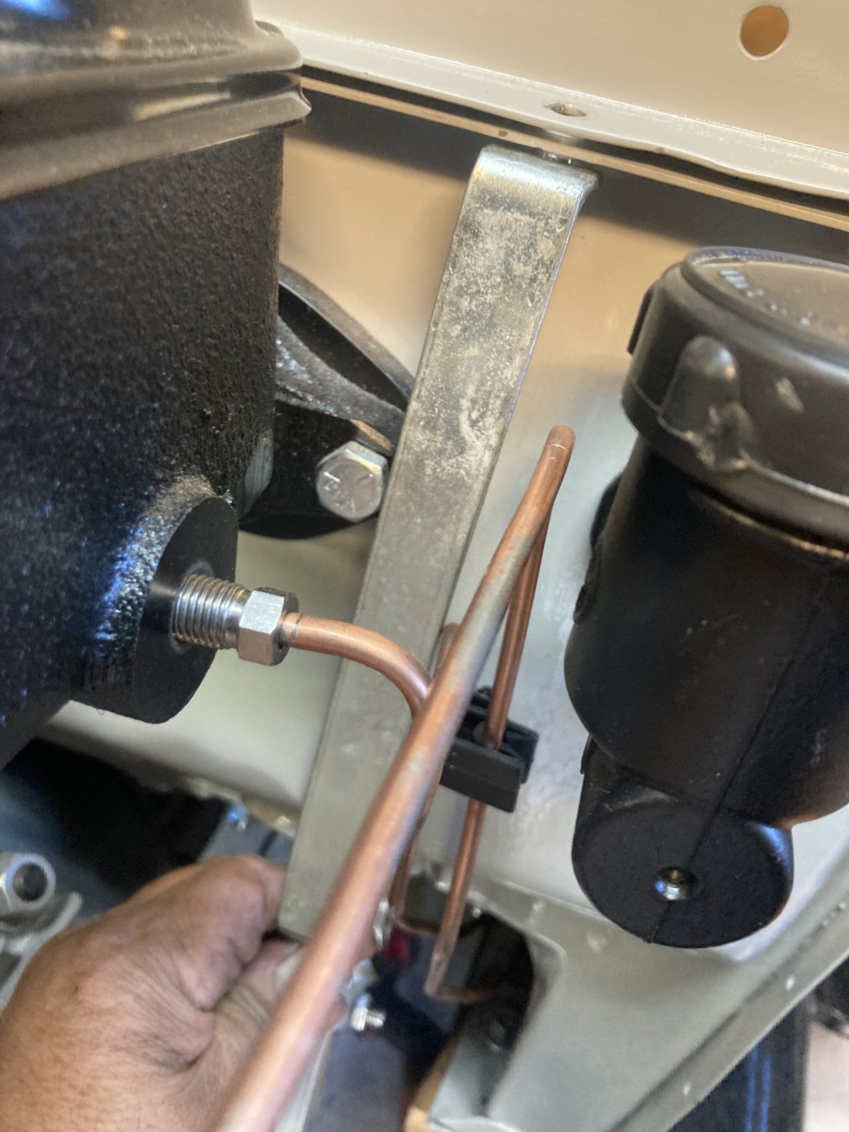

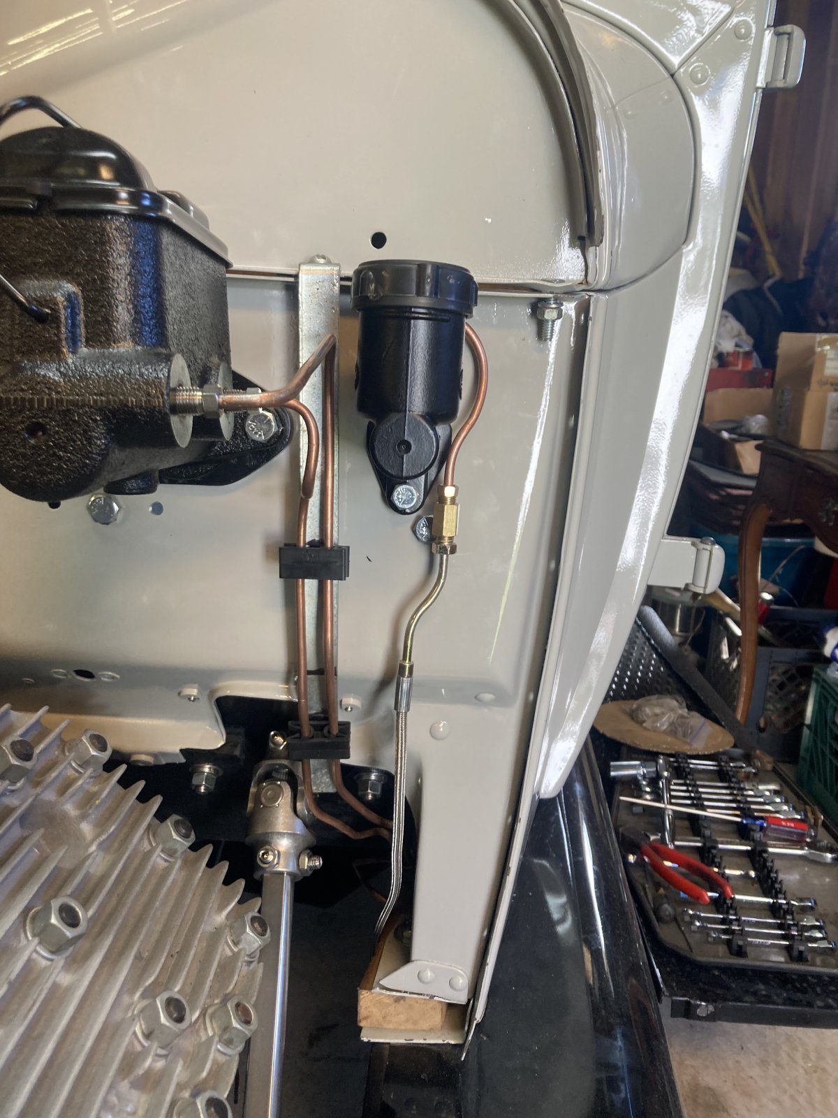

    Still temporary, but you guys get the idea. I’ll be adding to the bracket to capture the clutch hose too. Hope everyone is enjoying their Sunday!!
