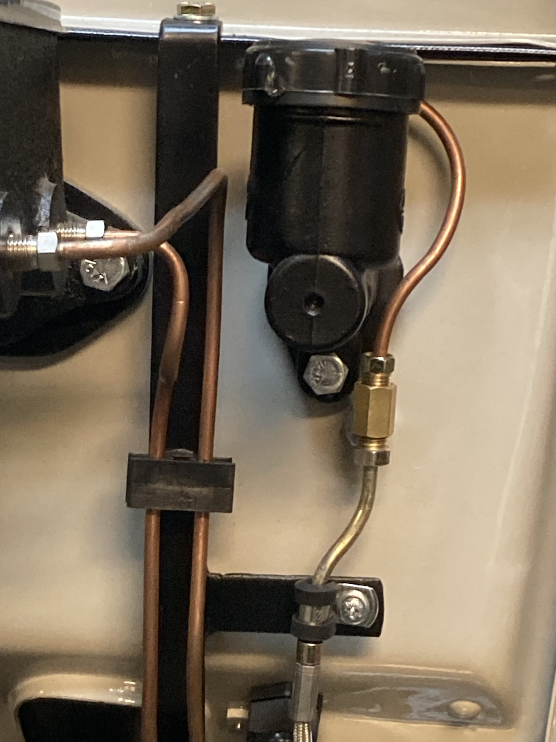

    Don't all of them have a tube seat?
  2. alchemy
    Joined: Sep 27, 2002
    Posts: 22,767
    alchemy
    Fronts seal with a crush washer. Maybe he’s using rear cylinders on the front?
  3. Piewagn
    Joined: Mar 25, 2009
    Posts: 1,542
    Piewagn
    He told me the brakes are the Lincoln style from Hot Rod Works. Yes, they are the 45deg inverted flare all the way around.

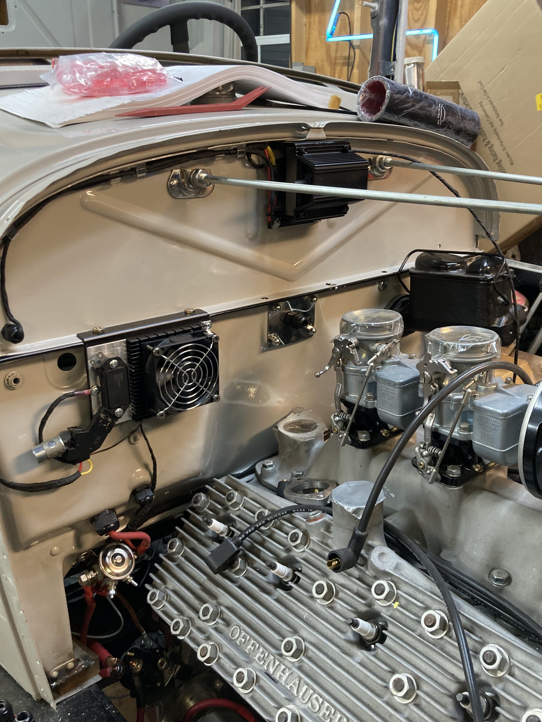

    Looks tidy! What are the things bolted to the lower firewall? One with a condensor and fan the other with a polished plate in the center?
    Kelly Burns, 427 sleeper and Piewagn like this.
  6. Piewagn
    Posts: 1,542
    Piewagn

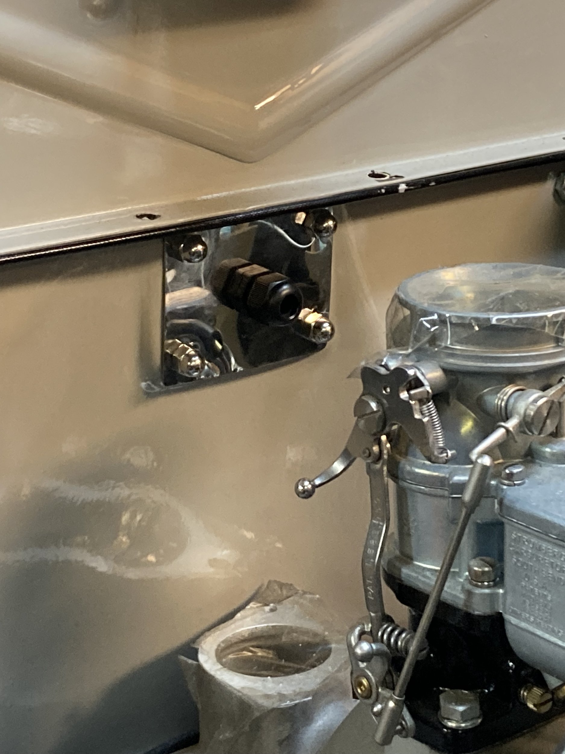

    I installed a continuous use solenoid that kills power for the entire electrical system with the flick of a switch. I’ll put the switch in a convenient but incon****uous location. The plate covers the old bake-a-lite electrical box hole and I used a wire/cable gland as a p*** through for the ignition, tach and gauge wires. The fan and heat sink are the ignition module with a GM factory plug with pigtail that usually would be on the inside of a GM HEI distributor. It’s a very efficient and reliable ignition system that I put together and use in all my vintage vehicles. Just need a distributor with a magnetic pickup. Hope I answered all your questions Tim. Thanks for your interest and your post!

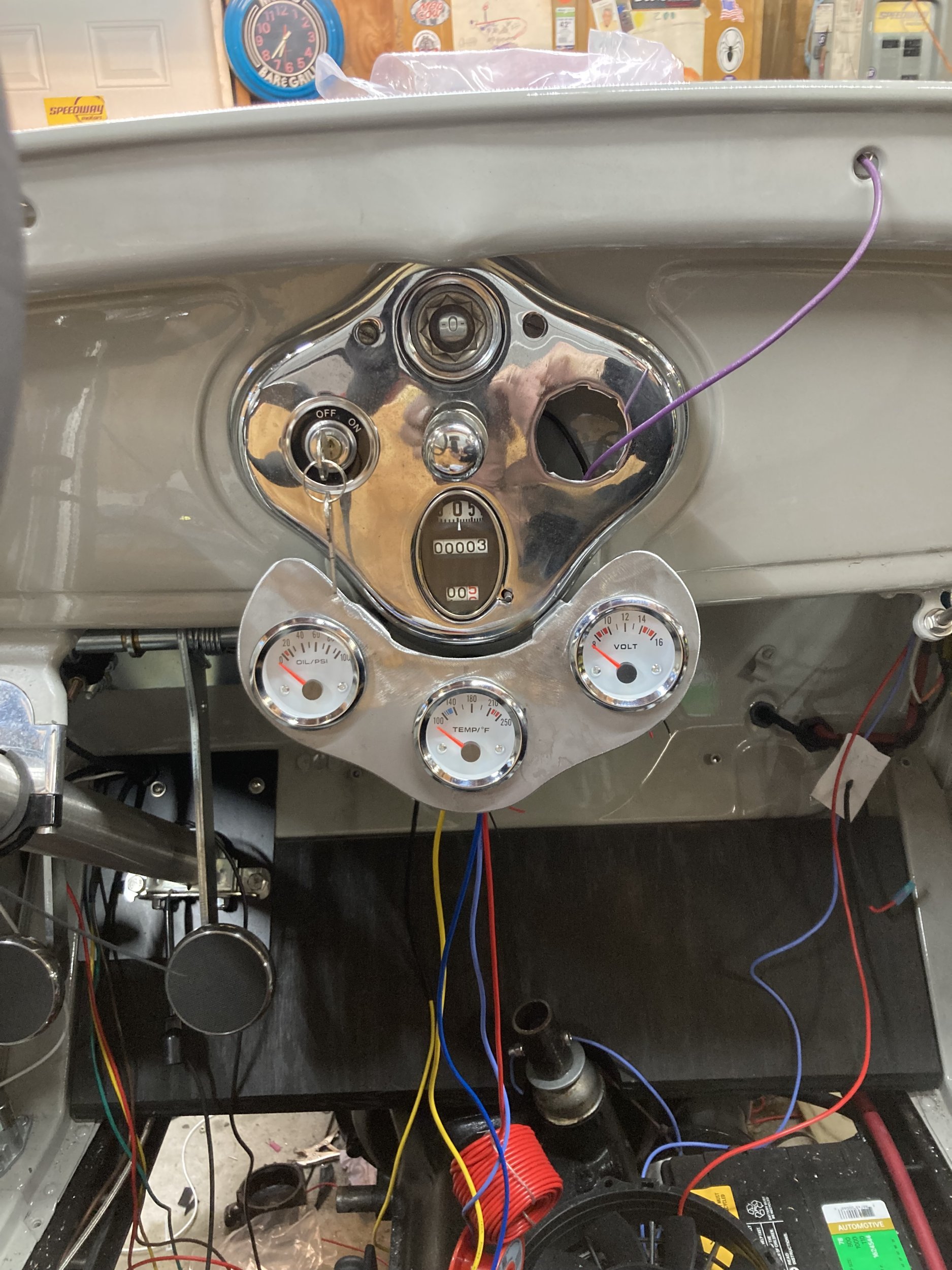

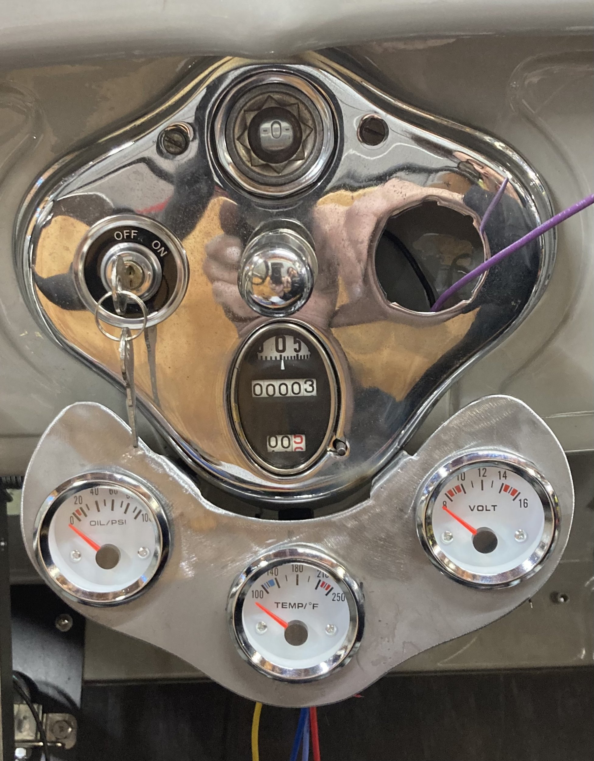

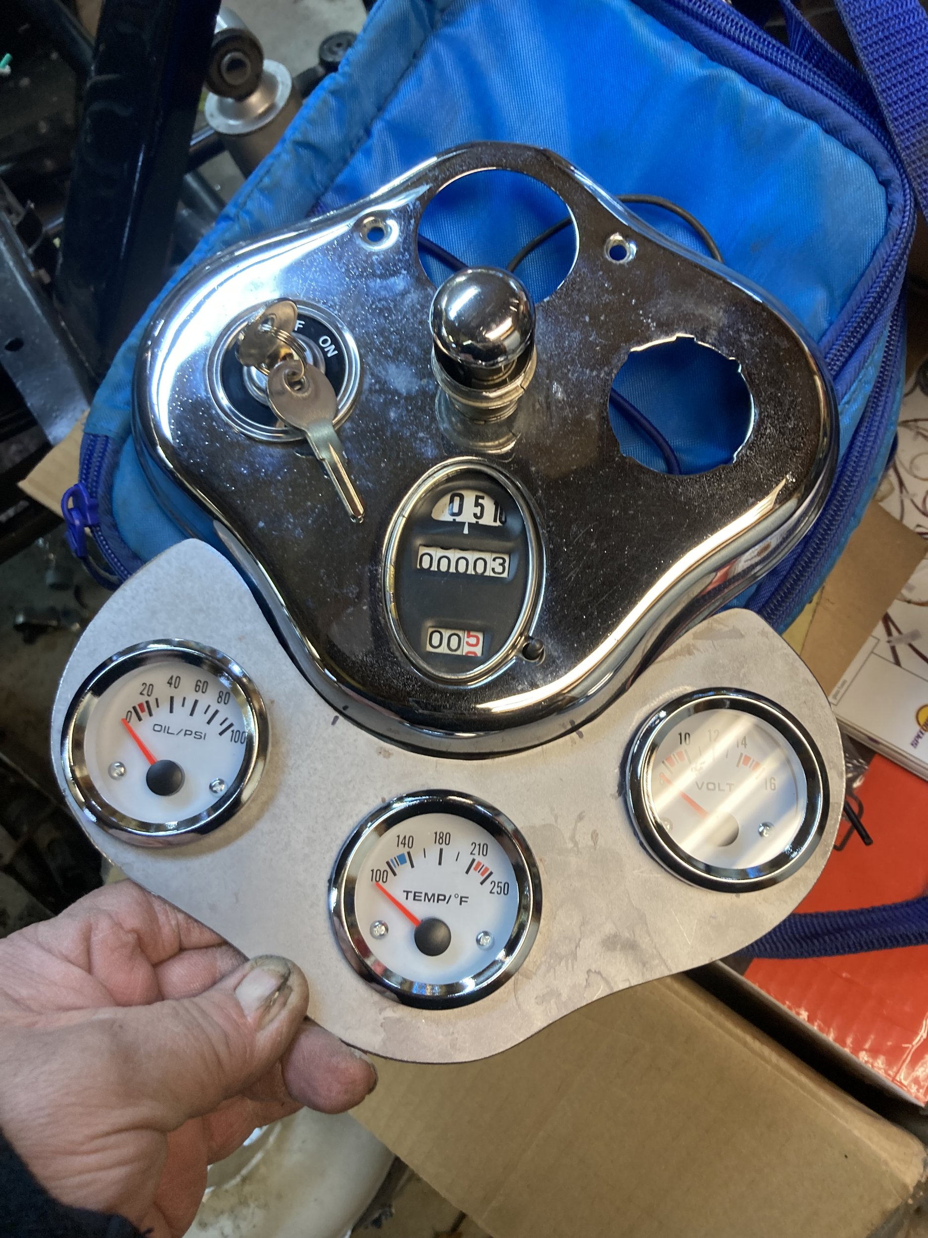

    Making a bracket for the gauges that’ll attach at the base of the dash bezel utilizing those mounting screws…should look nice when done. I have made more progress, will post more when I get more pics. Almost ready to start hanging the fenders. Thanks for stopping by fellas!!

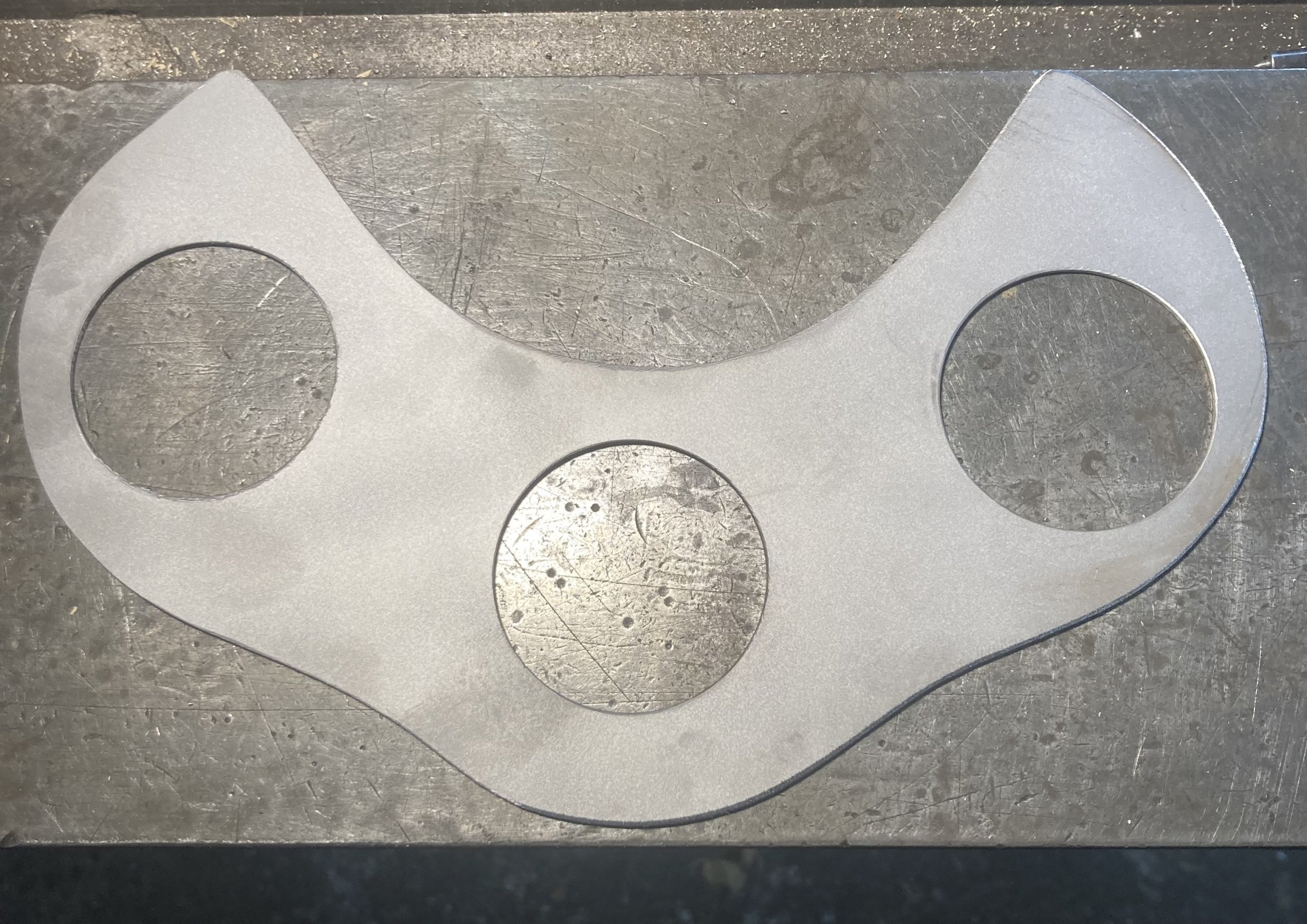

    Still have to make the mounting tabs and weld them on. Then paint… but this gives the general location. Thanks for stoppin’ in fellas!!

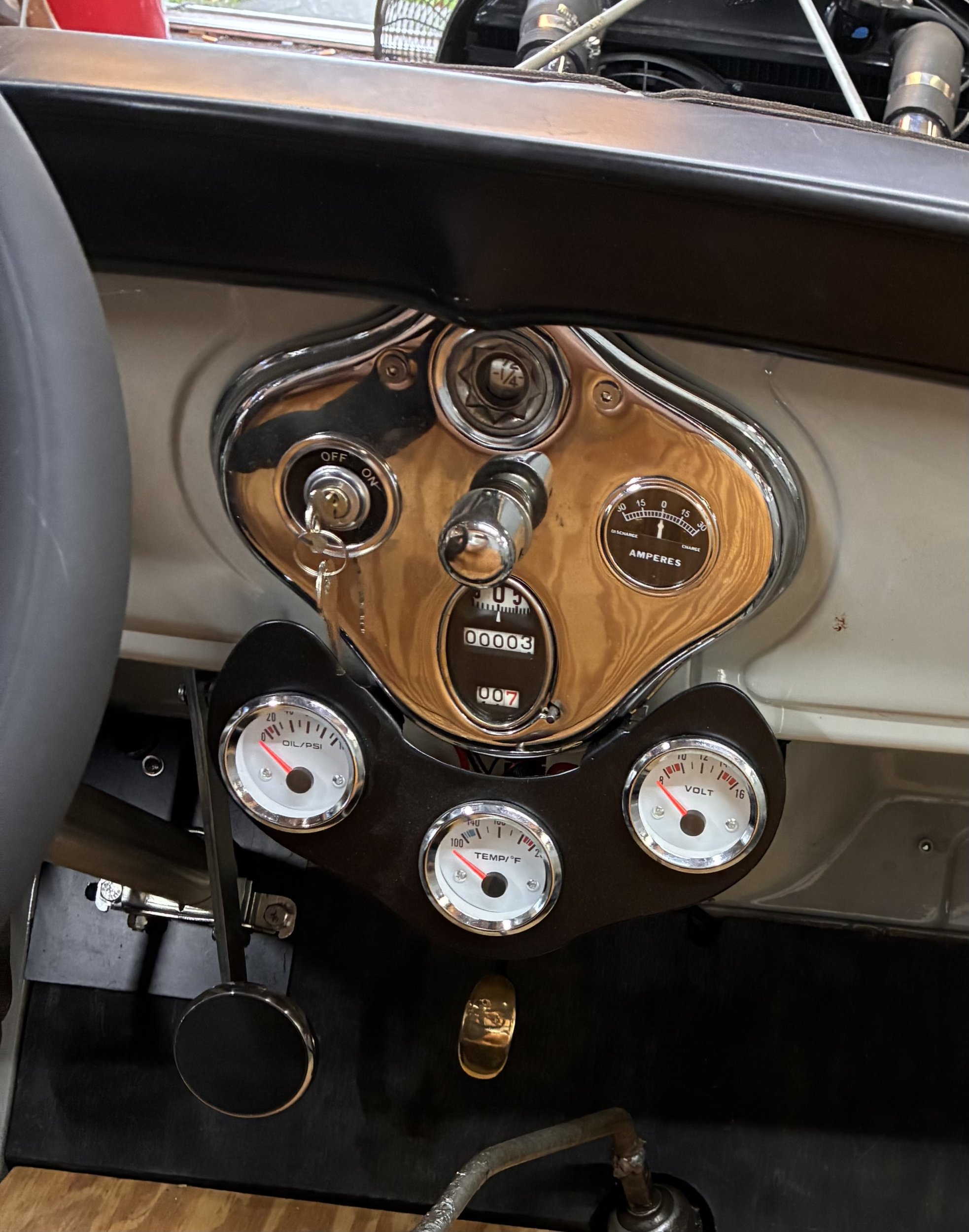

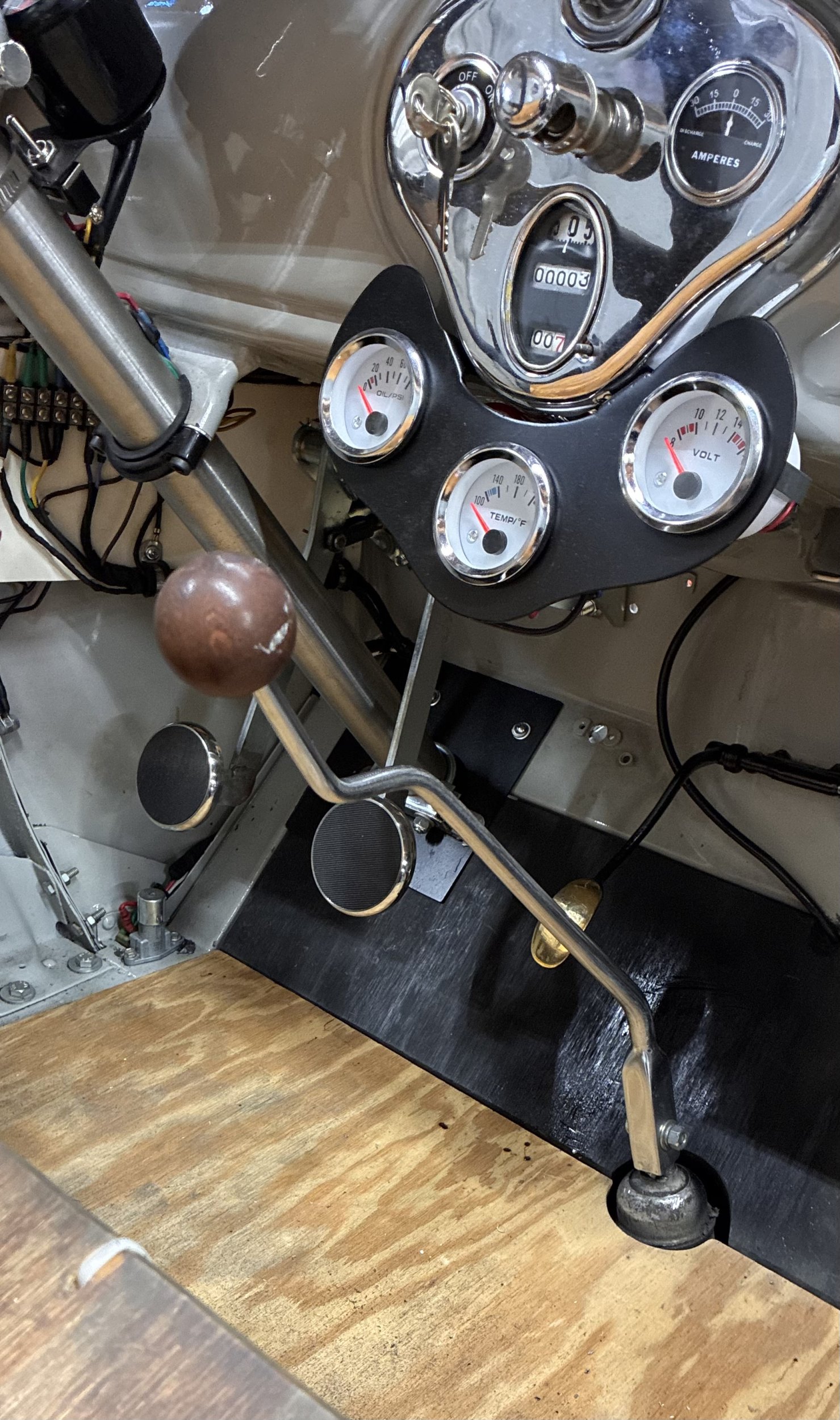

    here is the cluster finished up with the gauges. I made this extension panel for the wiper switch and starter ****on too.
    Shifter is temporary so we could take it around the block. I’ve got something custom in mind that will slide over the nub then a through bolt.

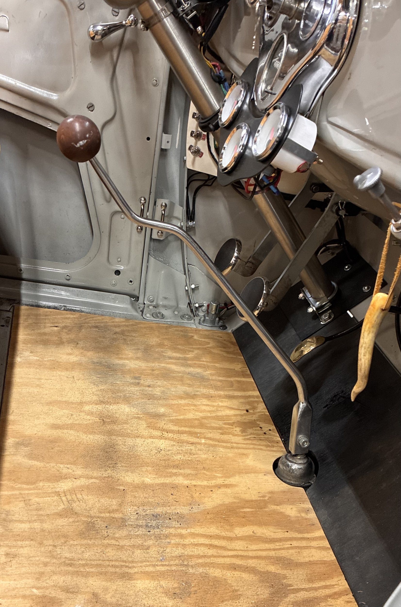

    Here is the shifter completed. Bill has a shifter knob he’s has for 50 years just waiting to install it on top of the stick. I’m more than happy to provide him with the opportunity to do it! Thanks for droppin’ in fellas!
