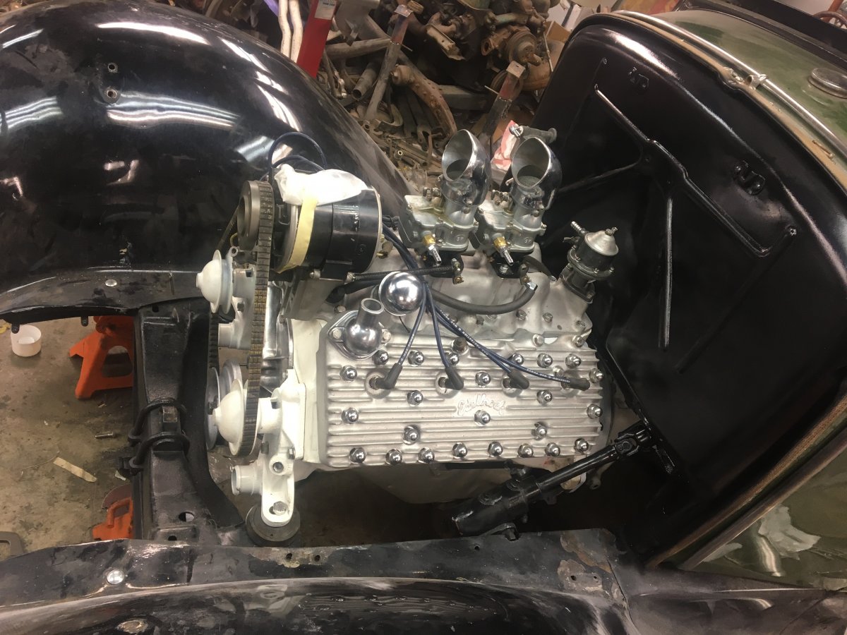

    60A94AC2-8A42-488D-9E73-6D3FB44401C8.jpeg 04199ED1-4E3A-40DB-A976-C44522FB0C02.jpeg AAF9AB1B-AD9F-4E67-BEDC-AF01A044479F.jpeg E9546B32-B5CF-4A10-A2EE-177C35B95167.jpeg I’ve been ***embling/building my ‘30 off and on, on the weekends. Chopped 5” in the back, and 6” in the front, a ‘64 Impala gas tank in the trunk, T spring with several leafs removed. 4” dropped axle with reverse eye main and several leafs removed in front I made a clutch and brake pedal mount. Keeping the fenders on and also the hood and stock grille.

    I saw your video on Facebook, looks cool and sounded good... like a real Hot Rod Should

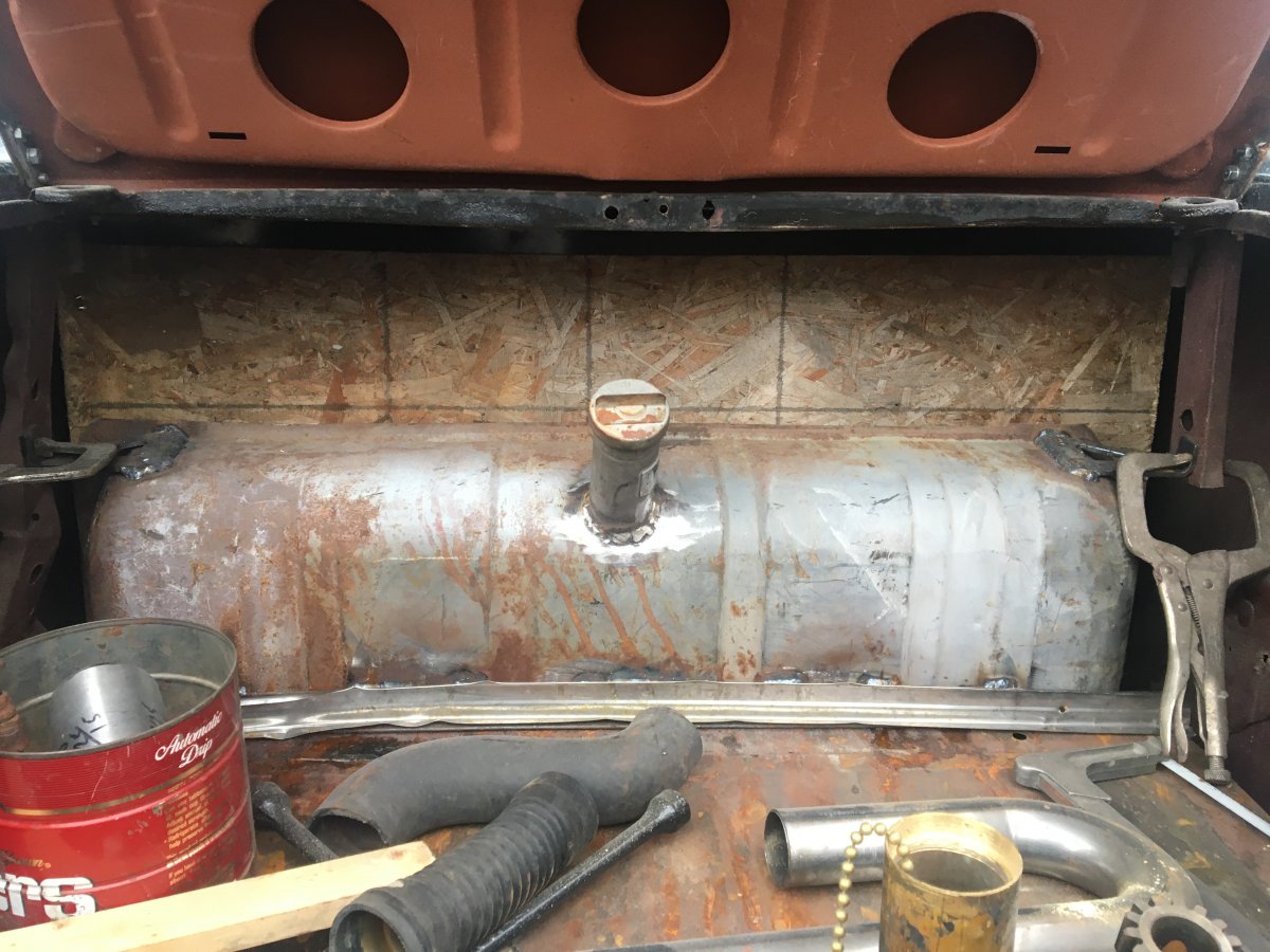

    "64 Impala gas tank in trunk, picture of this please.
  11. Ken Carvalho
    Joined: Dec 22, 2004
    Posts: 1,611
    Ken Carvalho
    It’s still in the fab stage, as I’m still running the stock A tank as well. Welded the fill to the center of the tank, welded tabs on the sides and bottom.

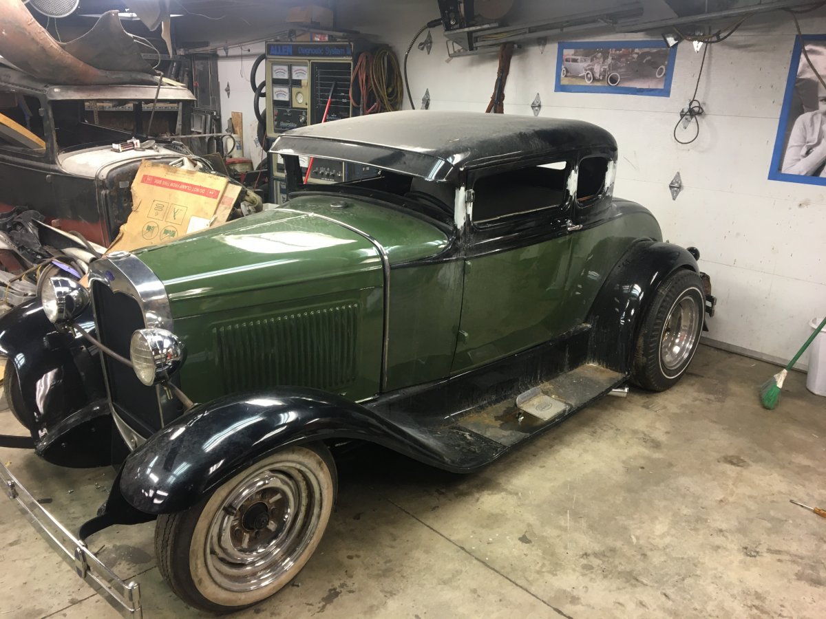

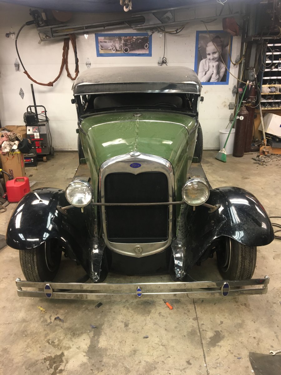

    Got the hood, shell, and lights on today. Been a very productive HotRod weekend, and I’m happy with the progress so far.

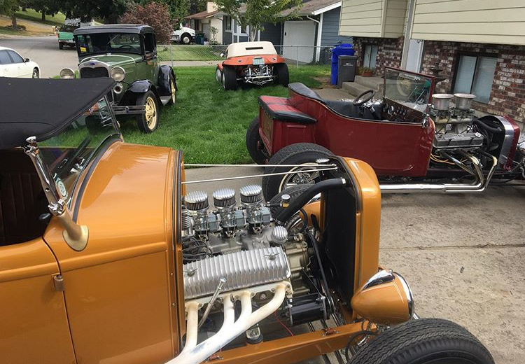

    We’ve got a few HotRods at the house so this one will fit in nicely as well.

    Is that last shot the "before" picture? It's great to see a car done up with the fenders in place for a change.
    bchctybob and VANDENPLAS like this.
  22. Ken Carvalho
    Posts: 1,611
    Ken Carvalho
    Yes, that Green/Black “stocker” IS the same A as the chopped lowered A. I like the fenders on. I may end up removing the hood though, I kinda like looking at the engine while driving!
