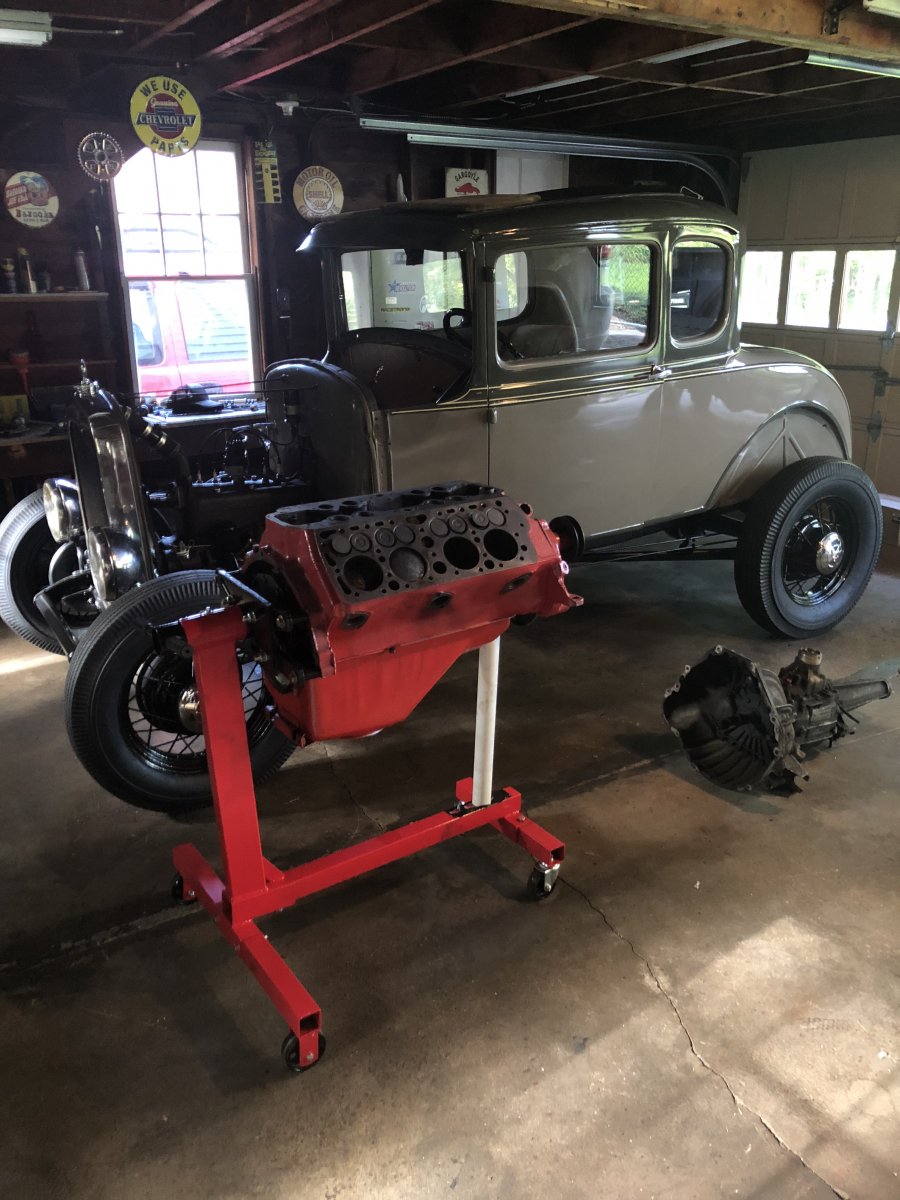

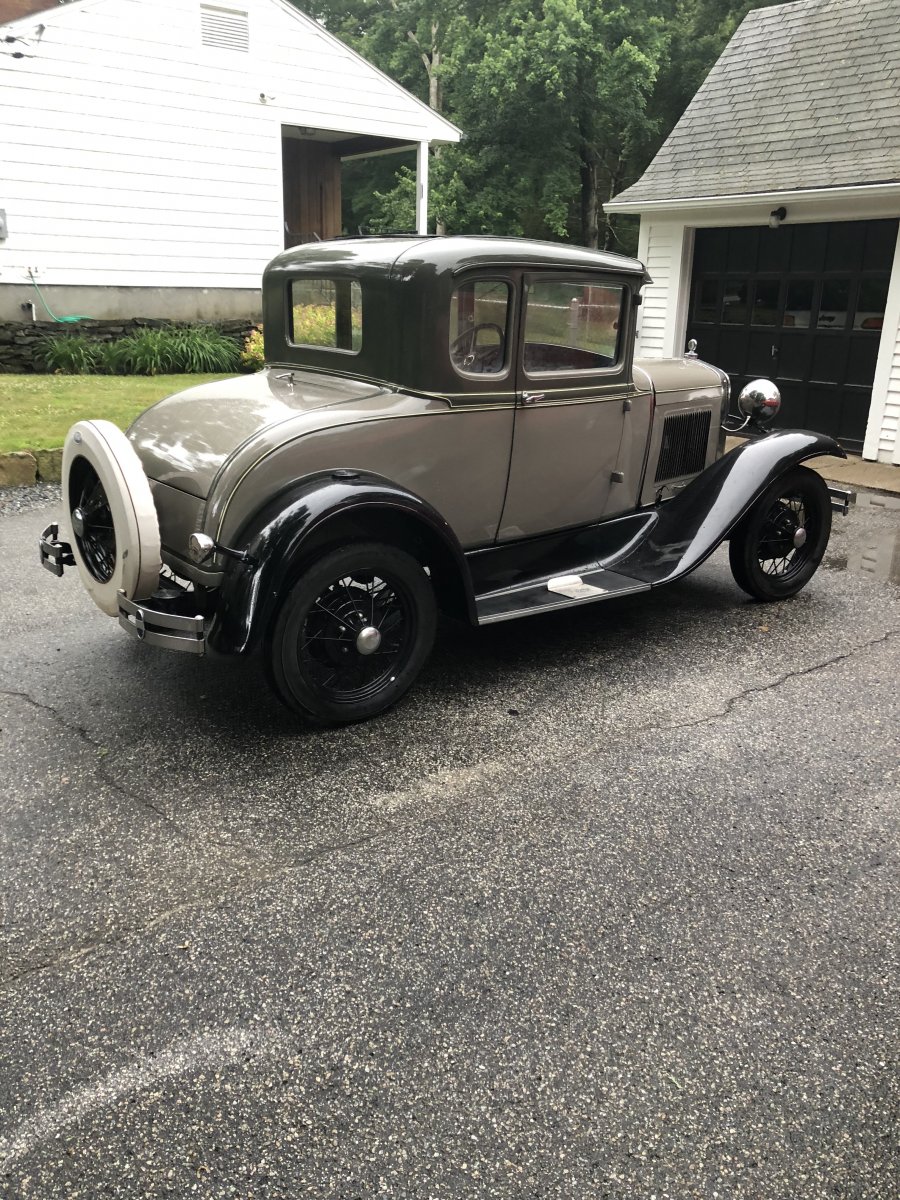

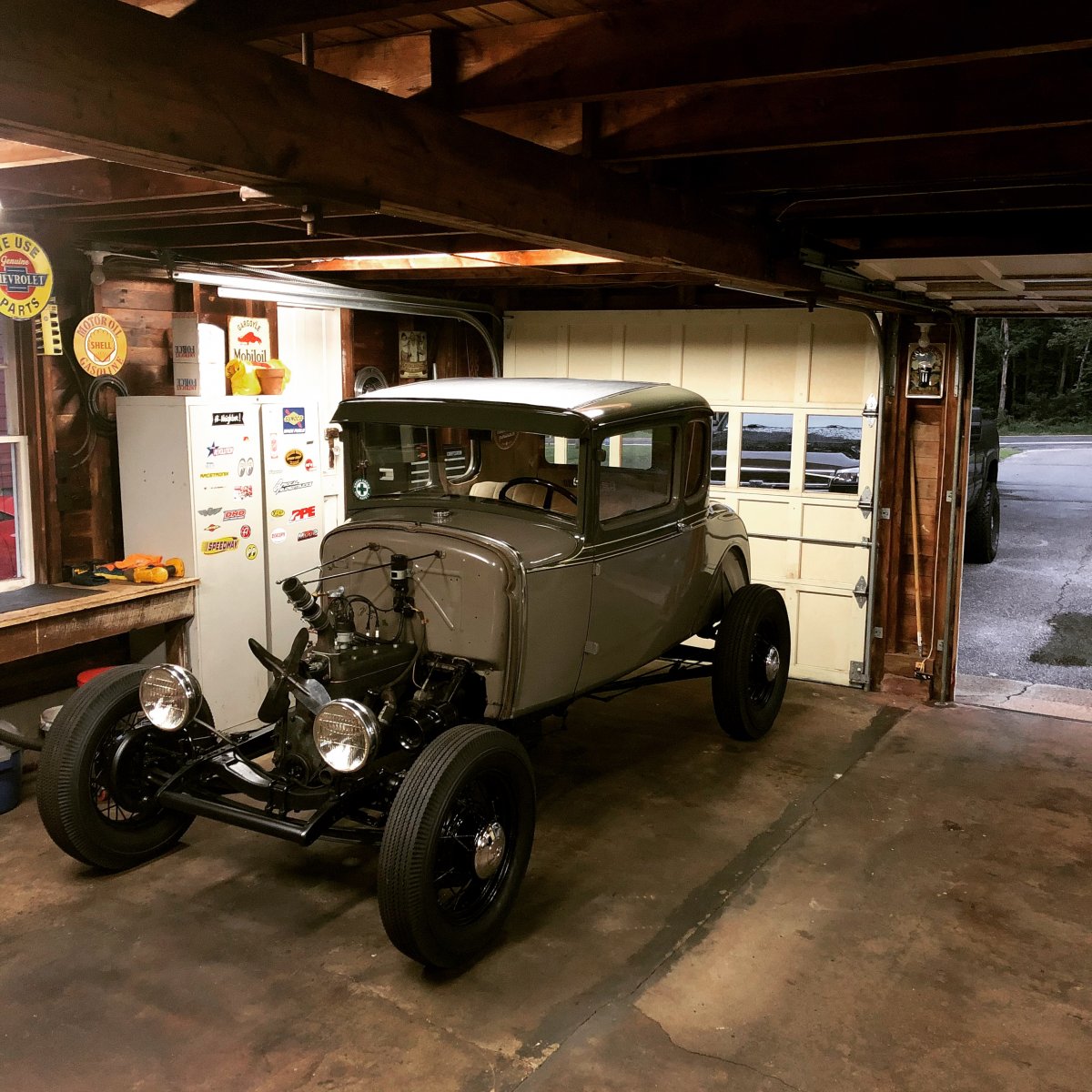

    FFD82031-83D0-49F6-85EE-D58546E4FEBC.jpeg BF828962-BE32-436E-B50B-00E8C3018554.jpeg 9F55A8F7-68CF-425F-8F6A-E93FCD59EAA8.jpeg DA3A0F4A-D59C-4A8A-A289-D6C23CB1D3AC.jpeg FFD82031-83D0-49F6-85EE-D58546E4FEBC.jpeg BF828962-BE32-436E-B50B-00E8C3018554.jpeg 9F55A8F7-68CF-425F-8F6A-E93FCD59EAA8.jpeg DA3A0F4A-D59C-4A8A-A289-D6C23CB1D3AC.jpeg After a few years of wanting a model a coupe I finally got my hands on one. (Would’ve had it sooner if I didn’t have to buy a ring and pay for some of our wedding) but you know how that goes. Anyway. Grabbed a 1930 Model A coupe, bone stock and running. Originally I was going to keep the fenders on it and just lower it to make it look a little gangster’ish coupe but after sitting in it and then looking at it the fenders weren’t for me. After removing the fenders and wheels a fella local to me needed them to put his recently purchased 30 A back to stock since his did not come with fenders or wheels. So for the purests out there I took a stock car to hotrod but in return put one stock car back on the road. So that makes me a little happy in the end.

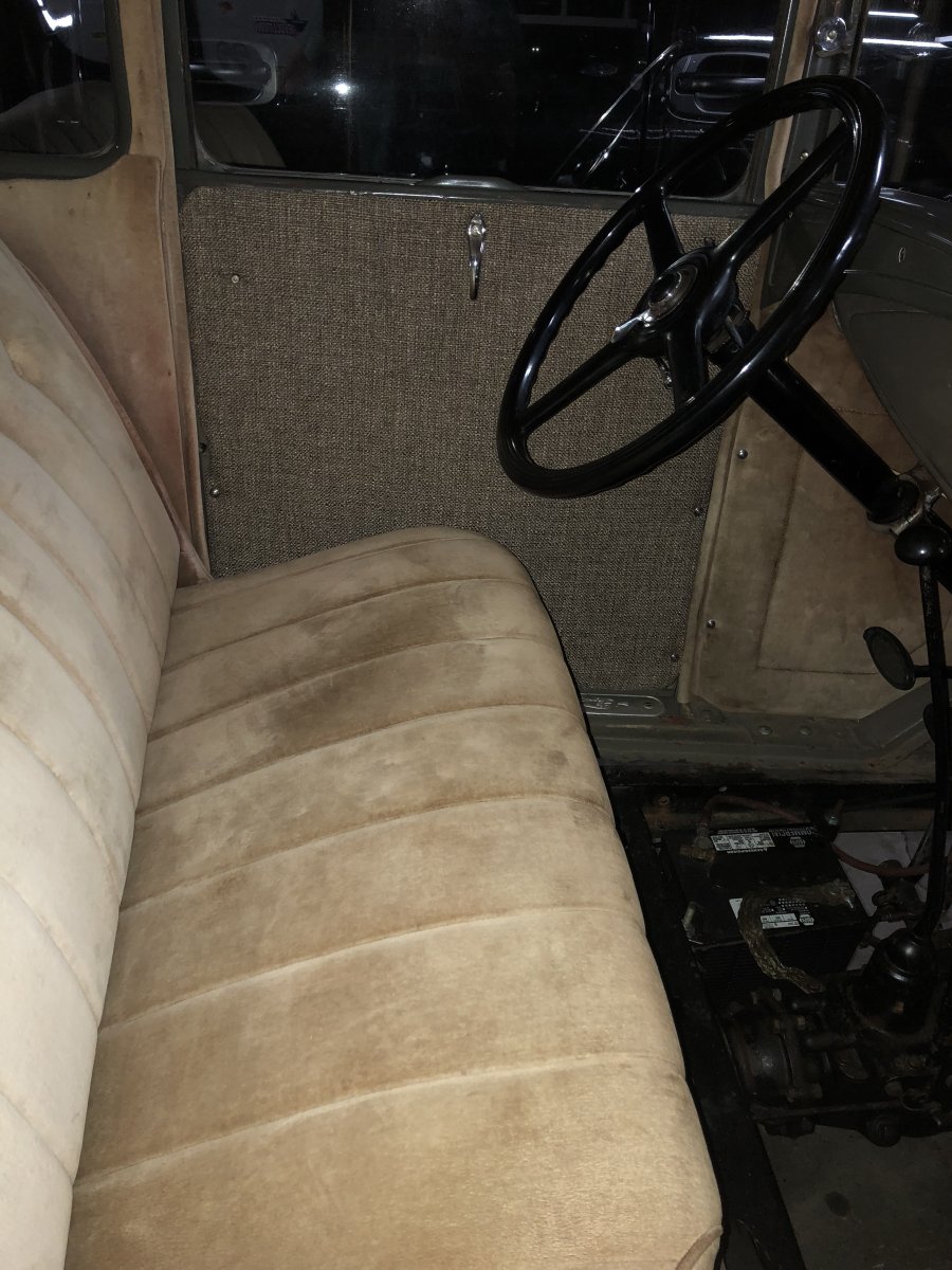

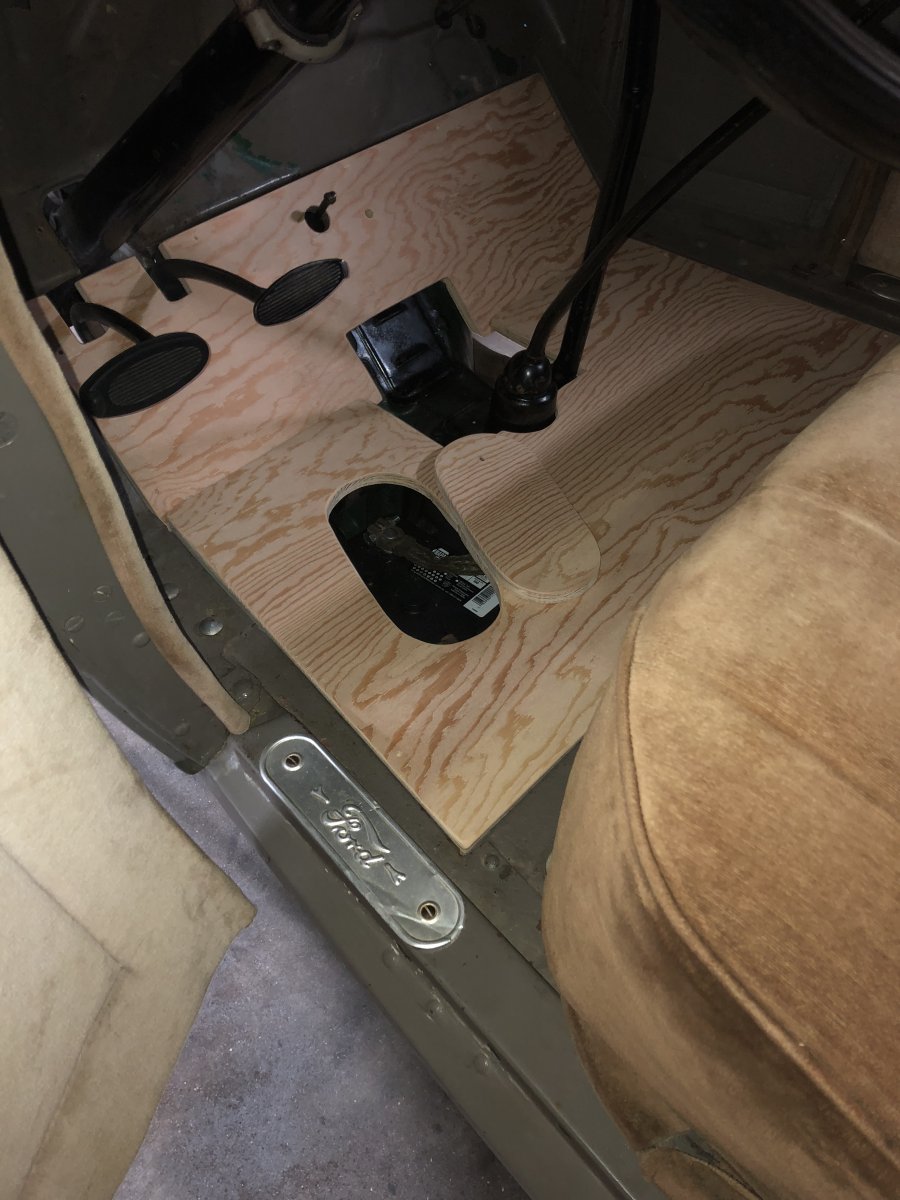

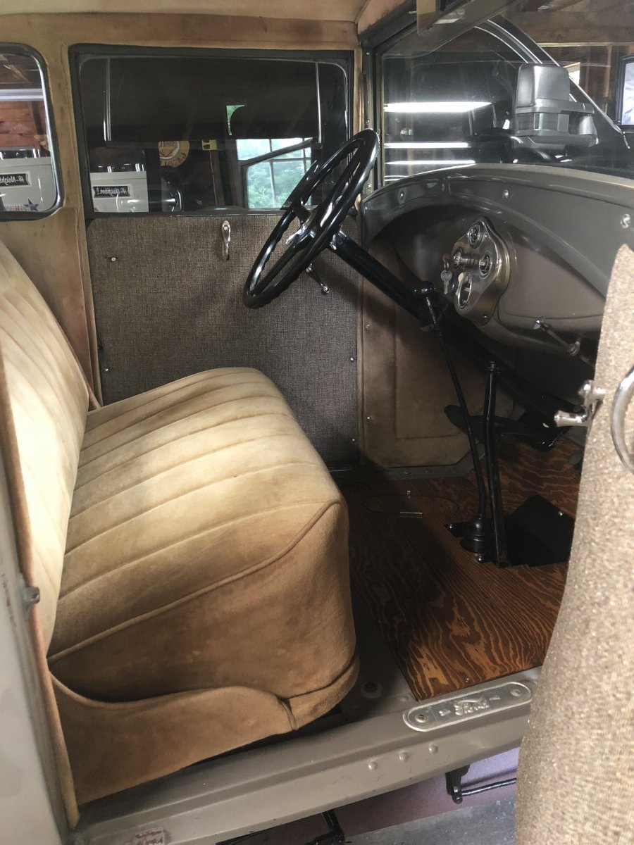

    After stripping it down it was on to the interior. The wood floor was rough, door cards and kick panels tattered. Made up some new kick panels and door cards. Reused the original fabric off the kicks but the door panel fabric was too far gone. So I improvised with some fabric and foam from the local store.

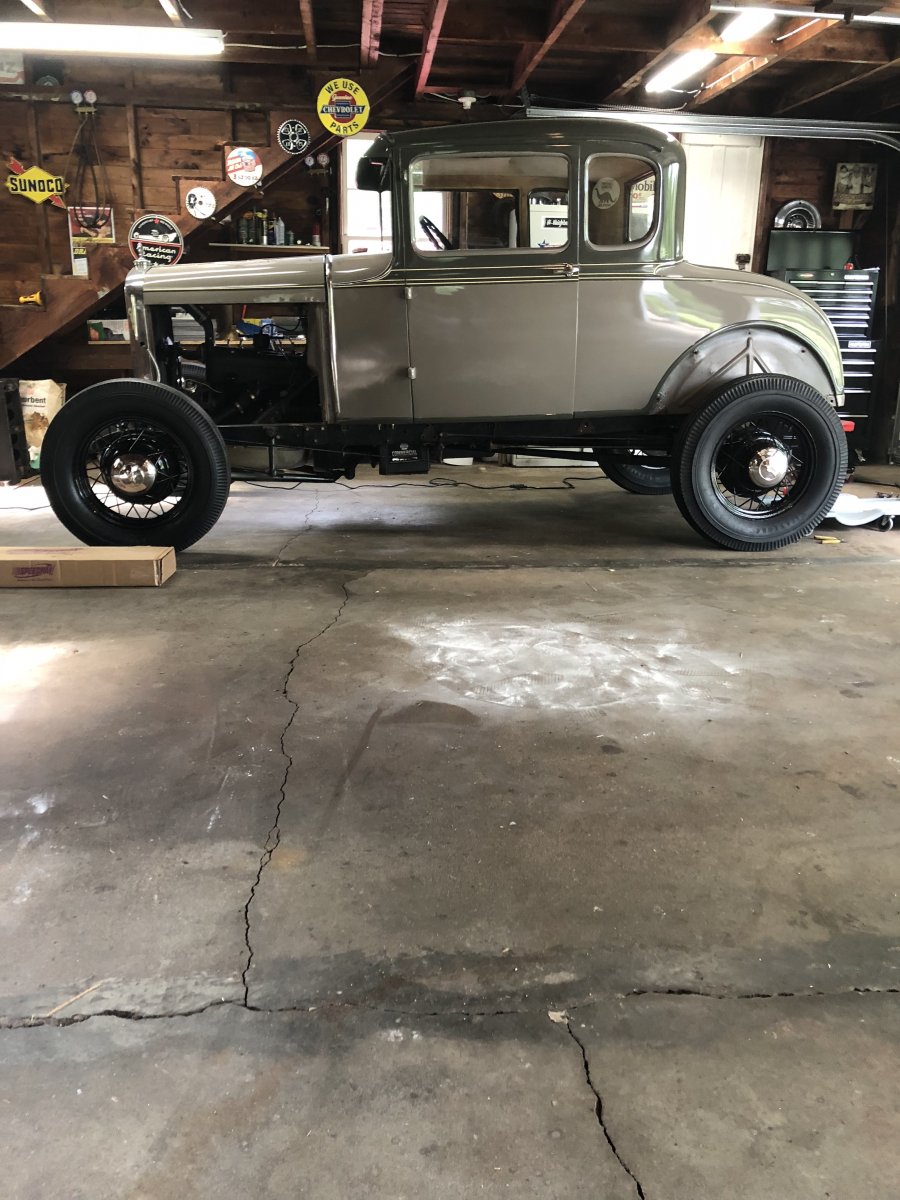

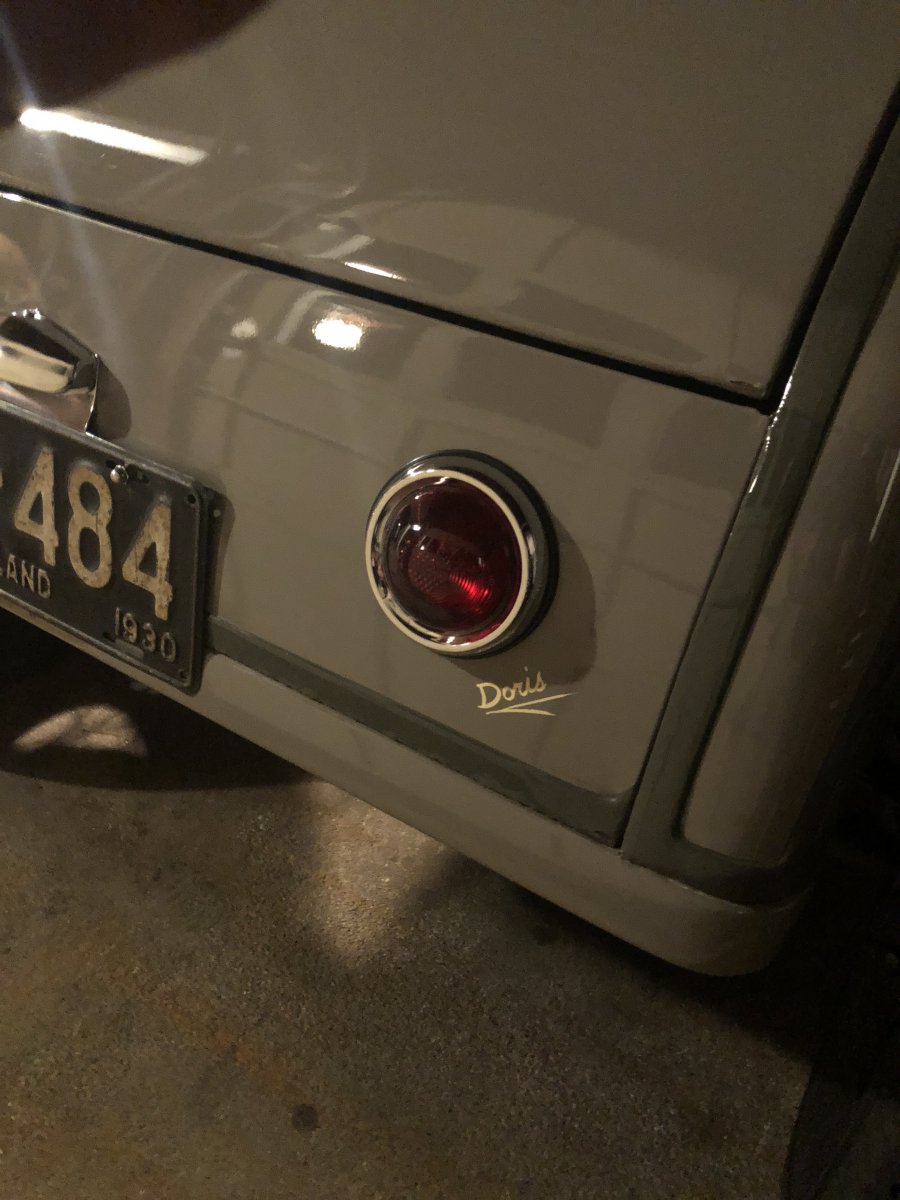

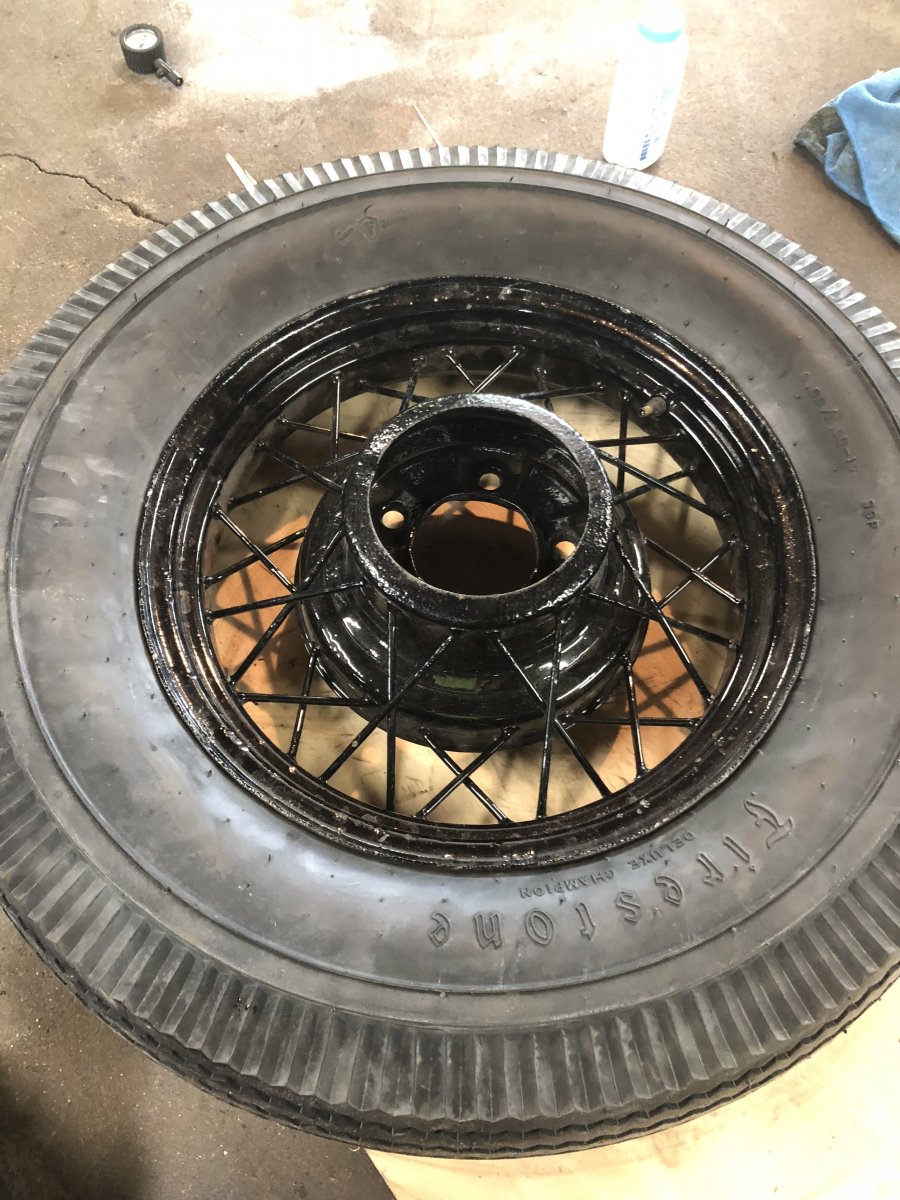

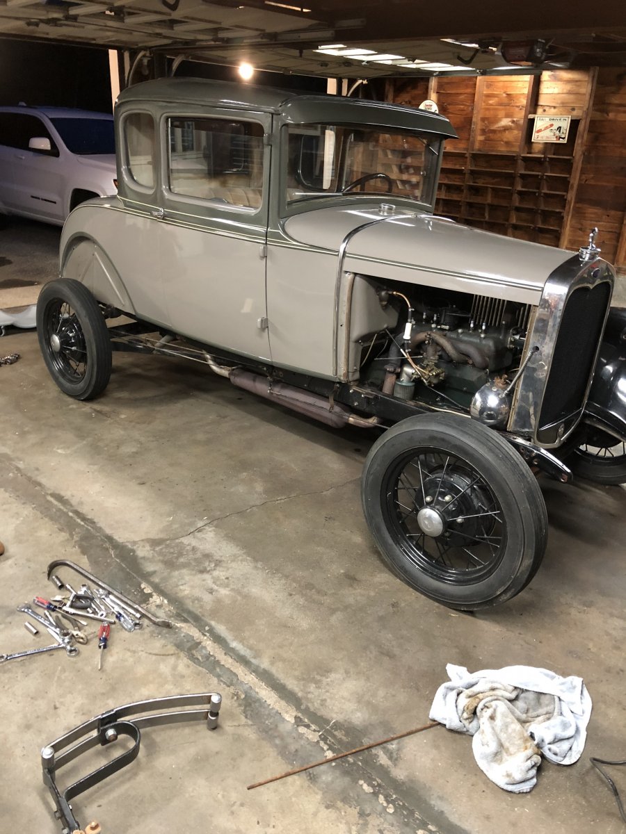

    Now we’re on to lowering the front. Purchased a reversed eye leaf and took out the 2 and 4 leaf. Ride is pretty nice. Found some 33/34 17” ford wires on Craigslist for 20 bucks! Bought some centers for hem and bias ply Firestone’s. 600s out back and 525s up front. Mounted the tires myself with a tire bar and i was off. In the rear i went with a set of 1950 Pontiac taillights. Hood sides were off and got some straps to keep those tops from bouncing around too. Cleaned the frame up a bit also. Driving it was a bit of a chore so I got in contact with FSI for one of their distributors. Popped that in, wired it and timing it runs great and a lot smoother. Changed plugs and all fluids throughout the car to get in in shape. Headlight hiboy mounts were tossed on there. Made a little cork screw gas line while I was at it.

    Sorry for all he posts but I’m just catching up where I’ve been and this is where we’re at. The gas tank was slightly leaking. Guess where. Steering column mount. Owner before me had about 5 jb tank weld patch kits on it and still leaked. Time to get it done right. Got Bills epoxy tank kit to get this thing safe and no more smell of gas in the car. Also in doing that while it sits with cleaner in it the king pins were worn to hell and gave a death wobble while coming to a stop sometimes. So that’s getting in check with a whole kit and bearing kit. Found a nice complete 8ba Flathead out of a truck also.

    Gas tank is sealed. Tested it for a few days with gas sitting in it. No leaks so far. Tomorrow that will be going back in.

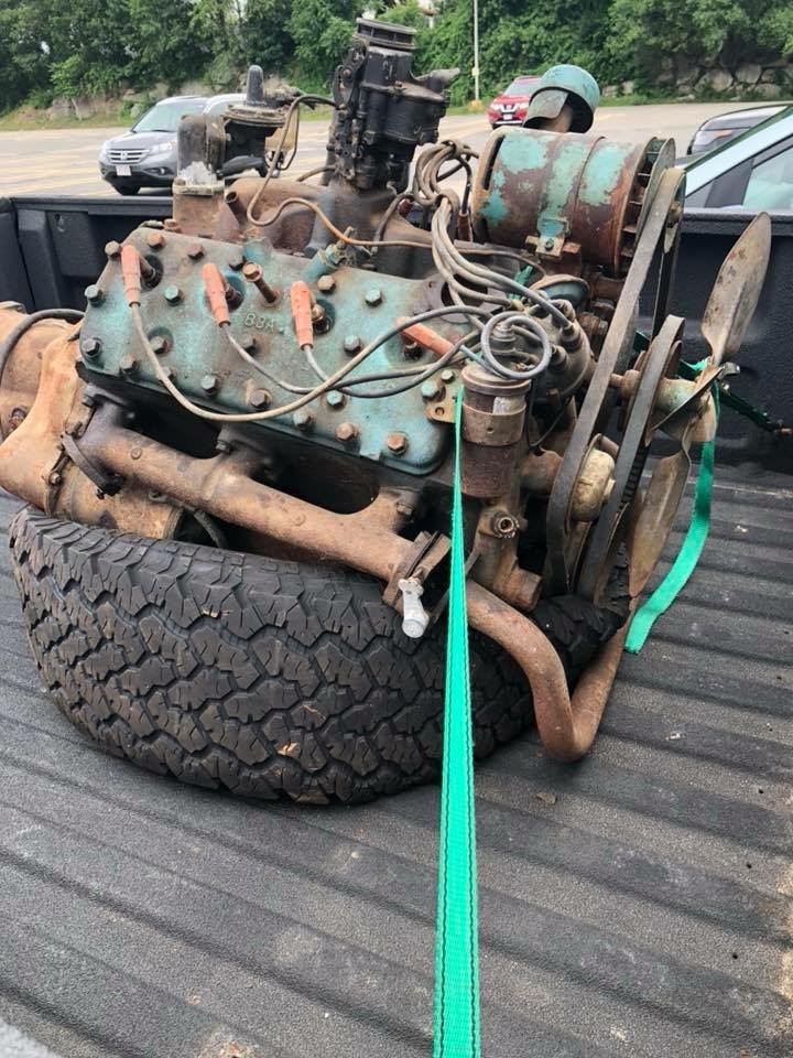

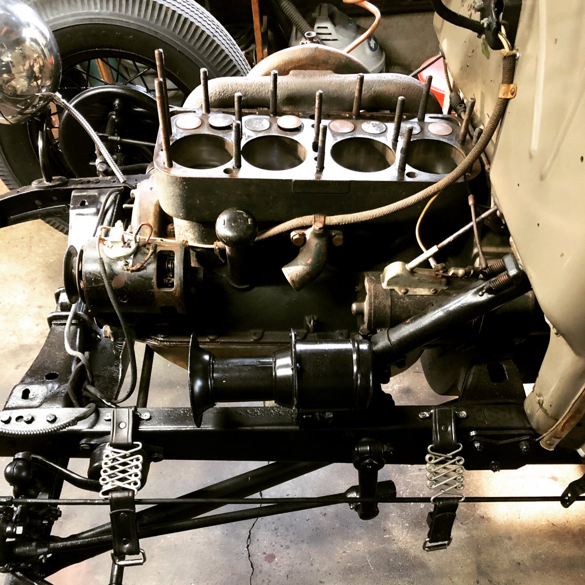

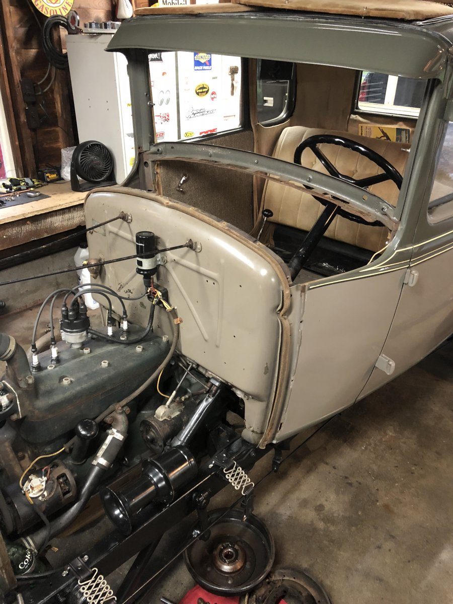

    Tore down the 8ba I got and the pan rails are cracked on both sides. Water must’ve froze in there sadly. But on a good note a great car friend said he had a Flathead in a storeage bin. Got it for free. I didn’t know what to say to him and just kept thanking him. Short block only but is in great condition and spins over nicely. Still going to tear down magnaflux, pressure test and freshen it up.

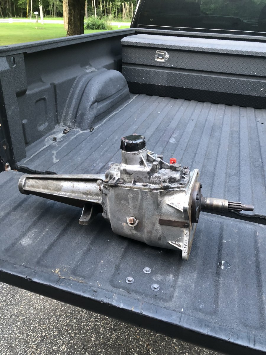

    Picked up a 87 F150 4speed OD also. RTS BU 26% overdrive. So that should be fine for the rest of the year with the 4 banger.

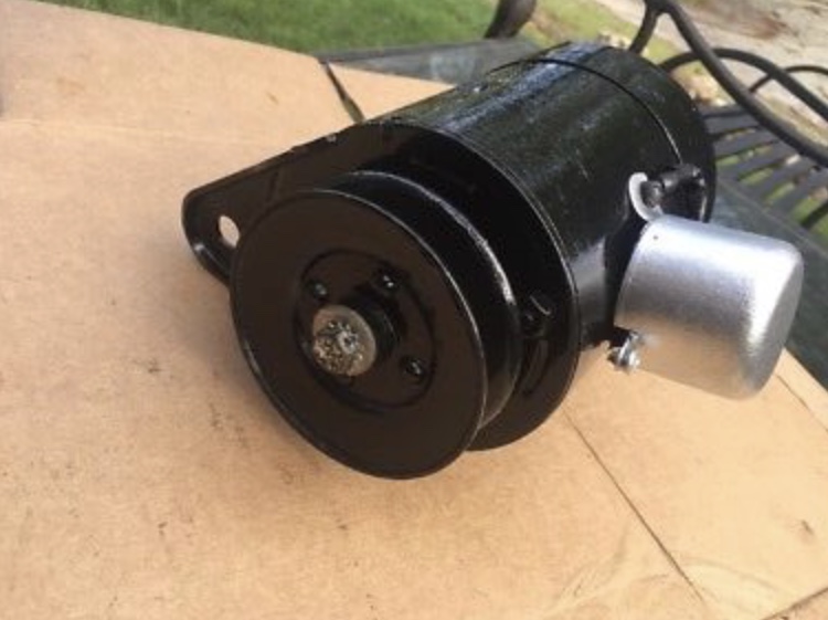

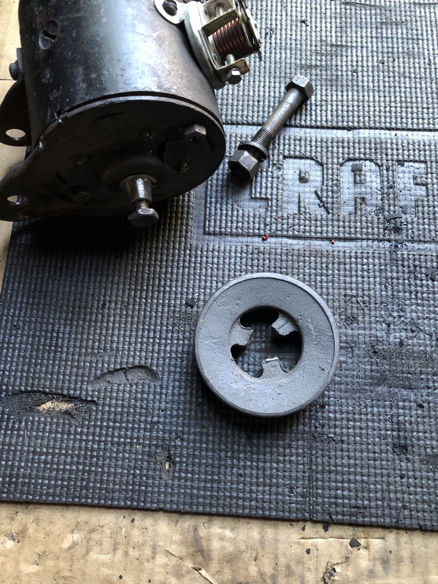

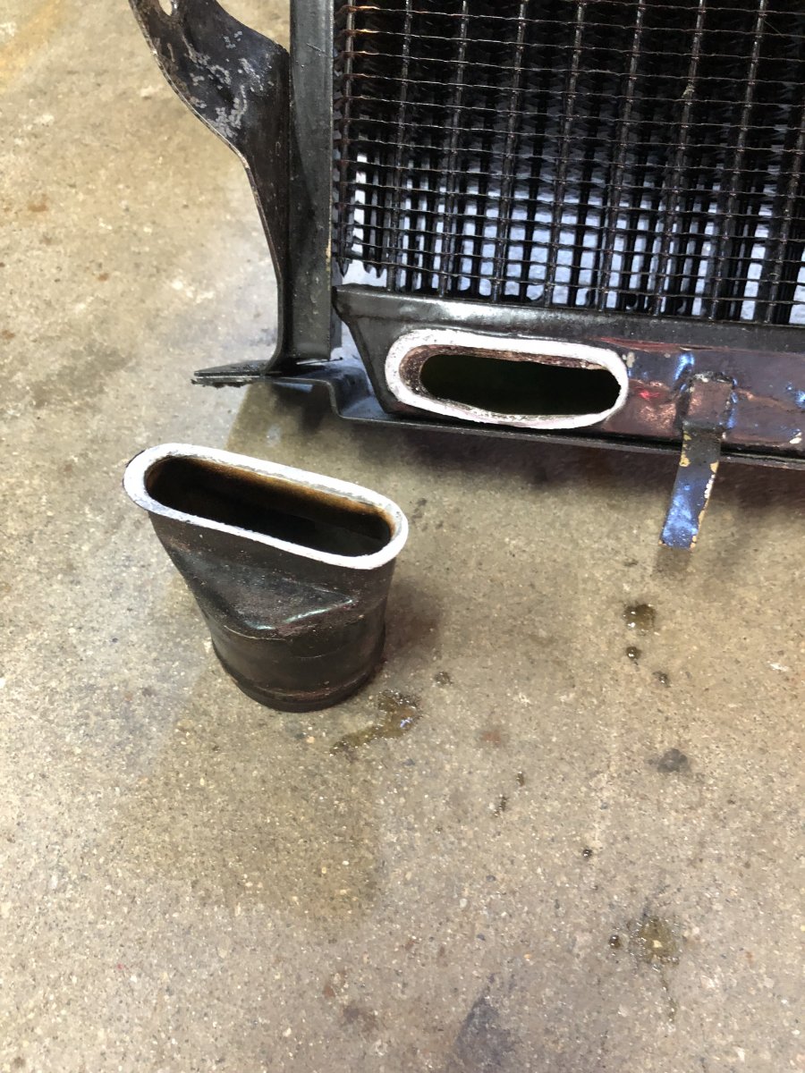

    Little update. Car was all together but was overheating a bit. Got rid of the trash radiator the previous owner had in it. Also for giggles since he gave me an extra head gasket I tossed that in too. Sure enough who ever put the last head gasket on was not curtious of keeping the copper flat. Some ends believe it or not we’re folded under and tighten down with the head. Also 2 cylinders were drinking coolant. After the radiator and gasket were in the car felt a lot more crisp and faster. Then the generator locked up and sheared the pulley off. Got a rebuilt one from a fella in M***achusetts and was off again. We did a 70 mike round trip so far and hit 60mph on a level area at one point.

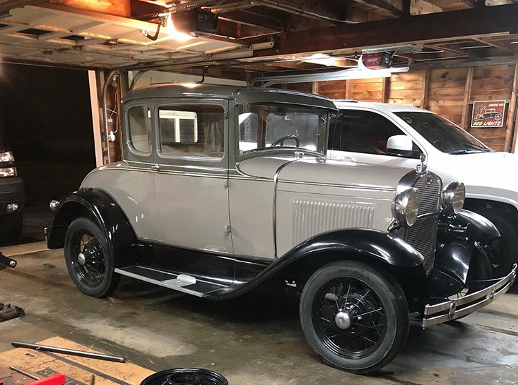

    One more thing I forgot was my friend came by and pinstriped the coupe. We peeled off the antique white sticker stripes and decided to go with red pins. It took some time to decide but he said “trust me” and I love it.
