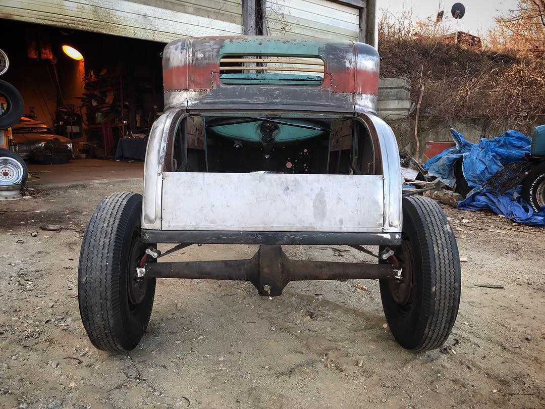

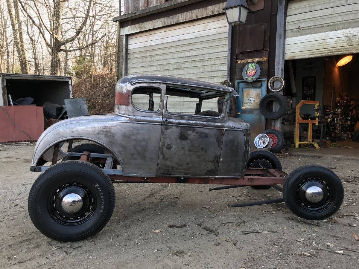

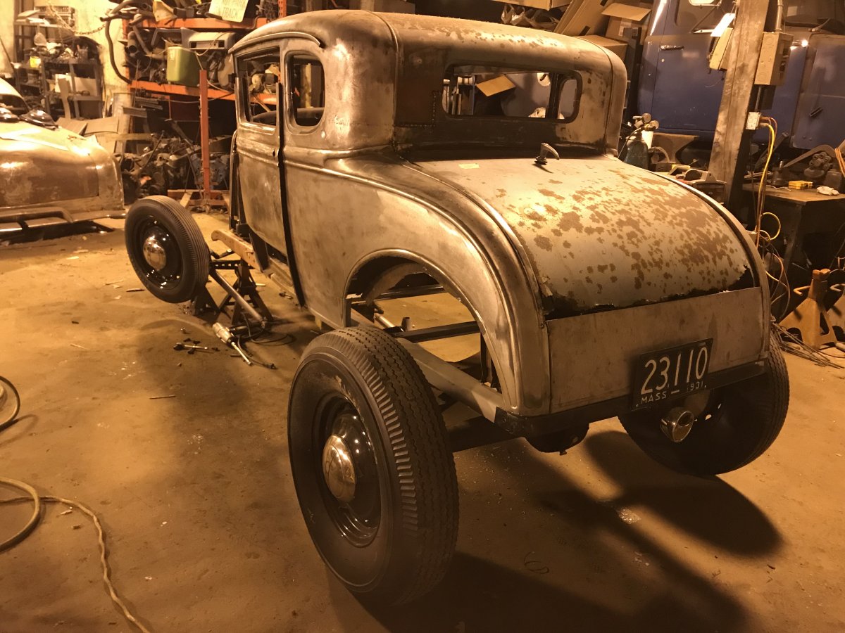

    Just waiting for the new tires to come in so I can get the stance right. I will most likely be stepping the rear up some. Right now I just have the reverse eye T spring in the rear. Not quite low enough.

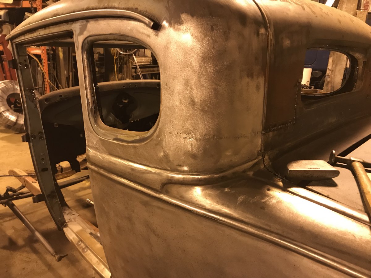

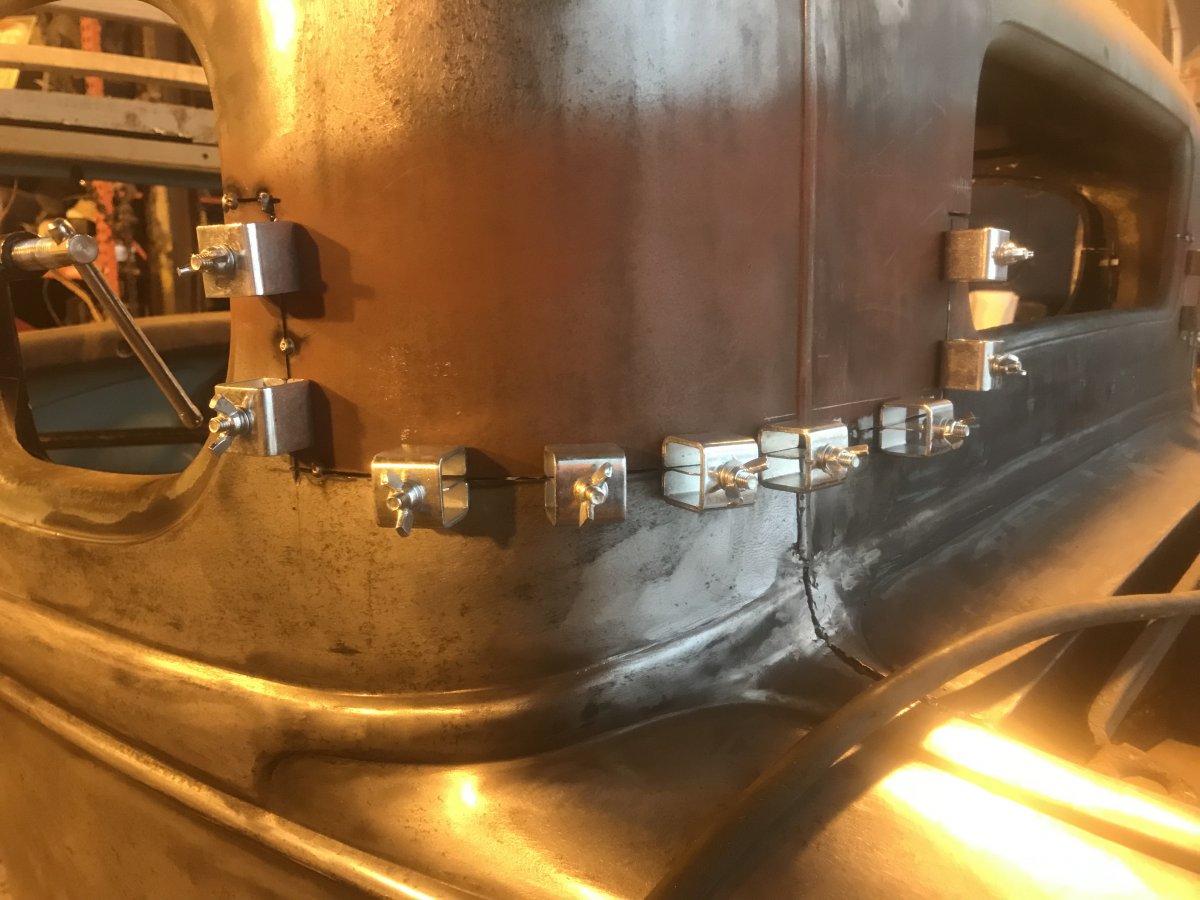

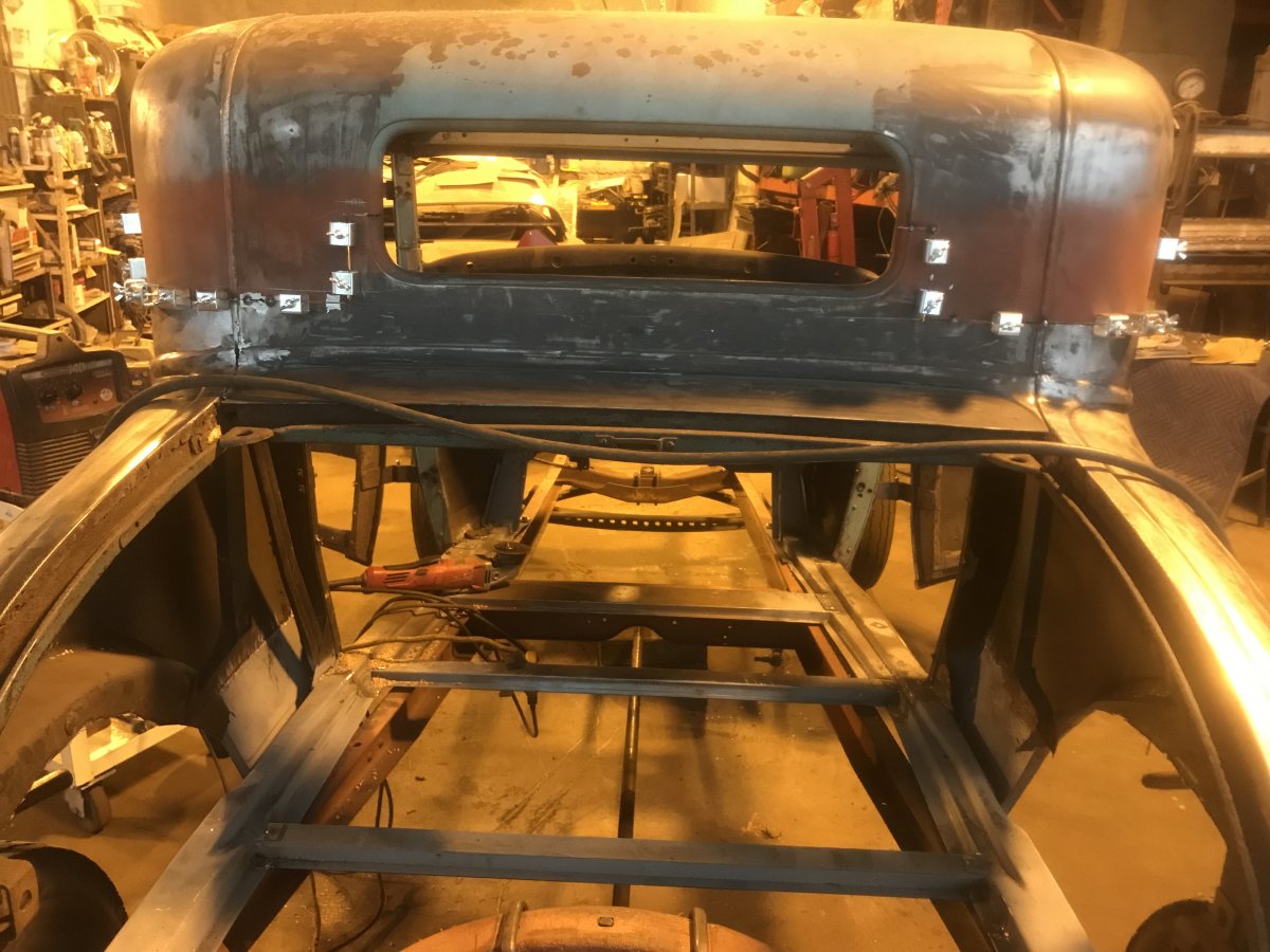

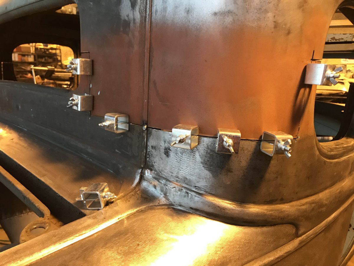

    Started clamping and tacking today. Everything’s fitting up pretty nice.

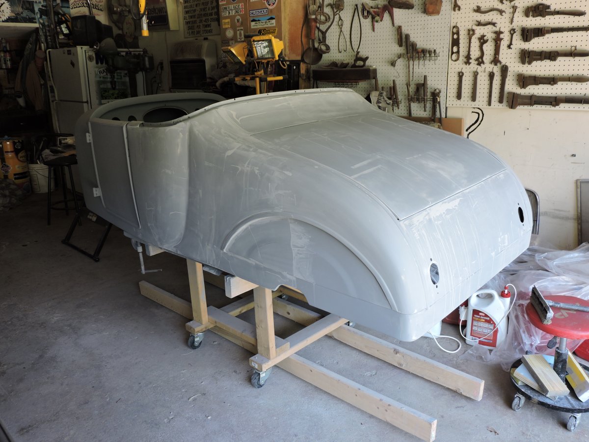

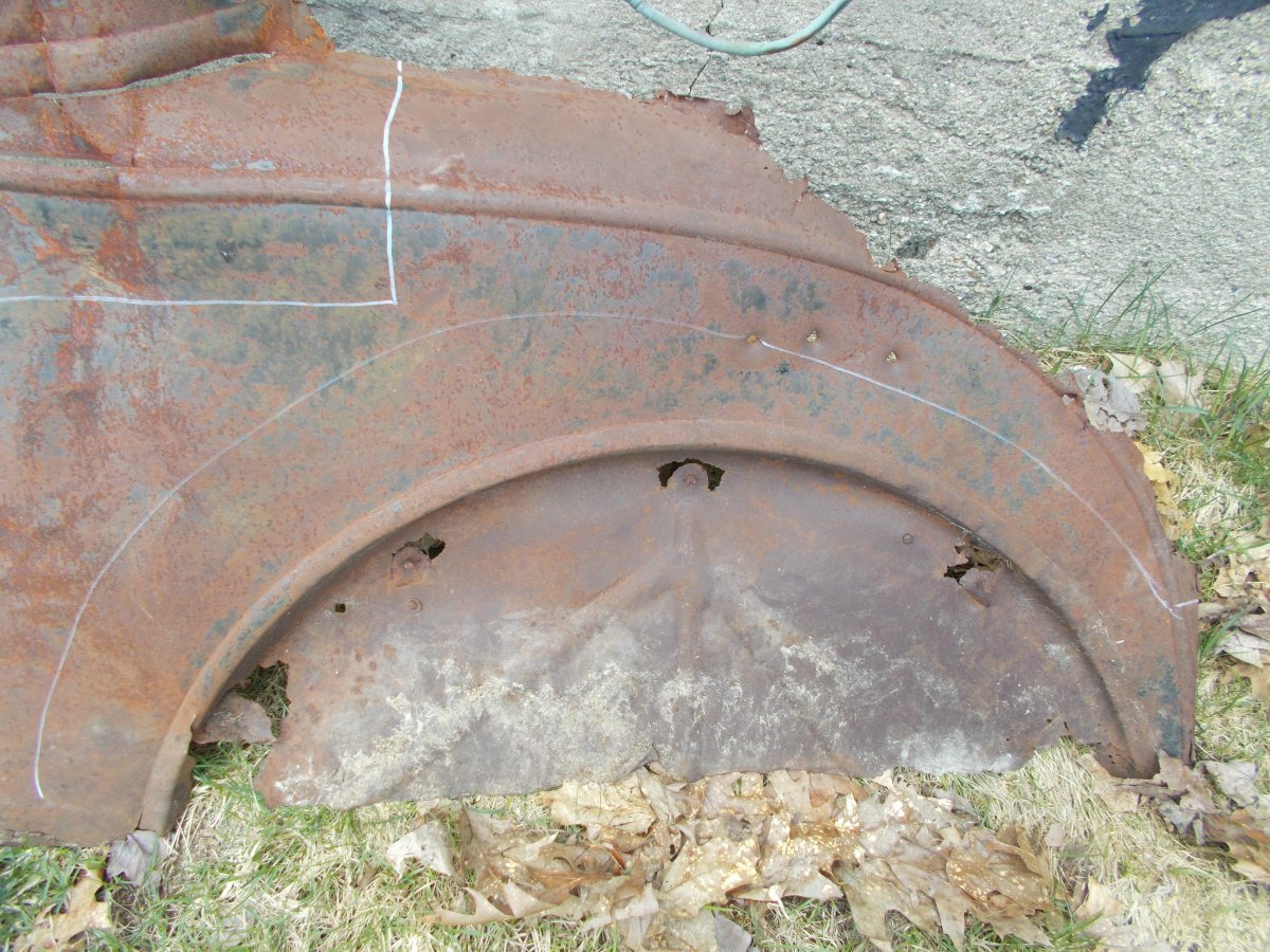

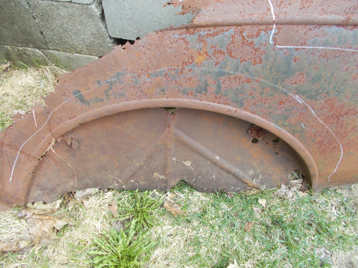

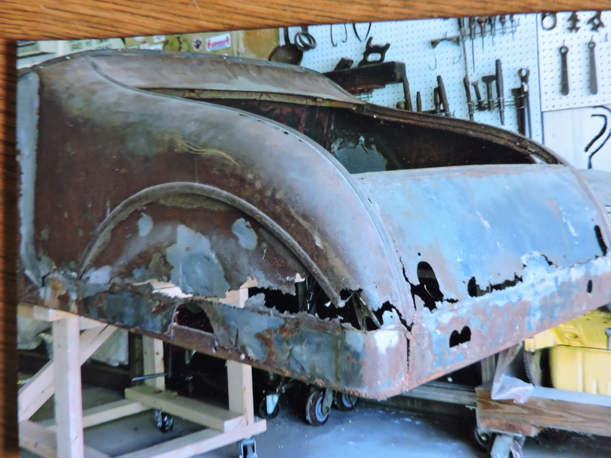

    That's probably your best bet. Mine was shot full of bullet holes. Here's how it came out. DSCN1124.JPG

    Ya for sure. Your car is looking awesome! Nice work.

    Thanks I got it on the road this spring. Those guys in the west don't know what rough really is. We have to build from air !

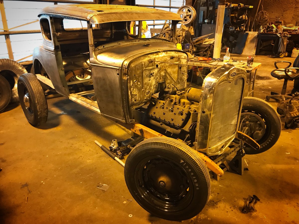

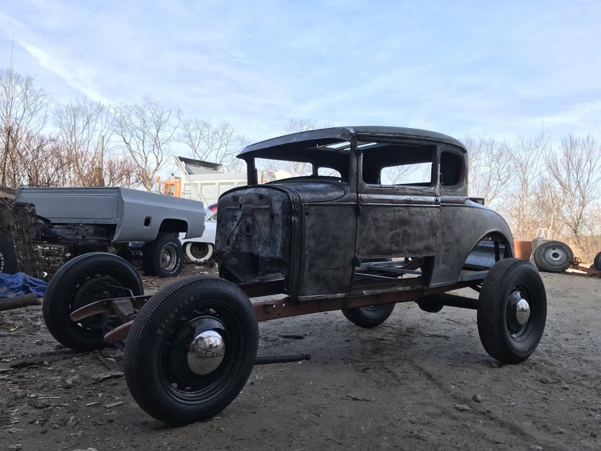

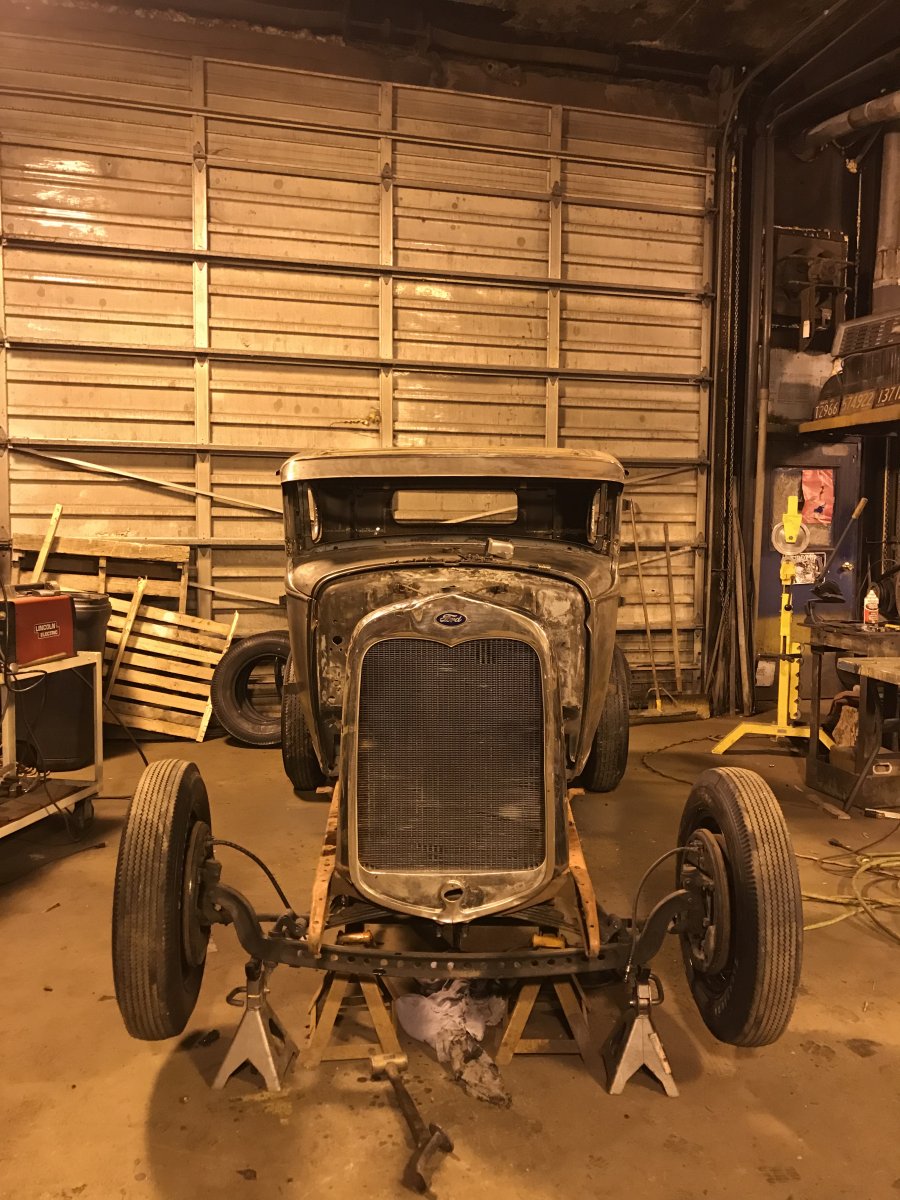

    Rolled outside to see what it looks like with some wheels and tires I borrowed from a friend. Thinking a couple inches lower out back and a slightly bigger front tire. These tires are 7.50s and 4.50s.

    Yep to both. Ever think about a slight channel ? Like just the depth of the frame?

    Ya I don’t want to channel this one at all. I think I’m going to run aprons though

    Out west we have big beetles called Stink Bugs that run around like that. Worser news is that rake increases with the weight of the engine and front stuff. Have you checked the load limit on the little tires you expect to use? That alone can void your insurance if they're paying attention and a chopped coupe will definitely not get a pass. My experiences in Mass won't expect anything else. Good Luck: Fred A

    Those front tires are 4.50s. I’ll be running 5.50s and the back will come down a couple more inches once I get the right spring in there.

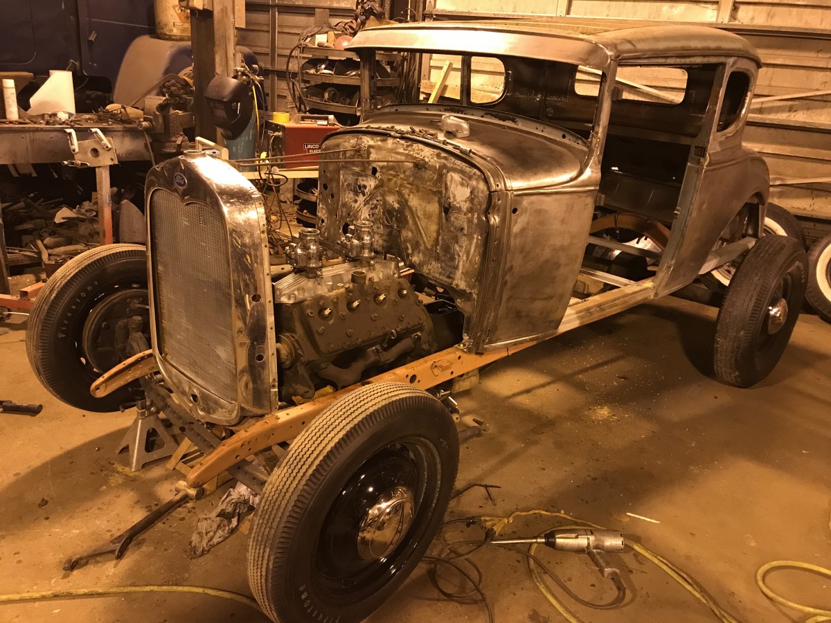

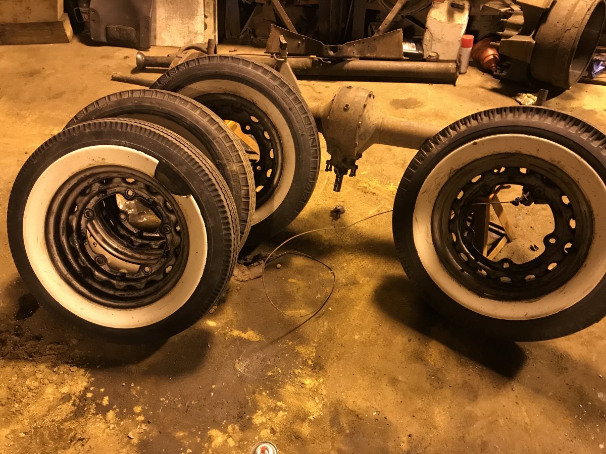

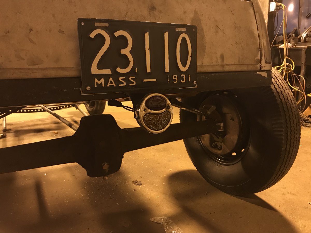

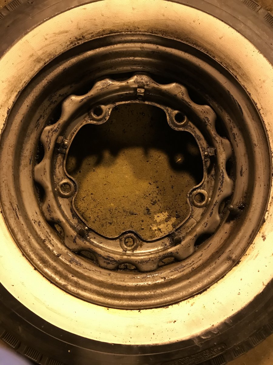

    A little more progress tonight. Tires came in. Got some 5.50s for the front so they’ll be a little bigger than the tiny 4.50s I used for mock up. Got the wheels all stripped and ready to go to the powder coater next week too.
    Been doing a lot of welding and grinding on the chop. Almost finished with one side. I also made a plate and tail light bracket. (Got sick of working on the chop for a little)

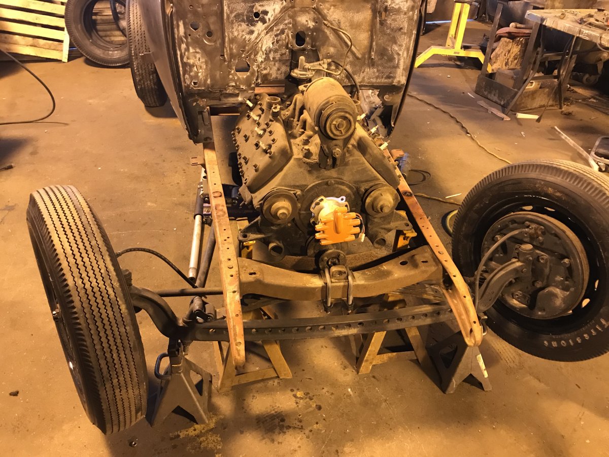

    from Monson MA
    So I got the engine and trans mocked up. Going to make some mounts and get the ‘32 k member fitted this week. Wheels and tires should also be good to go this week along with the brake drums (Getting them turned).
