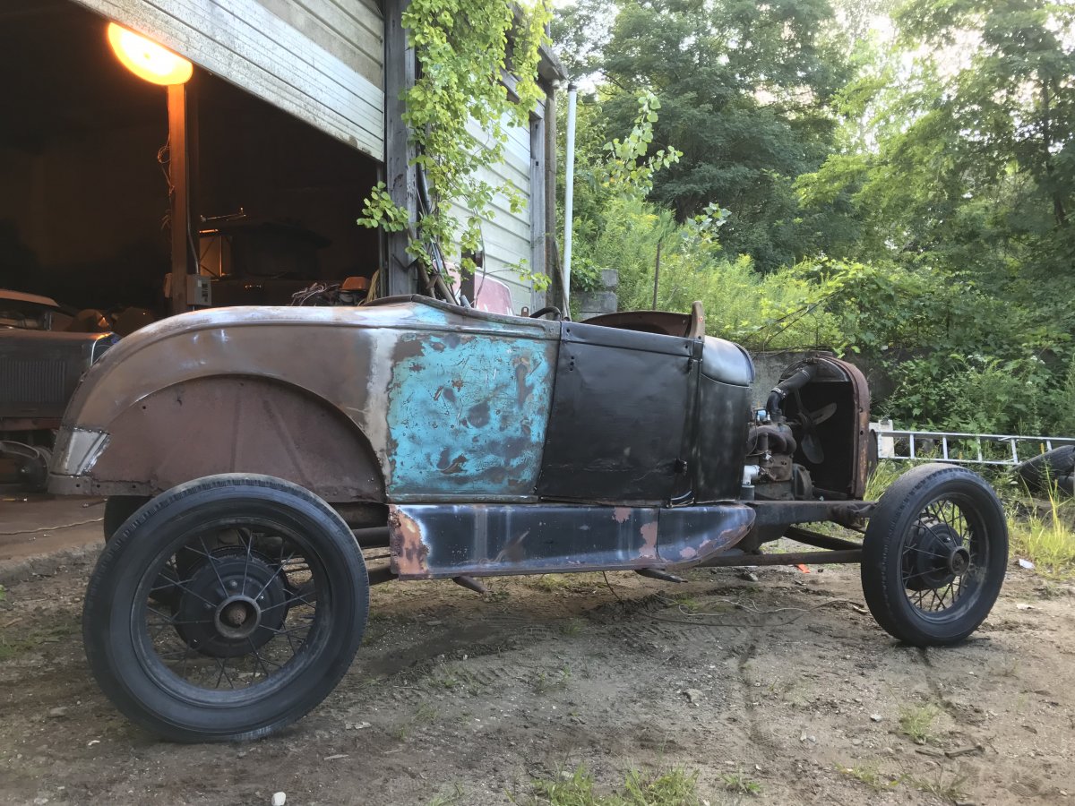

    Thanks man. Going to put a pipe going straight back off the headers but I do kind of like them like this haha
    Thanks man. I’m still undecided. It’s going to stay bare metal for a while. I am leaning towards something like the body was when I got it though.

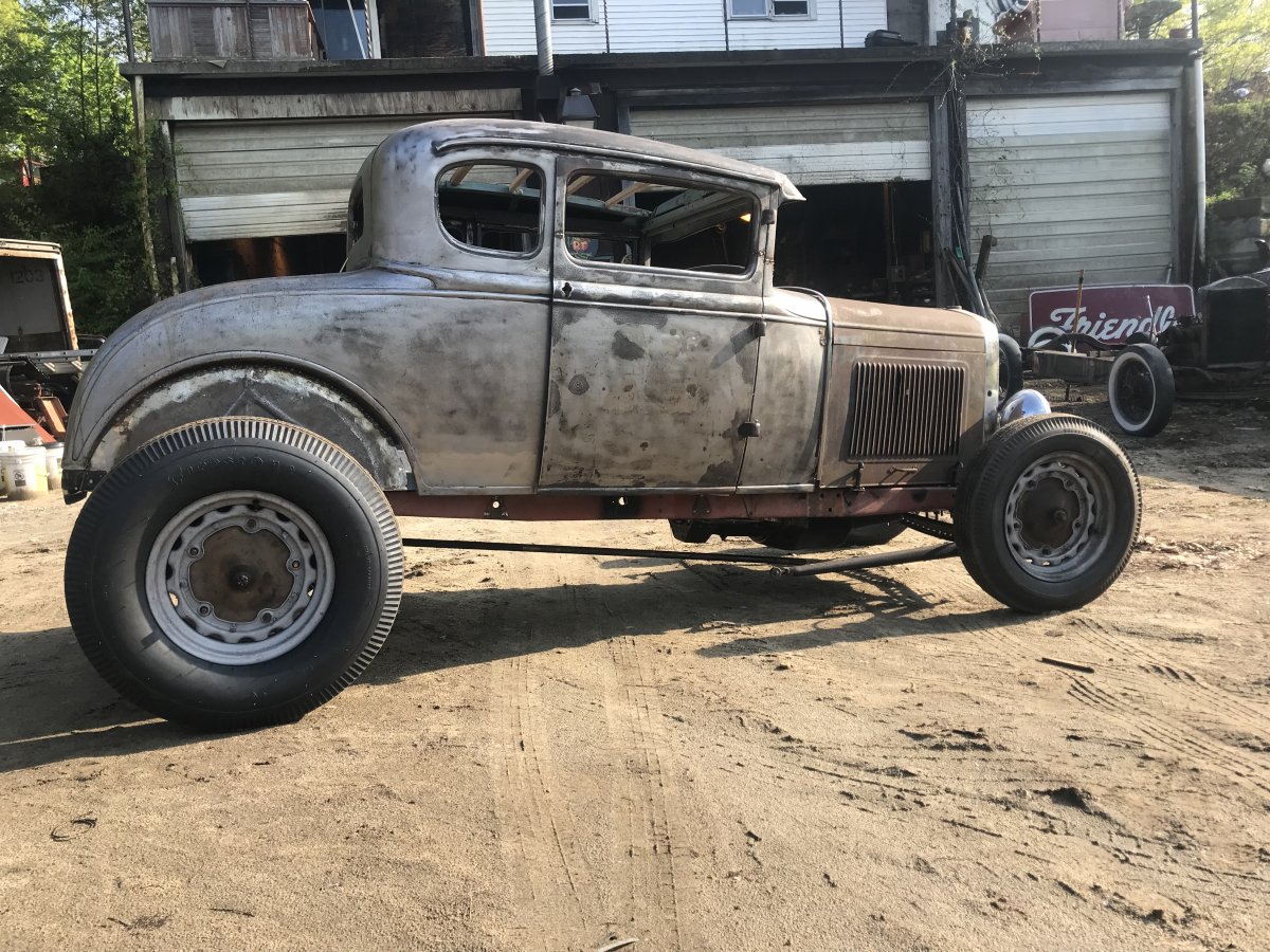

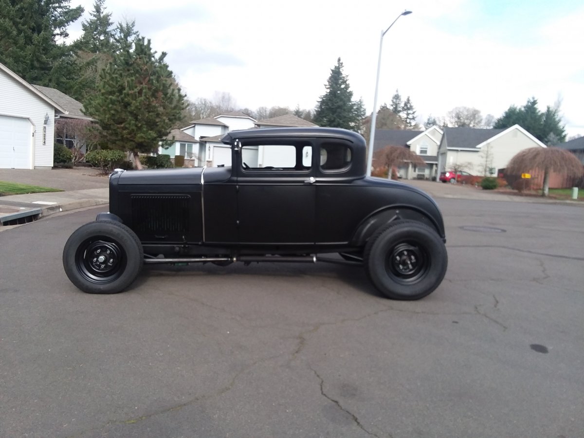

    Looking good. I suggest you box the frame.
    It really stiffens it up and you won't be sorry you did. Here's a pic of my coupe.
    All 40 Ford running gear and a 276 Merc

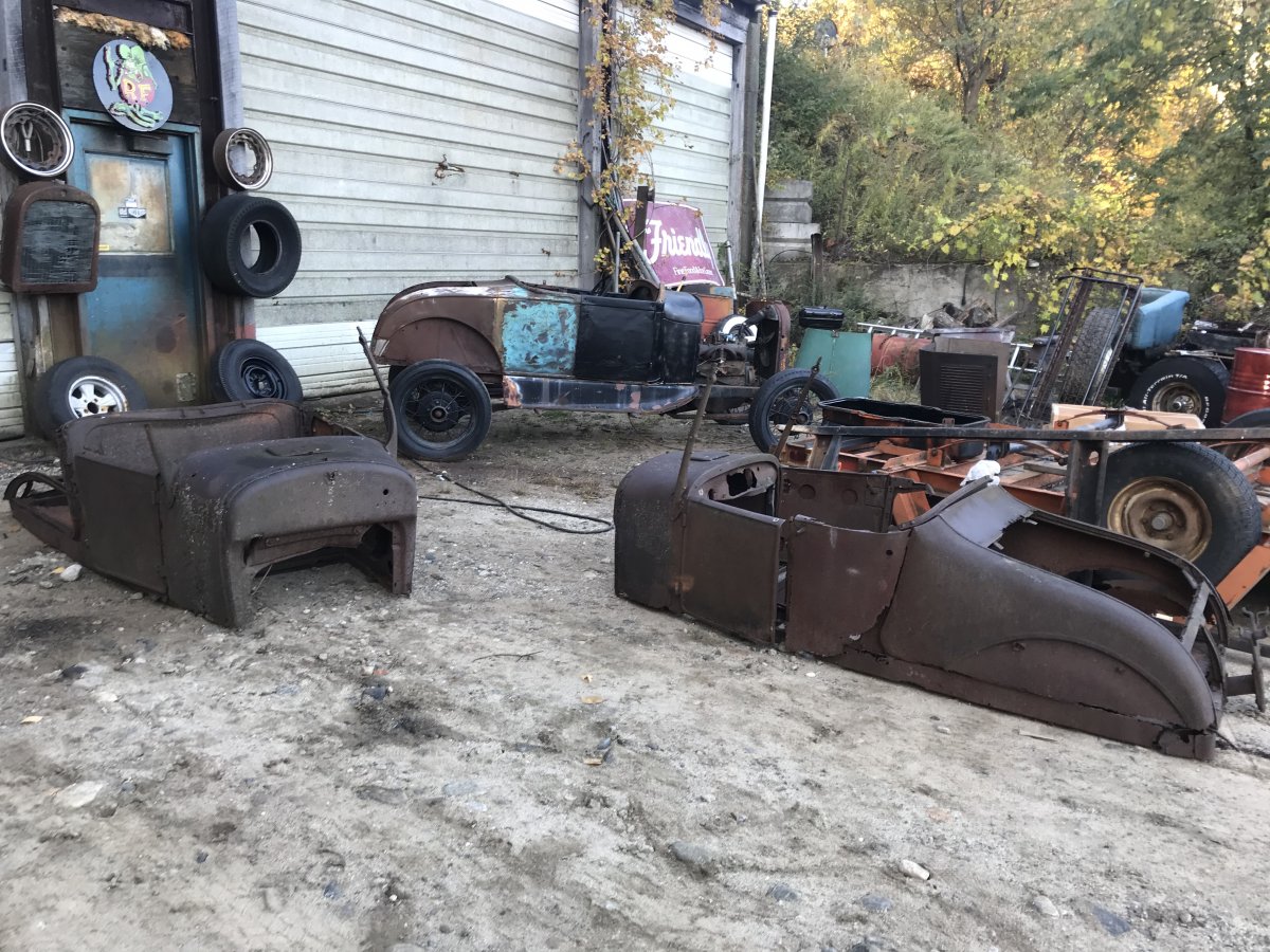

    I've had this 31 coupe body in my shed for 5 years, my plan is to graft the two together and start my own build. IMG_3792.JPG IMG_3793.JPG

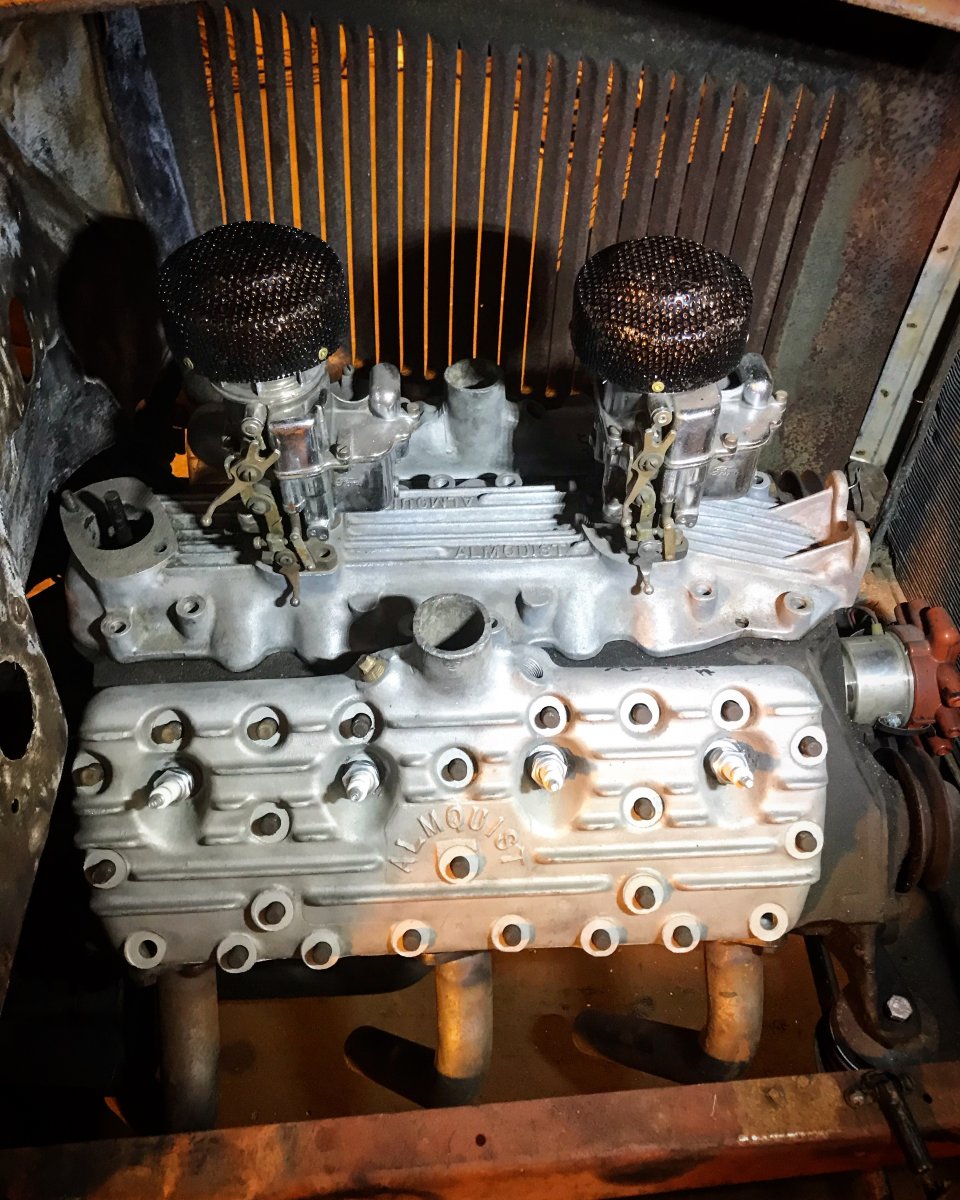

    Hershey was good to me this year

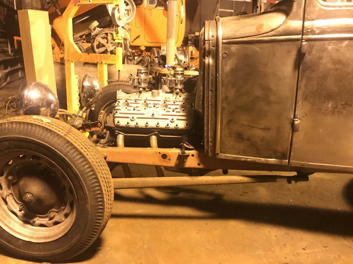

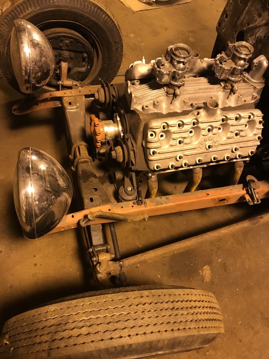

    Had to stick the heads on quick

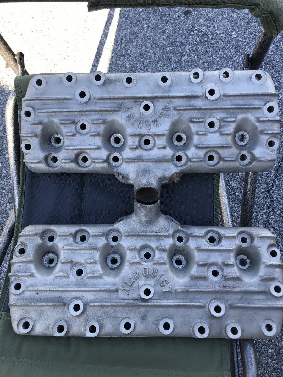

    Just read your whole thread. You definitely brought that body back from the dead. The car looks really nice. Your seat looks great. I bet you don't have any shortage of work. Looking forward to seeing the car finished. You said you wanted heads to match the intake so congratulations on finding a set. I see where you said you pulled your steering column from a junk yard. Zero chance of that here in the UK. That's why I made most of the parts for my 27 T roadster and made do with what I could find and adapted it. Its that or spend an absolute fortune.

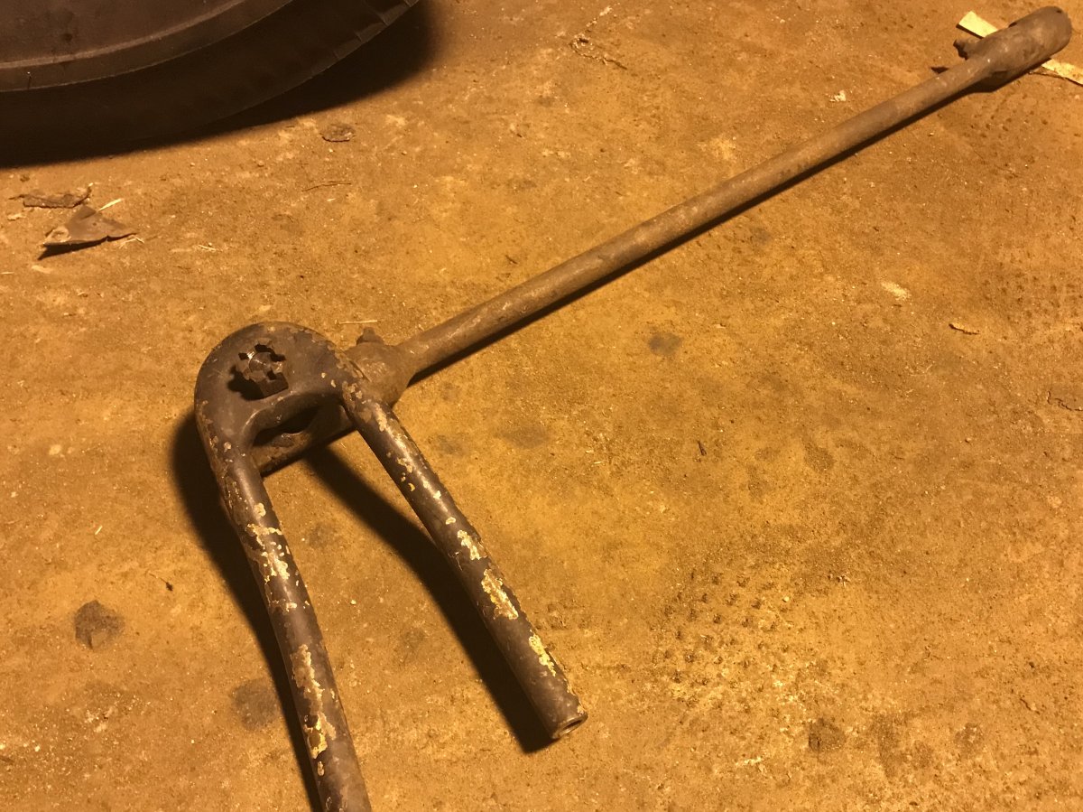

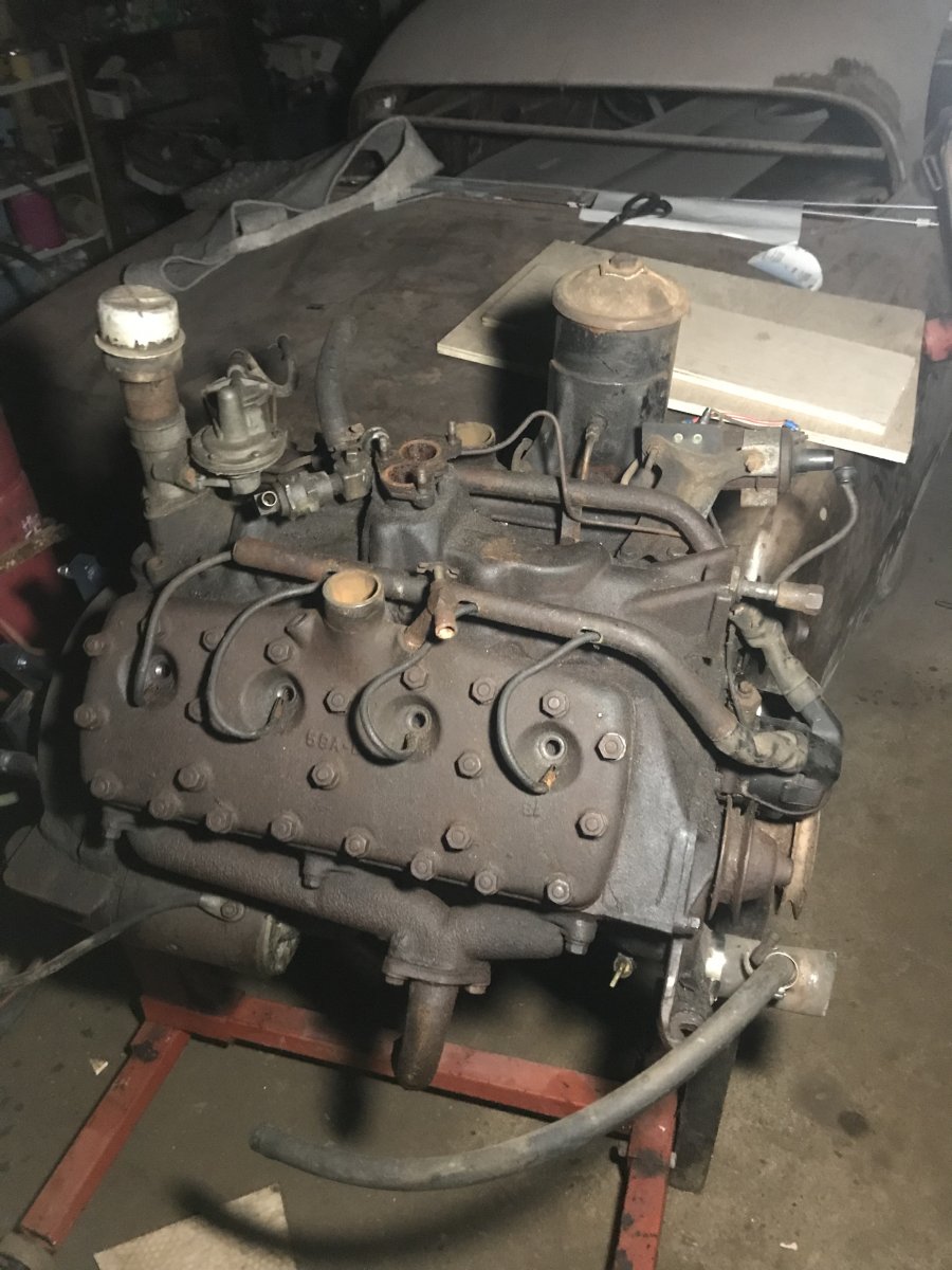

    Started working on the wishbone mounts. Going to have to pie cut them a bit but getting closer. Also started messing with this crusty old steering arm I picked up at Hershey. Bought another 59ab motor too. Thinking about rebuilding it over the winter as I’ve never gone through a flathead before.

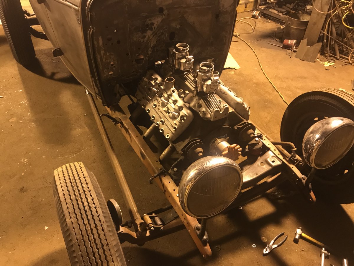

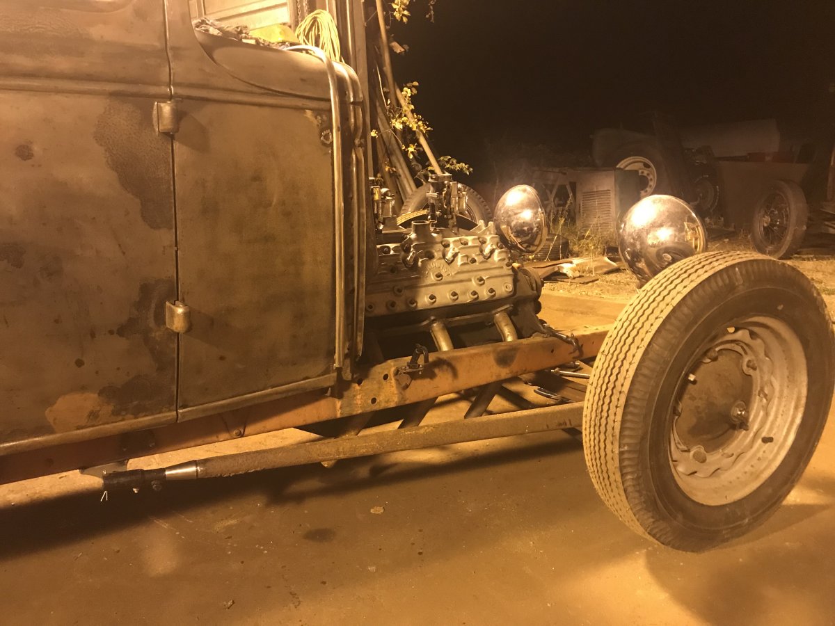

    Got the bones pie cut and the caster set tonight. Everything tacked in. Going to bring it down to my buddy’s shop and use the 220 welder to finish everything. Also I found the last hinge I needed at Hershey.
