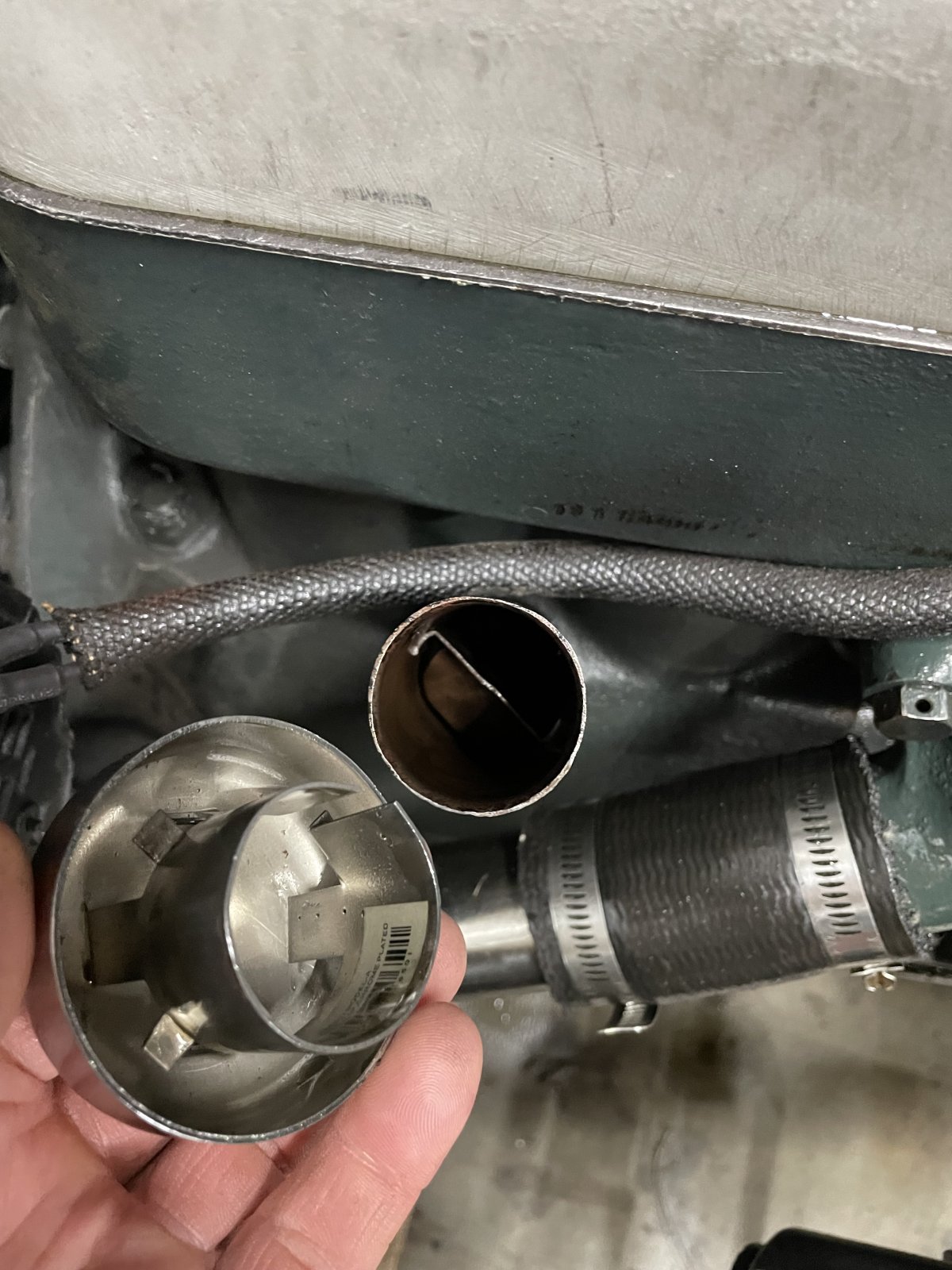

  5. DreamerJ
    Joined: Oct 3, 2021
    Posts: 134
    DreamerJ
  6. '29 Gizmo
    Joined: Nov 6, 2022
    Posts: 1,177
    '29 Gizmo
    from UK
    looks like it needs a gauze filter element in it like the later versions had.
  7. clem
    Joined: Dec 20, 2006
    Posts: 4,681
    clem
    I doubt that the cap is stock.
    The bar code almost suggests a reproduction one…….
    Yes, - a gauze of some description would help.

  17. Glenn Thoreson
    Joined: Aug 13, 2010
    Posts: 1,017
    Glenn Thoreson
    from SW Wyoming
    It looks to me like someone cut the tube down. The baffle should not be at the top of the tube. Try Berts in Denver for a used tube. A better cap would be a plus. The cap you show looks like the stock cap for a Model A. Put some steel wool in it but don't pack it tight. I definitely don't like the look of that tube and I think it's a big part of your problem.

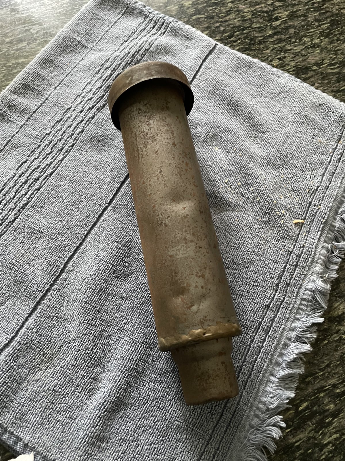

  21. DreamerJ
    Joined: Oct 3, 2021
    Posts: 134
    DreamerJ
    IMG_3896.jpeg Well, I metaphorically “stepped in “it” today”. Went to a friends house to rebuild a model a starter and he happens to have a unicorn in one of his many many many parts boxes. Like many of us, he doesn’t throw away anything so lucky me !!!
