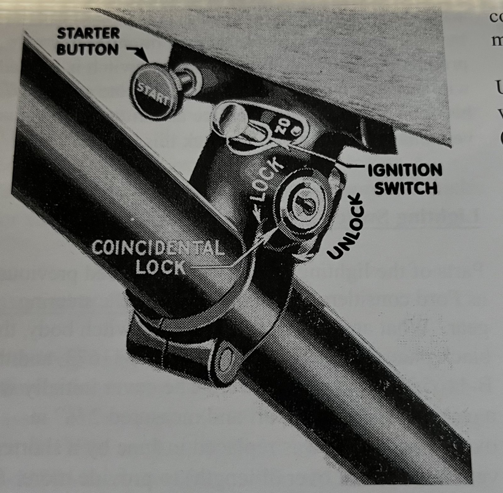

    What does the steering column lock actual lock? The steering wheel or the ignition toggle switch? 218456E2-5E81-4768-A06C-B821AC6F1E64.jpeg

    There is a Pin that drops into a groove /hole on steering shaft ,
    wheels /shaft in straight position.
    All so lock power On/Off switch..
    So it locks the shaft & switch

    If you turn the key to Lock , & steering not straight ( only one hole spot) it will still lock the On / Off switch , So if some one was to try to push & steer , when wheel straight then it will lock steering shaft ,
    I think in my roadster I have a 38-39 drop , it will lock the same .
